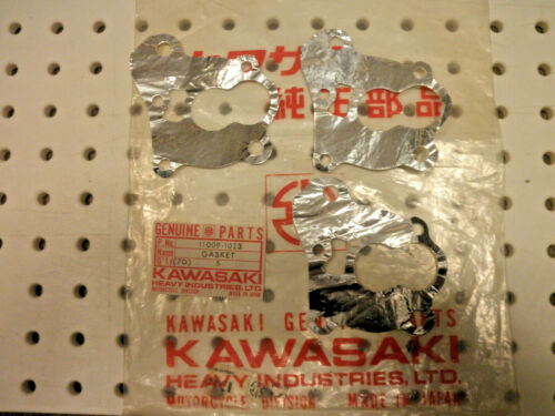

I use Rotilla also. I opened my pump in 2015 and sanded the side plate with 600 paper until all the marks were gone. There was a service bulletin about the gasket being too thick so I reused the old one. My oil pressure went up to 12lbs at idle and would break 20 at reves. One of our members pointed out some on eBay so I bought a few.
here's another one.
NOS Kawasaki #11009-1023. Oil Pump Gasket. KZ1000 A1. 11009-1023.
Im working up another pump and will install it soon.
here's another one.

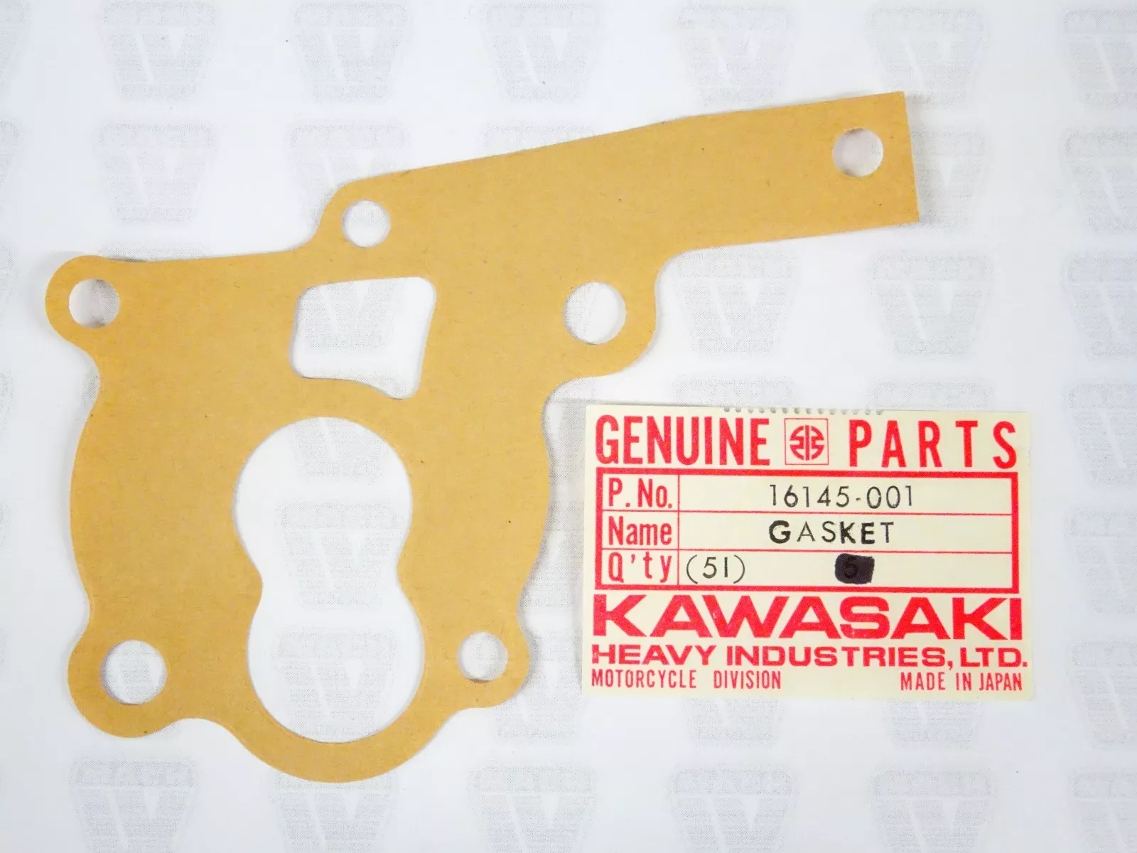

Parchment paper looks like the route I'll most likely use since you never know what you'll get when you place an order for a new gasket. When I looked into gaskets according to the service bulletin, the only part number that I could find to order was for the standard thickness. It seems that no one had ever heard of the thinner one, at least I could never find any listing of it online.
As far as going the RTV or 3Bond route, what is the torque spec for the oil pump cover plate? Did I miss that in the manual? I did notice that with a bit too much torque the gears would bind. BTW, this is an early style pump that uses a gasket like this:
