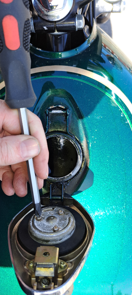

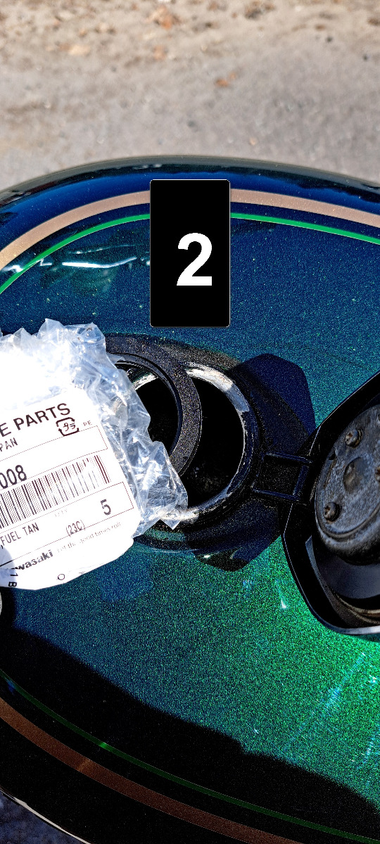

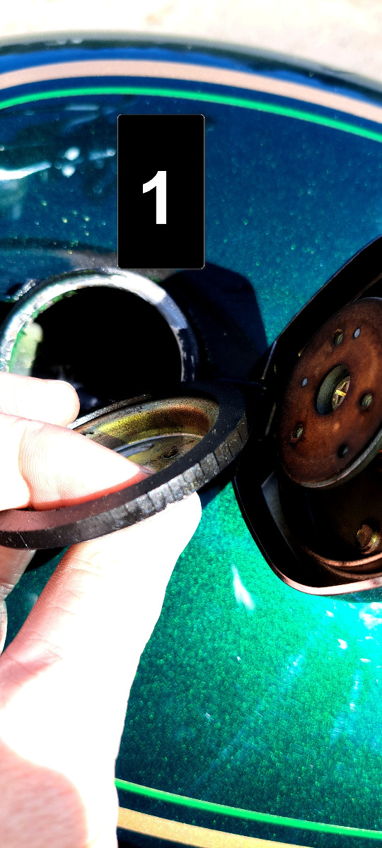

Btw any "life hack" on how to make fuel cap seal better?
A new and soft rubber gasket will give the fuel cap a tight fit and will seal the best!

I meant maybe something will fit from a newer stuff?
