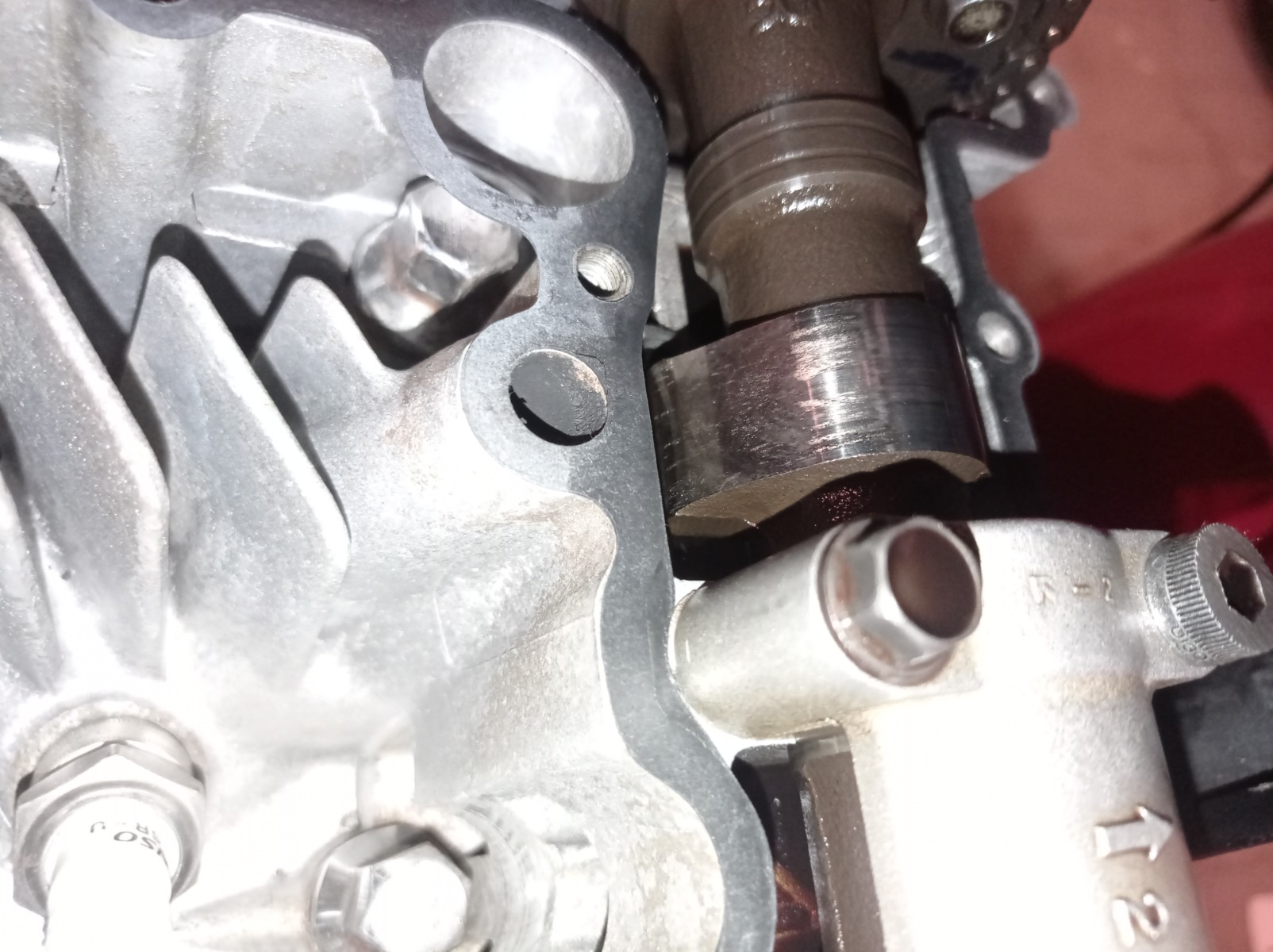

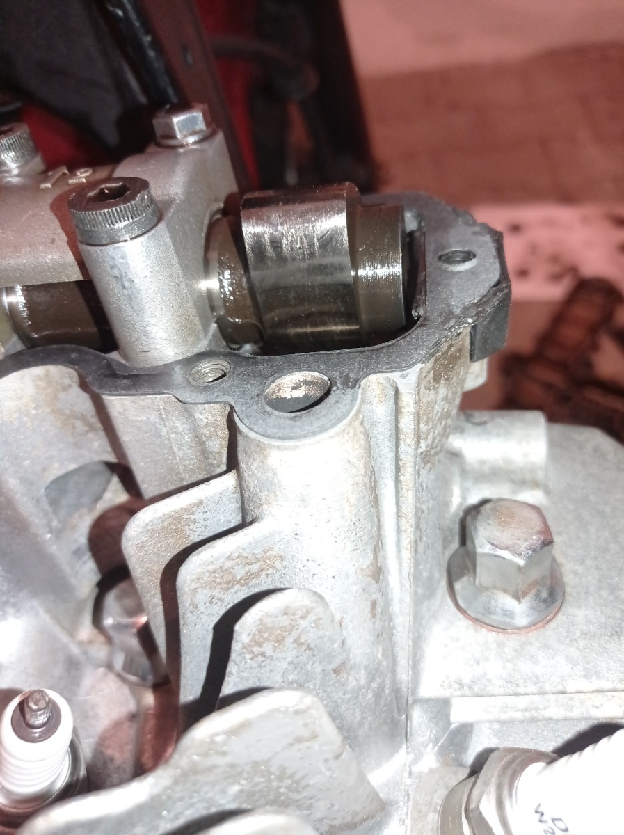

Hello everyone! Recently did a head rebuild on my '82 KZ1100. Went on a first ride and after it a few of cam lobes are a bit scratched. Definitely weren't any scratches you can feel with fingernail like those before. Found this accidentally,had to change one shim for a bit smaller one.
Anyone had similar situation?

I fixed your pictures (next time click "insert all" before posting) that looks like some sort of "debris" in the oil, the cam surface is hardened so not easy to gouge like that - was the head blast cleaned ? Possible blast medium not cleaned out ?

Shouldn't the pocket under the cam lobes be filled with oil?

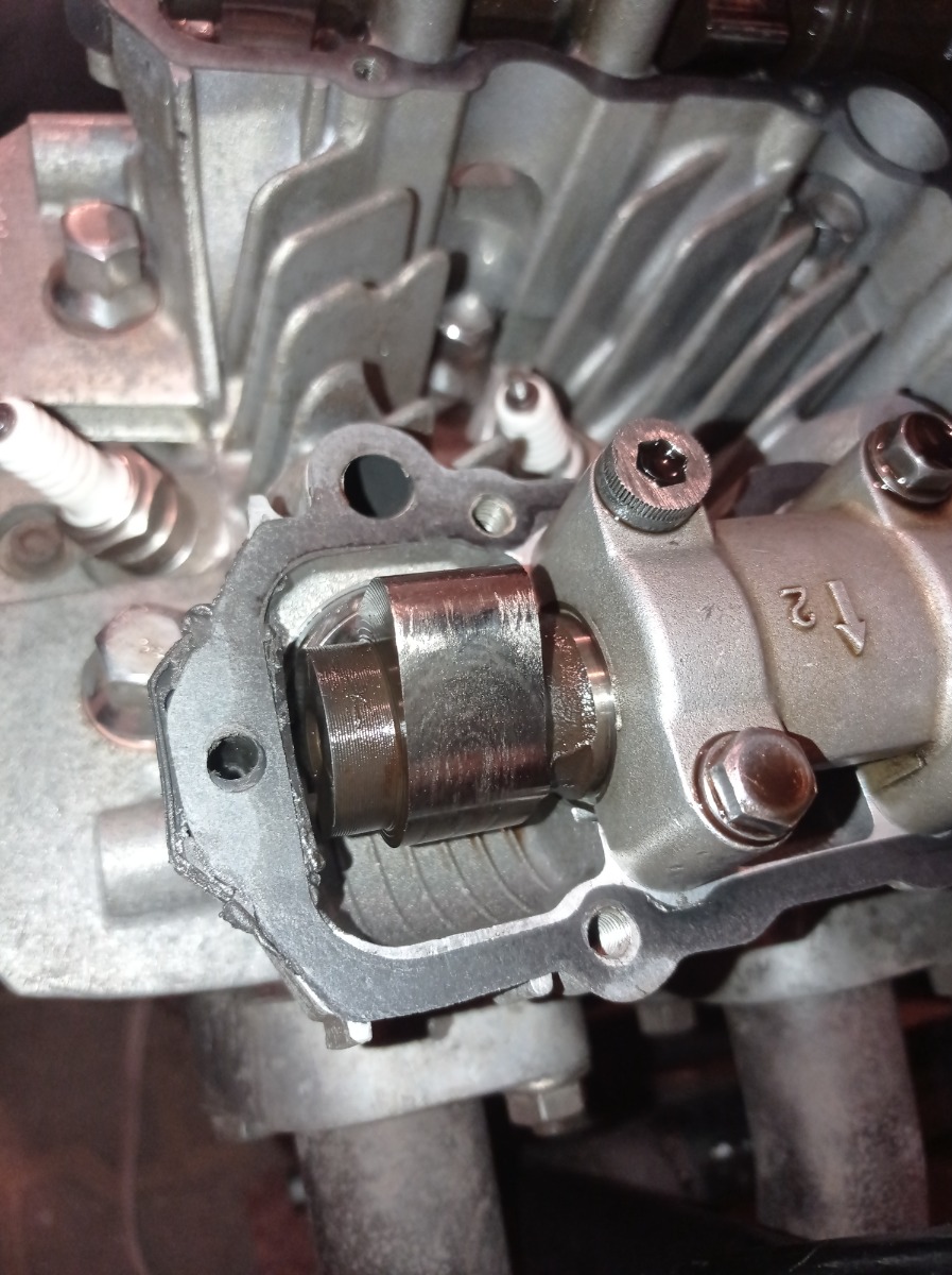

Thanks for pictures. As I know,it wasn't and I didn't notice any particles when installing it. The oil in the bike remains the same cos and I'm sure I didn't drop nothing hard in the cam chain tunnel in the process.

Referring to Nessism comment (can't quote for some reason), the bike was standing on the side stand for 5 days,there was some oil in the first cylinder "corner". I don't really know how much oil should be there, previous few times I was under the head cover,it looked about the same.

Did you use any assembly lube when putting everything back together?

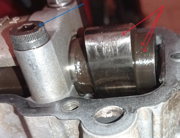

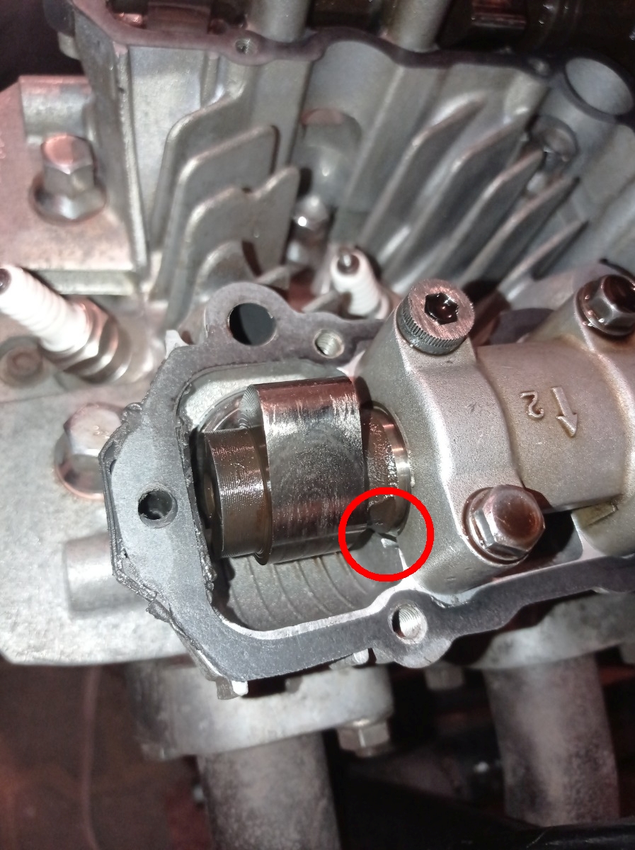

Three differend screws on the cam bearing cap and it looks like the lower cam bearing shell is missing ???

Was the Allen bolt on the cap ground down while it was installed on the cam cap? I agree grit contamination from some source.

Well, previous owners messed up original threads and rethreaded for bigger diameter. Cam bearing should be in it's place and it's kinda be seen on other photo.Three different screws on the cam bearing cap and it looks like the lower cam bearing shell is missing ???
Can you please explain that thing with Allen bolts? Don't understand what you meanWas the Allen bolt on the cap ground down while it was installed on the cam cap? I agree grit contamination from some source.

06 Jun 2024 04:58 - 06 Jun 2024 05:03The head of the allen bolt appears to have been ground down to clearance the cam cover - was it ground "away from the motor" or "in place" (grinding debris in motor)Just engine oil.Did you use any assembly lube when putting everything back together?Well, previous owners messed up original threads and rethreaded for bigger diameter. Cam bearing should be in it's place and it's kinda be seen on other photo.Three different screws on the cam bearing cap and it looks like the lower cam bearing shell is missing ???Can you please explain that thing with Allen bolts? Don't understand what you meanWas the Allen bolt on the cap ground down while it was installed on the cam cap? I agree grit contamination from some source.

Could the camshaft have been turned while there was no valve shim in the follower?
