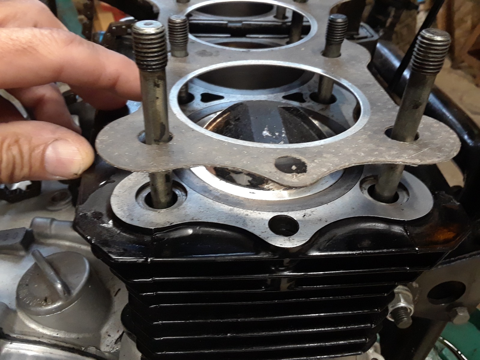

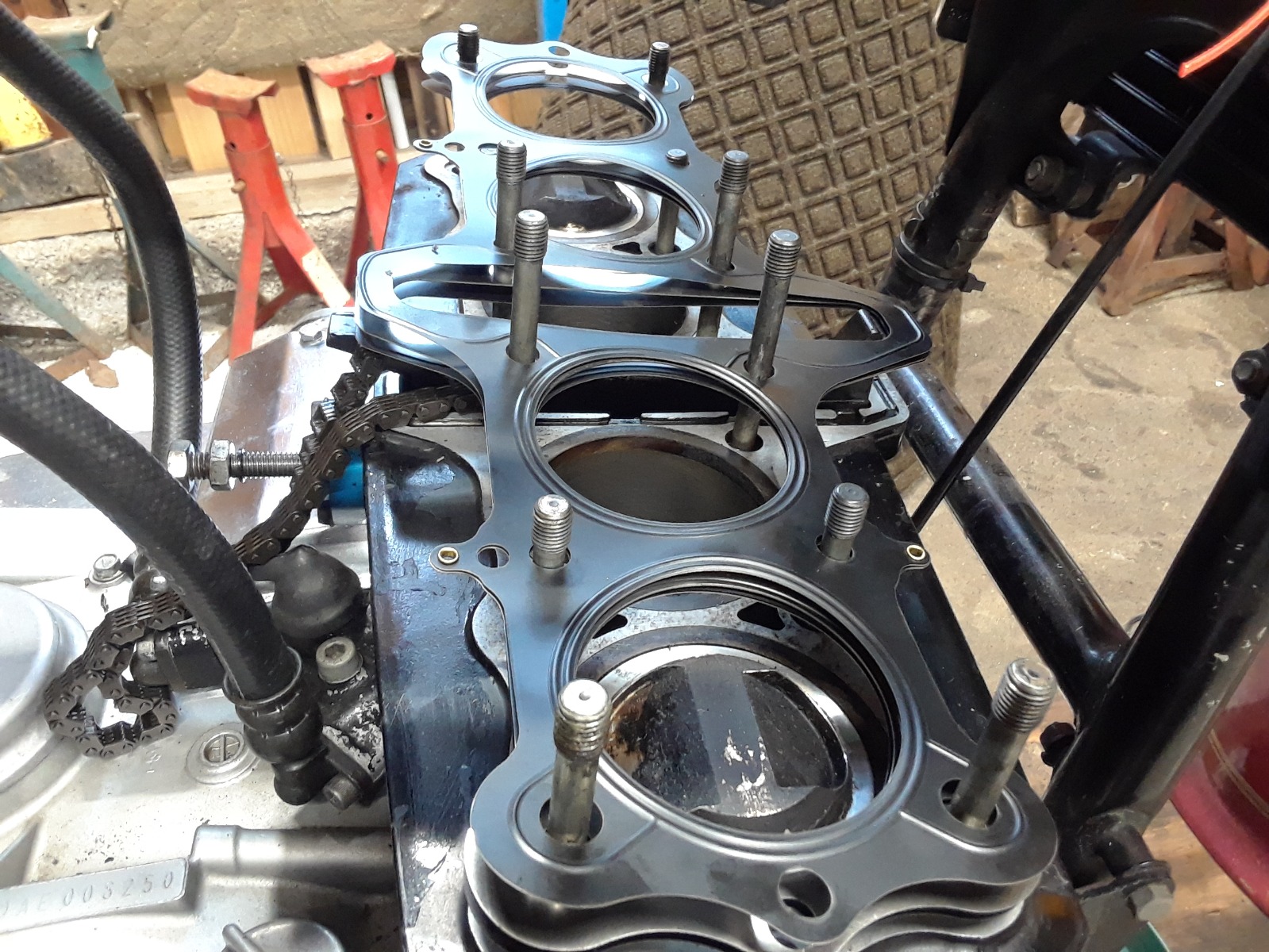

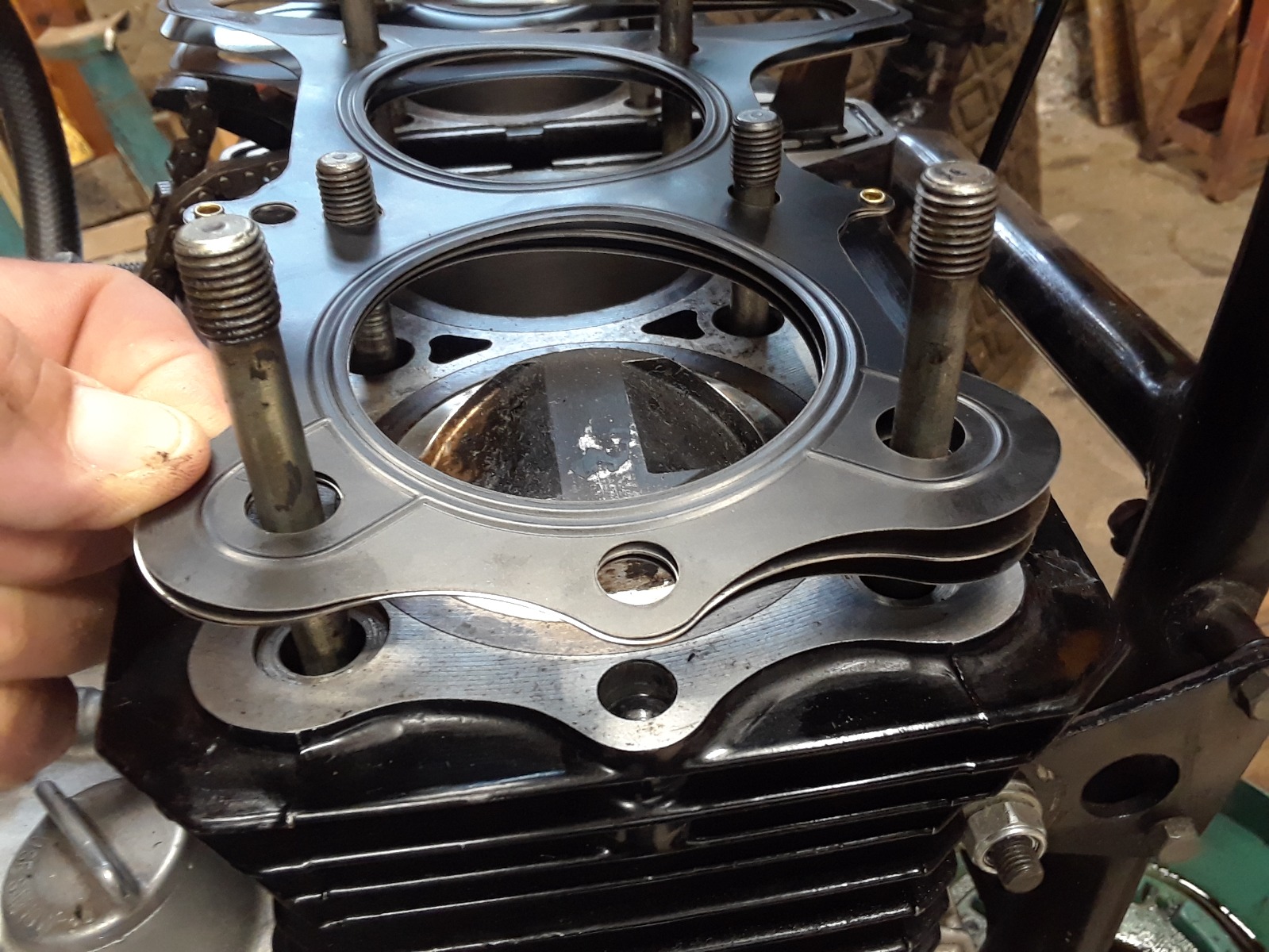

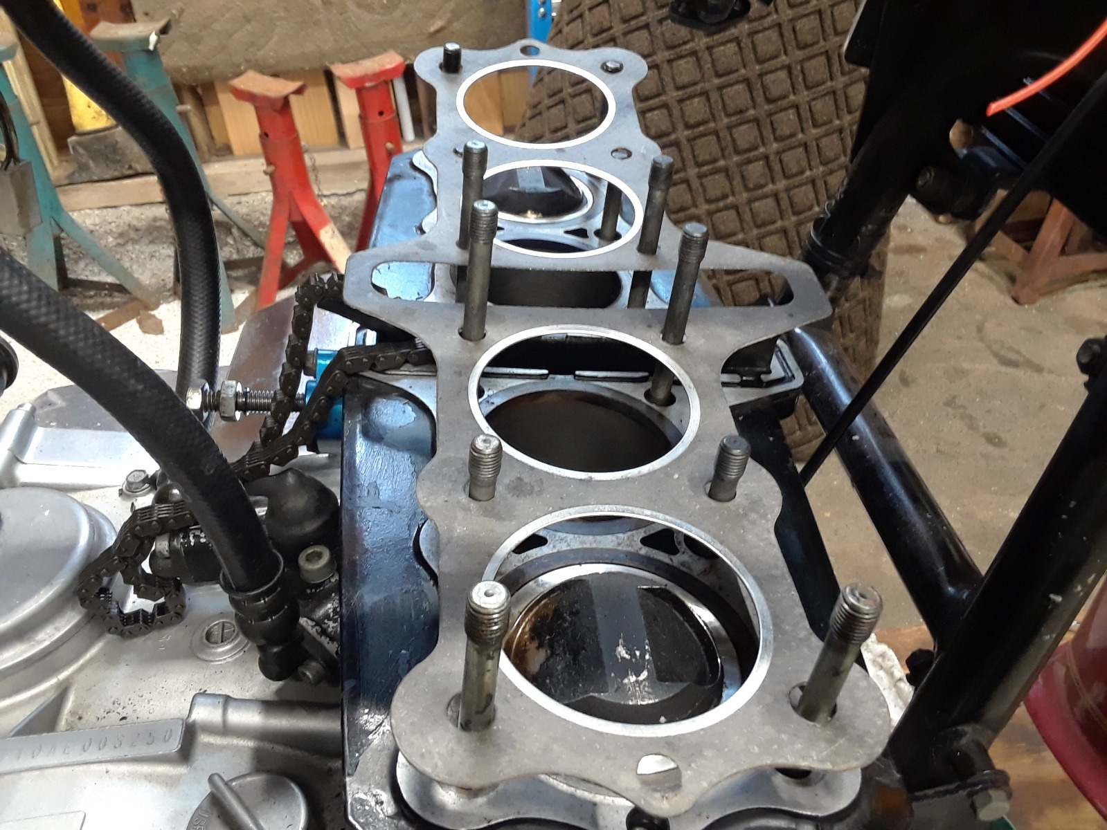

Best i can pics. With both gaskets, the corners are more covered and closed off than I believe the or 2 piece set would be necessitating the use of the o-rings.

Without hesitation I would use a 1-pc fiber head gasket with large oil passage stud and cam chain tunnel holes for the o-rings to pass through as originally intended.
IMO, the o-rings (OEM BTW) need to be sandwiched between metal head and cylinder block surfaces, independent of the gasket.
A Cometic 2-pc gasket set was used with the MTC 1135 kit I originally installed in 2019, and replaced with the reworked head in 2022. NOS Kawasaki o-rings were installed both times with no sealer.

Like Daveo says, if the gasket has large enough holes for the o rings to pass through then use them.If the holes are smaller than the O.D of the o rings then don't.The o rings are flattened too much with the wrong gasket and push in towards the studs, especially with thicker Ape studs.It'll cut off oil supply.Ask me how I know!

I suspect using the wrong gasket will make it weep oil.
