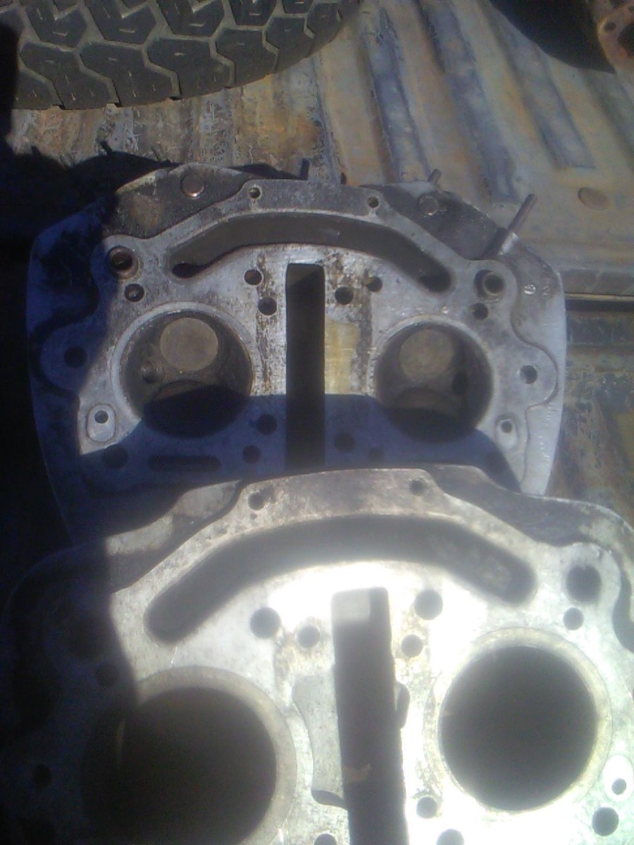

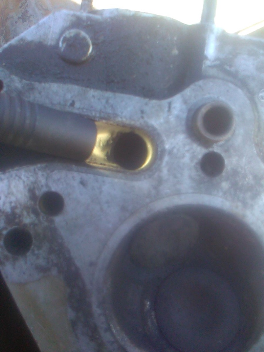

This what it looks like inside.

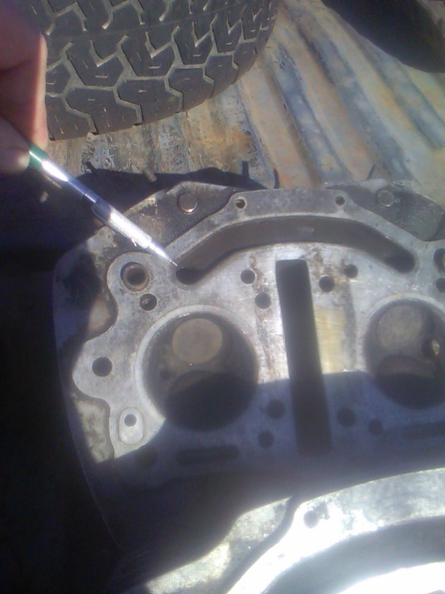

 These is the holes that gets threaded with a pipe tap.

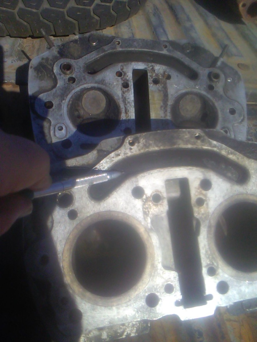

Drill 2 holes somewhere in the middle of this channel. This will allow it to 'breath' so as not to have similar problems in the future.

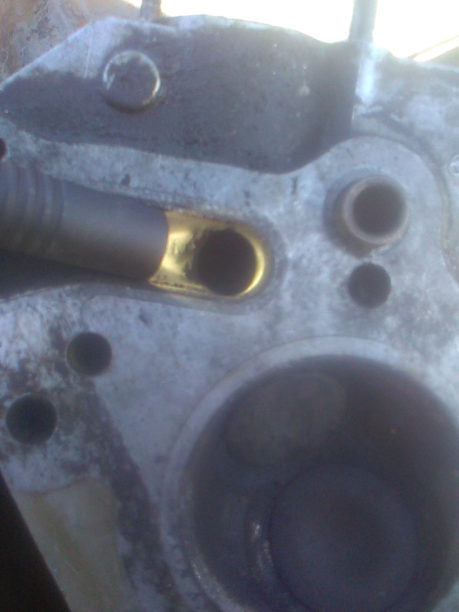

Another pic of the hole to be plugged

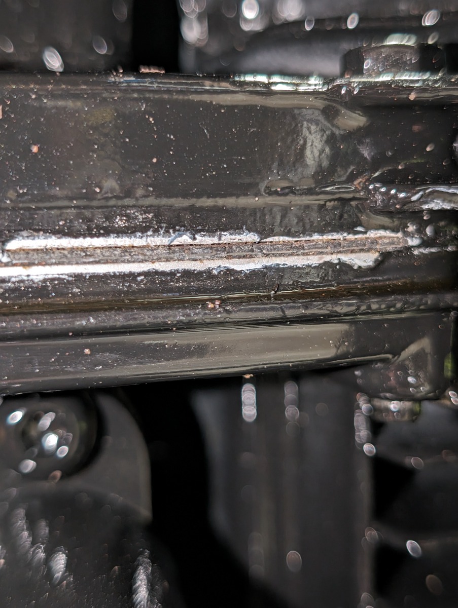

The head gasket is where the bubbly section of paint is.
I found the "Factory bulletin" for the leak issue on kz409.com, but it doesn't mention anything about capping the exhaust passthrough.
I ordered the head gaskets.
Once they arrive, I'll open the engine and hope it's only that.

Is your bike a 1976 with single exhaust?
2002 ZRX1200R
81 GPz1100
79 KZ1000st daily ride
79 KZ1000mk2 prodject
78 KZ650sr
78 KZ650b
81 KZ750e
80 KZ750ltd
77 KZ400/440 cafe project
76 KZ400/440 Fuel Injected
www.dotheton.com/forum/index.php?topic=39120.0
1970s KZ400. Which is the one to get? 02 Apr 2024 20:08 #897198
  • LuisLAN
  • LuisLAN's Avatar
  • Posts: 15
  • Thank you received: 1
Yes, It is 76 S. Both headers joint into 1 muffler.
"Drill 2 holes somewhere in the middle of this channel. This will allow it to 'breath' so as not to have similar problems in the future."
How big should those holes be?
1970s KZ400. Which is the one to get? 02 Apr 2024 22:16 #897204
  • Nebr_Rex
  • Nebr_Rex's Avatar
  • Posts: 1898
  • Thank you received: 299
1/4 in. should be big enough.
I suggest you get some dual exhaust. The factory single exhaust is what caused the crack you have.
It restricts flow and causes heat build up which leads to burnt gaskets and cracked castings.
Seen this on trucks and motorhomes including a pickup I have.
Hopefully what is cracked does not break off. If it does epoxy should fix it.
Completely disassemble the head when the threads are cut and then thoroughly clean it before reassembly.
Or you could end up like a member on here who didn't and blew up his engine.
