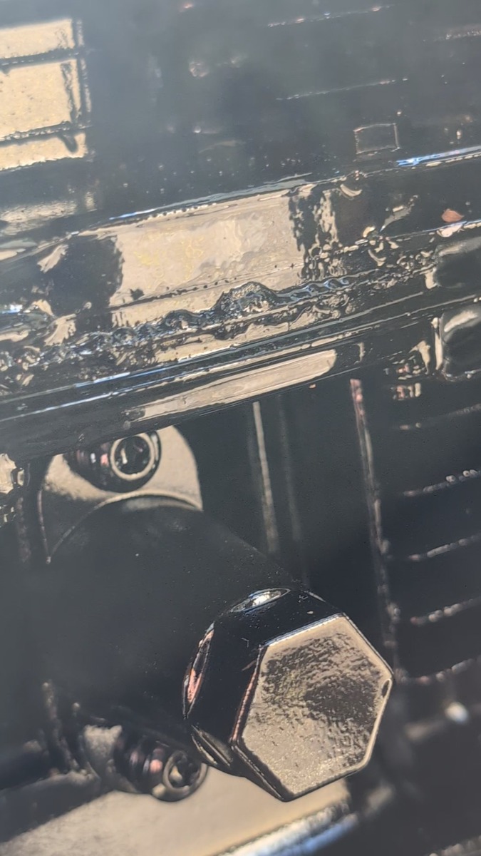

01 Apr 2024 12:13Is there an existing "how to" for this mod. I've been working on a 76 - 400s and took it on a 40+ miles for the first time. It worked great except for 2 issues; the first one is that there is a crack on the right engine case that is throwing oil all over the place, the second is the valve head gasket is leaking also.When they redesigned the engine in '78 the oil leak problem was eliminated.
The oil leak problem can be fixed. The early engine used an exhaust cross over in the engine instead of just in front of the mufflers.
The hot sooty exhaust would heat up this part of the engine a little more and separate the head gasket from the jug and head.
Think of water freezing and thawing in a rock formation or a paved roadway, same principle.
The cross over port is at the head gasket, one half in the head and the other in the cylinder jug.
To fix this the hole in each exhaust port needs to be tapped for a pipe plug. Installing these pipe plugs will seal off this cross over.
A couple of small holes will need to be drilled in the jug to relieve air pressure in the blocked off cross over.
I wonder if it's worth it to replace only the gasket or if I should try to remedy the underlying issue?
This is a repost of my previous entry (Now deleted). I failed to included the quote I was trying to reference.

Could you post some pics of your oil leak?
I'll get some to reference what what the problem is and how to fix it.

02 Apr 2024 11:15Thanks for taking the time to help with this." a job worth doing is worth doing right" Could you post some pics of your oil leak?I'll get some to reference what what the problem is and how to fix it.
Please see the attached picture, I hope it helps.
I have a video that shows "bubbling" but I can't upload it because of the format

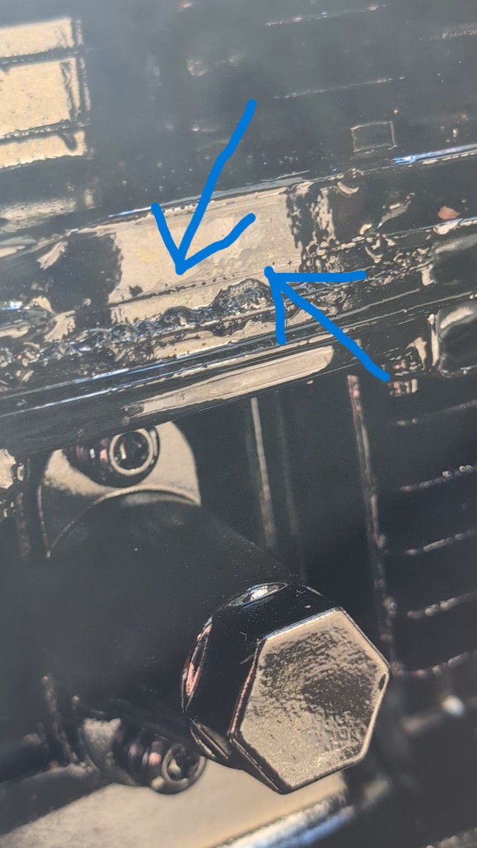

It looks an awful lot like someone sold you a pig. The photo appears to show that whatever gasket or sealant is there on the valve cover has been sprayed over, along with all the bolts as well.
You should remove the valve cover and take a look, and replace your cracked engine case. I think you may uncover many other faults as well.
On the plus side, these bikes are interesting. They will always give you some new and interesting issue to address every other week.

02 Apr 2024 17:48
This is where the head gasket is. Almost all of them leaked there. The factory had a fix for it back in the day.
