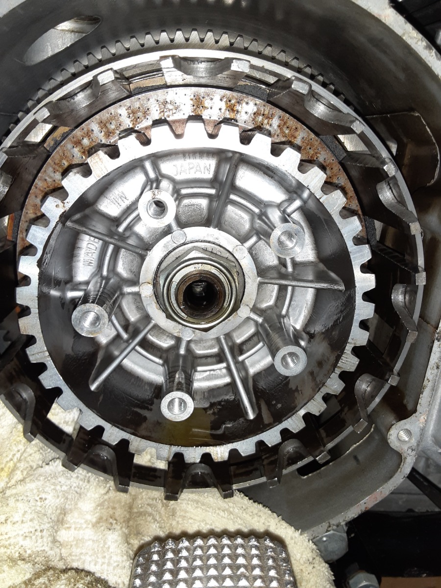

1974 Z1A, clutch handle almost impossible to pull. cable lubed, clutch release mech.,cleaned and greased. nice fluent motion all the way up to clutch pusher. pulled old steel and fiber plates out. with great difficulty, wedged against right side of clutch housing. installed new fiber plates, cleaned steel plates. difficulty installing fiber plates same side of housing. still extremely hard clutch pull. new stock springs also. could the housing be warped?

that's exactly what I was thinking, the clutch housing is steel, clutch hub aluminum. removing old plates and installing new ones, having the same resistance on the right side of the housing. almost like it's out of round. I wouldn't think the plates should be binding only in that area. I have replaced clutches on Hondas in the past and never had to fight to get plates out or install. thanks for your help.

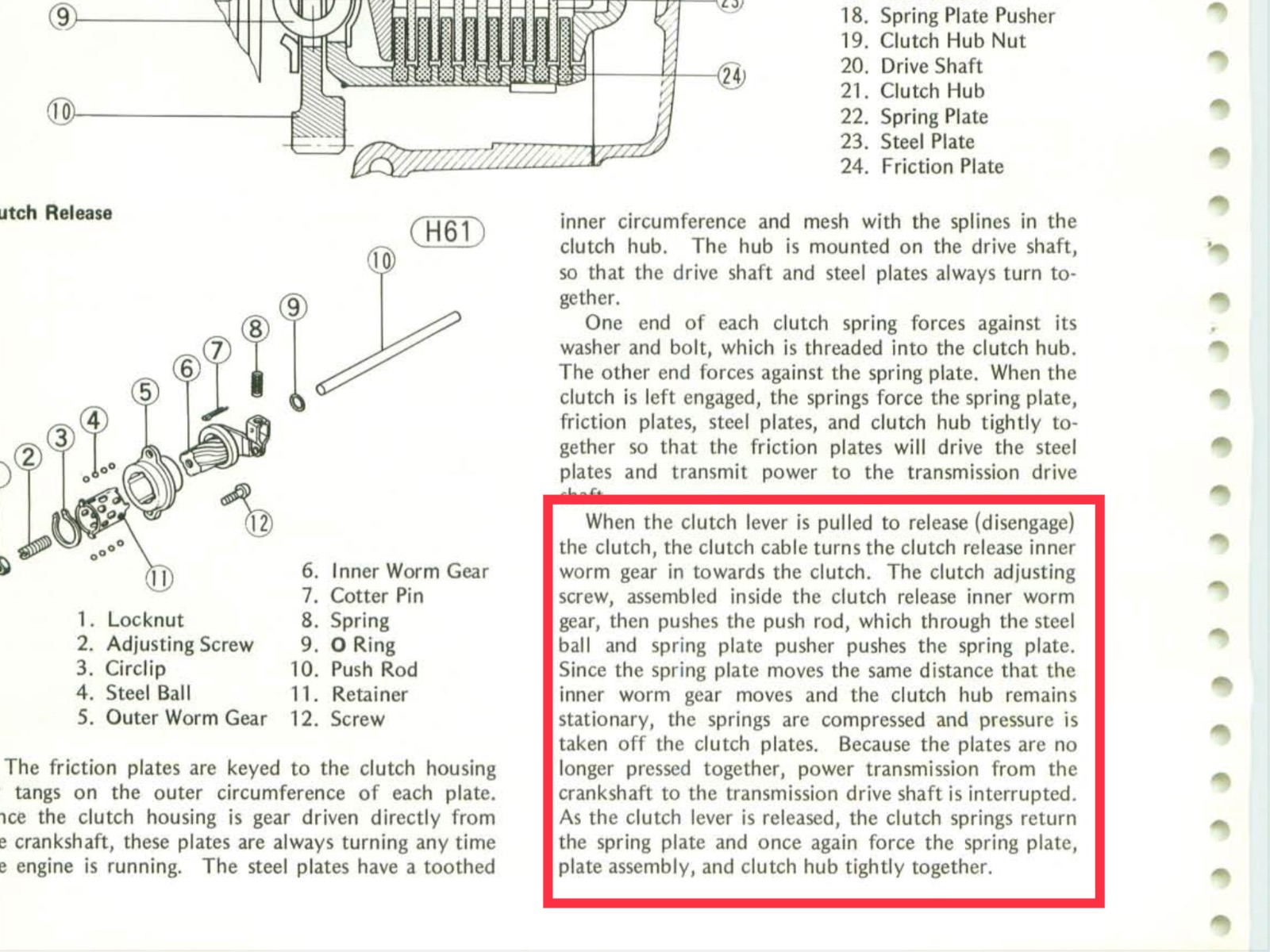

The steels and fibers have no affect on pressure felt at the lever. When you pull the lever your over coming spring pressure on the spring plate to push it away from the stack, thus allowing them to slip on each other. The only way the disc would come into play is if they were frozen up and sticking to the spring plate. So your looking for resistance in the clutch cable to inner sheath, the rotation of the clutch release, the push rod within the bore of the trans shaft, the movement of the pusher within its bore, the spring plate friction on the post and ultimately the clutch springs themselves.

I agree with all that has been suggested by others to this point. But if the push rod has been removed and the pressure plate and springs pulled as your pic shows and there is binding between the outer and inner clutch hubs I would think the outer hub should be pulled and the bushing and bearing on the outer hub needs to be looked at. I just can not get my head around a binding between the outer and inner hub when there is no pressure on it. It could also be the bearings on either end of the trans shaft the push rod runs through.
Not saying this is what is happening to you, but again I (as a old man) can not see how the binding will happen with out any pressure on them.. But then again what do I know?

20 Dec 2023 12:11
If that hub is bent the only thing you can do is check with a dial indicator positioned on the sides while still in the engine..
www.zoro.com/starrett-dial-test-indicato...AvD_BwE&gclsrc=aw.ds
rotate and check each arm, do the same on the inner hub.. you would need to split the cases to check the condition of that clutch hub bearing. You can remove the nut and pull the inner hub off and see if you have any play at the out hub.
