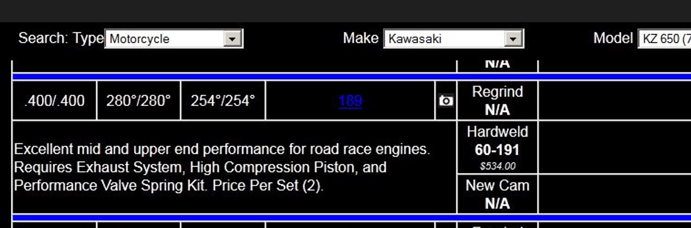

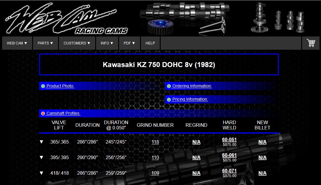

19 Dec 2023 03:02 - 19 Dec 2023 04:13WebCam grind #110 looks good :It’s for racing so I’m only looking for power over 7000 rpm. I have a Wiseco 810cc engine in the bike now with GPZ cams but I’m building a 750 engine out of old parts to ride in a 750cc class. I could take the GPZ cams from the 810 engine but it would be nice to have that engine as a “complete spare engine”. So I’m looking for real racing cams for the 750 engine.
It will have have around 11:1 compression, mild ported head, 4-1 exhaust and big carbs so i think i should use maybe a “medium” racing cam?
That is a typical road race cam with power coming on at 6-7K
You probably can't use stock pistons (valve pockets) but if its being built for 750 class limit you will need to run a +.50 mm over size piston to get max CC
Not sure what the rules are on carbs (round or flat slide) but you probably want to run a 33-34 mm throat
I am running similar cams in my 831cc street engine with a big valve 650 ported head and RS34 carbs
