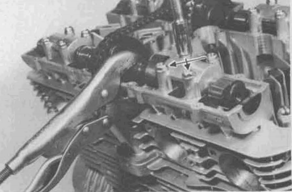

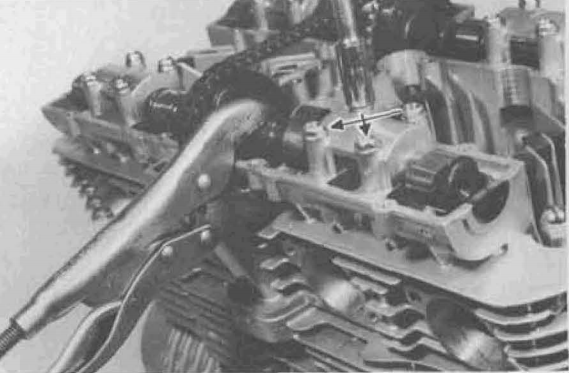

Suzuki recommends using vice grips to seat the cams into the head on GS bikes, before installing the caps. That way the cap threads are not responsible to compress the valve springs.

I think the stud idea is an ingenious method for eliminating stress on the aluminum threads. I would probably replace the studs with screws. I wish I was aware of that method before. I've been using ratcheting wood clamps with rubber pads to hold my cams in position while I remove the cam caps. Maybe I'll try pulling the cams down with the clamps when I'm ready to reinstall.
