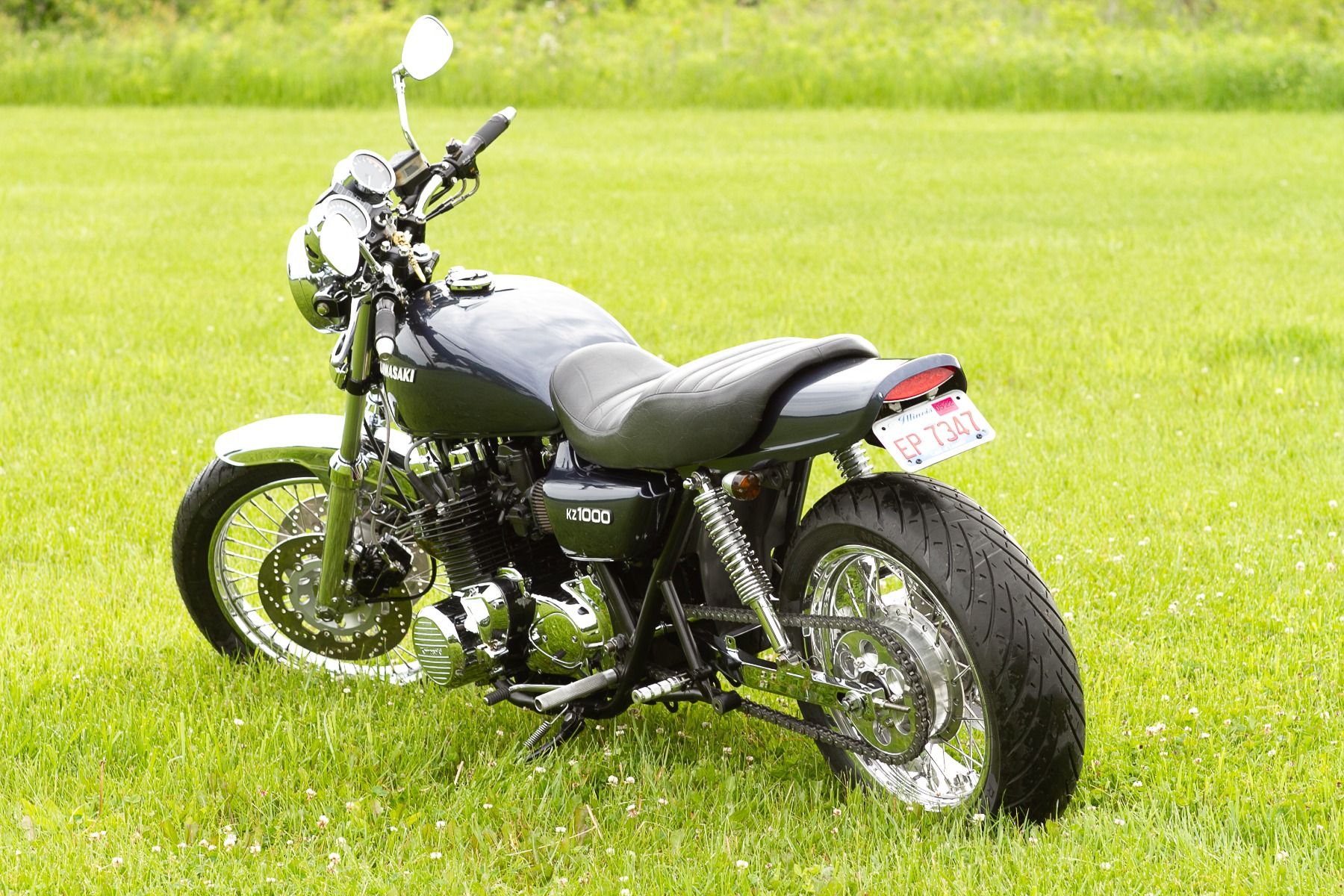

My setup is a 1976 KZ900 lower end. The crank was inspected and welded by Pearson Racing. 1105cc Wiseco pistons, DIY ported head, clearanced for the cams in question. Transmission gears are back-cut, oversized valves, intake 37.5 exhaust 31, shim on top, HD valve springs, Dyna-s ignition, 34mm Mikuni flat slides with K&N filters and a Vance and Hines sidewinder exhaust.
I've owned this bike 30+ years and this is my first attempt at a performance build. If anyone has any technical questions I will do my best to answer, but my knowledge is limited. I'm just not afraid to get in there and get my hands dirty.

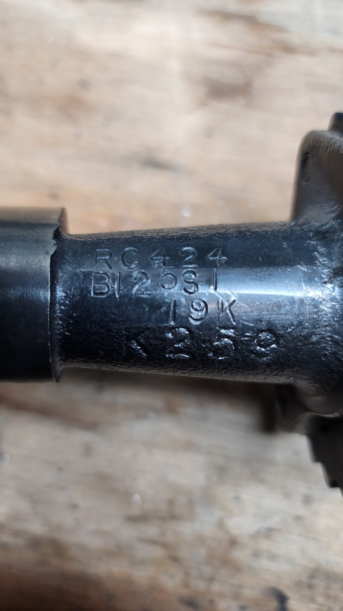

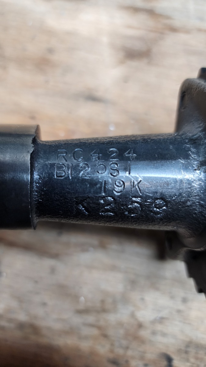

Measuring the RC424 cam with a digital caliper, I get a base circle of 1.1" and a .400" lift. No idea on duration.
Re: Specs/Info on RC424 Cams (Russ Collins)
09 Dec 2023 06:56That falls into Injected’s guidelines, saying exhaust is typically smaller when you’re running a split/staggered cam setup.Measuring the RC424 cam with a digital caliper, I get a base circle of 1.1" and a .400" lift. No idea on duration.

Looks like the RC424 was developed and marketed after 1981.
Like all other RC cams the duration is very exaggerated (advertised) "real" duration is probably around 270 degrees.
The best way to set those up is to make sure you have slotted cam sprockets installed and dial them in with a crank end degree wheel.
You will need to watch piston to valve clearance especially on the intake side.
Those will probably end up being a good combination with power coming on around 6K.
