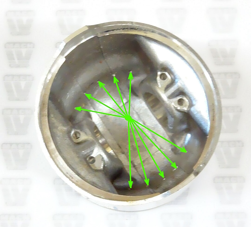

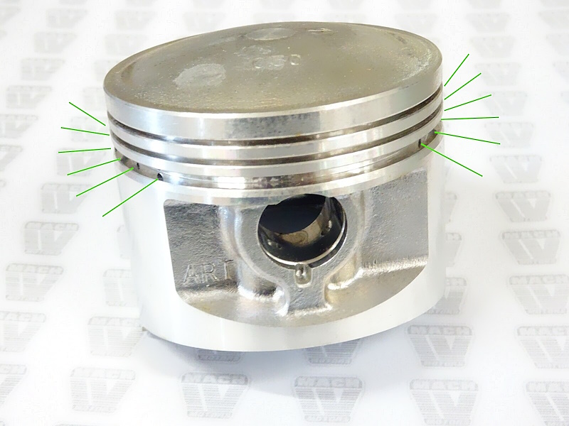

High oil consumtion can also be caused by blocked oil holes in piston grooves:
These tiny holes in the root of the oil control ring grooves are, most likely, partially blocked by carbon build-up...
H.
Those holes are there to allow oil to flow outward (onto the cylinder wall) AND inward back into the crank-case.
If blocked (even partially), the oil scraped off the cylinder wall (by the oil scraper rings) will have nowhere to go, and will move up onto the top of the piston (through the compression ring gaps) and be burned.
Also, accellerated cylinder wear may be evident, as lubrication of the cylinder walls will be deminished.
H.
H.
H.
