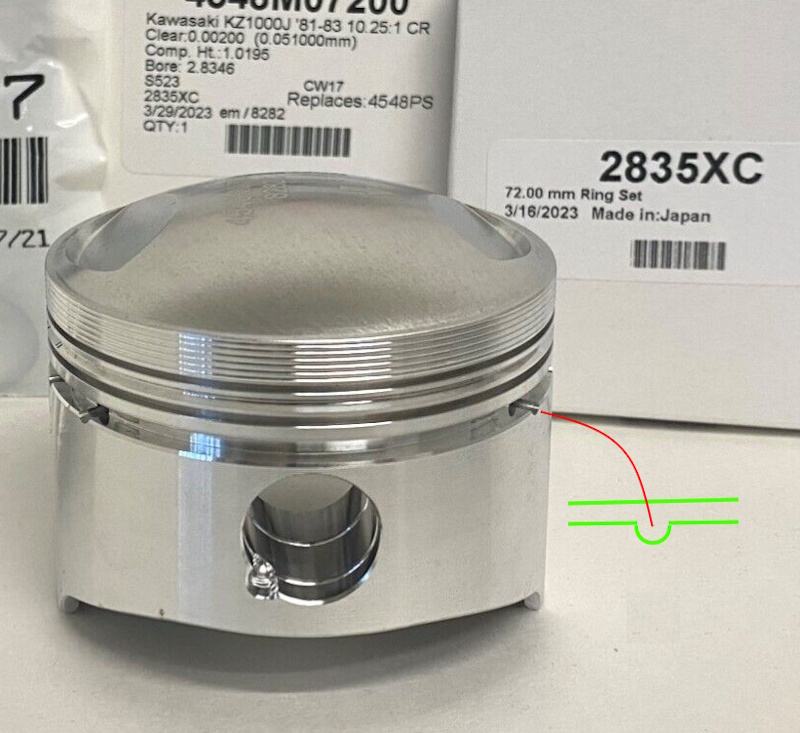

WISECO pistons have a better implimentation, in my opinion, of those oil holes !
Holes are much bigger (less likely to clog with carbon), and half (cross-section) of the oil holes are ALWAYS exposed and are not totally obscured by the piston ring... clever !
I think this design improves cylinder lubrication as well !

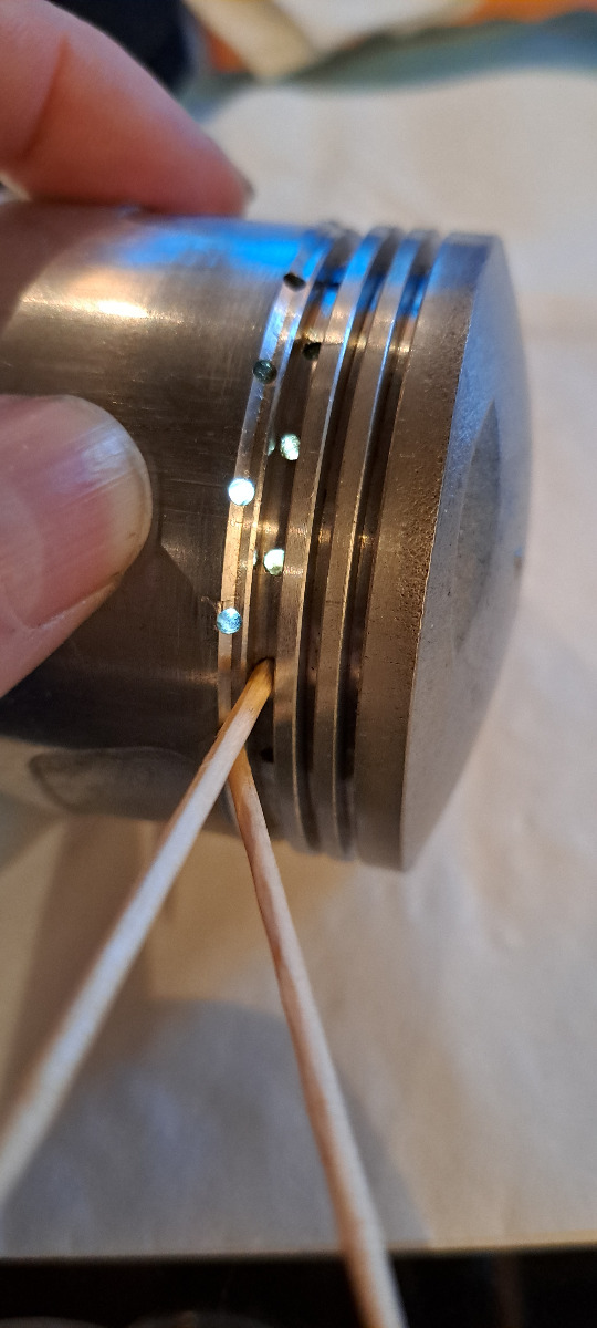

BTW, I'm not a professional mechanic. Just self taught, out of financal, need to fix my own stuff. So there are holes in my knowlage. (like the holes in the piston groves.) The Kawasaki service manual said to clean the carbon out of the groves but made no metion of the fact there were holes that needed to be cleaned.
