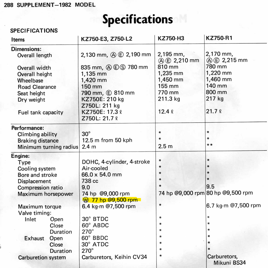

I found this interesting. The L2 uses the same engine and carbs as the E/H models, but makes 3 more HP (in West Germany, anyway.)
Could the exhaust account for this difference?

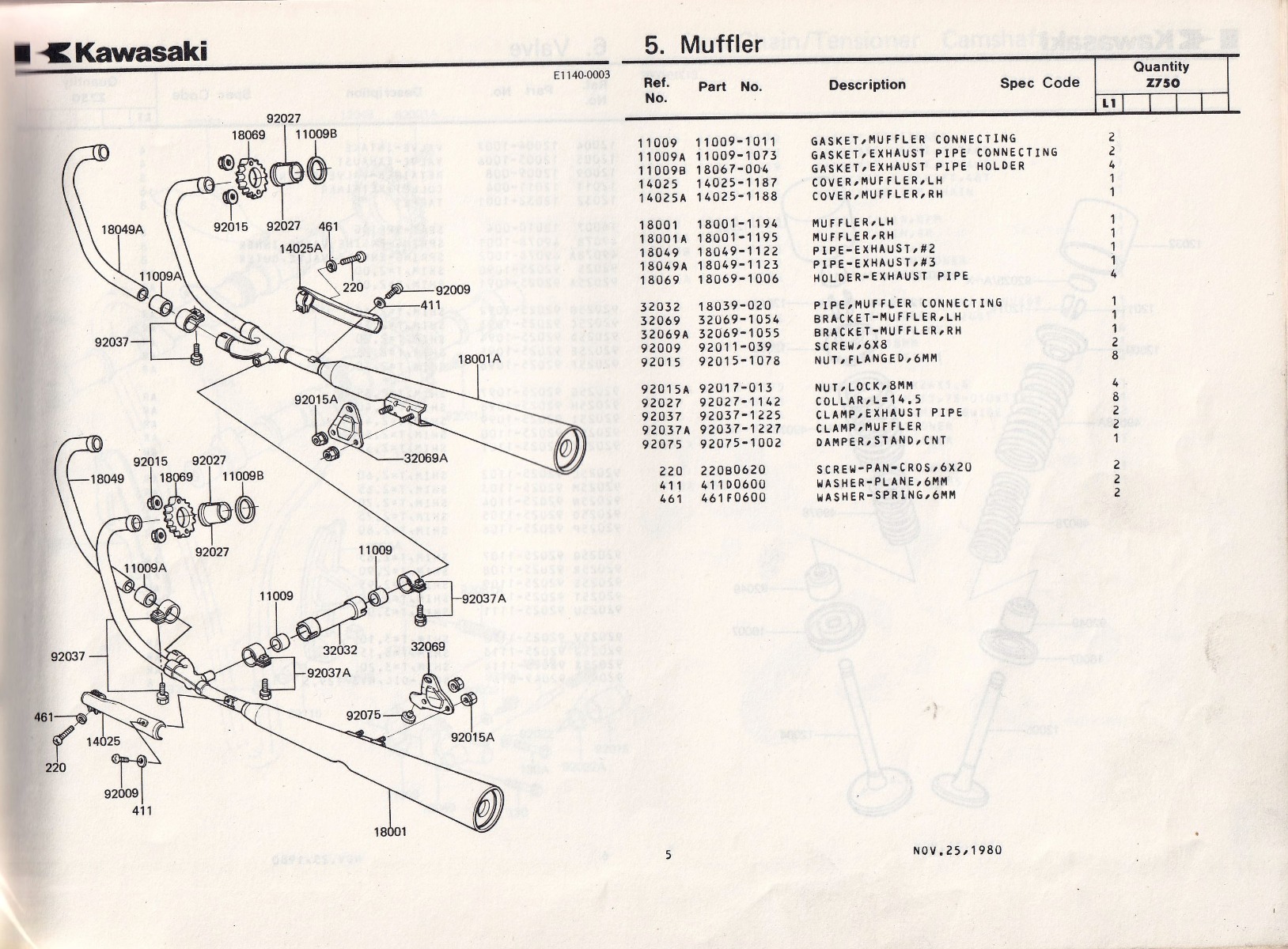

Re: Help needed with Pipe Exhaust for Z750 L2
05 Oct 2023 16:40 - 05 Oct 2023 16:43So a scan from the parts book, European market, Nov 1981 L1 manual. Hope it helps the general picture.I have made the same research. I will wait an owner to post his L2 manual!
