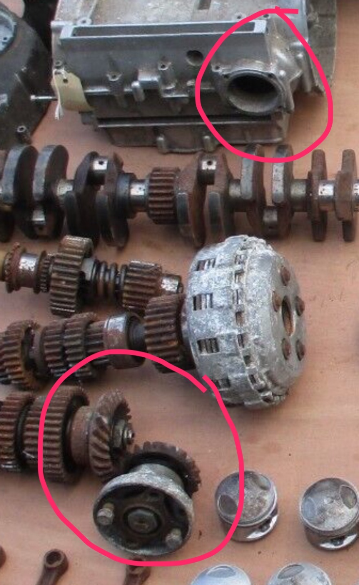

08 Sep 2023 17:23 - 08 Sep 2023 17:25And here lies the biggest challenge which is why there aren't too many chain Drive 1300's out there. Regardless of whether you go left or right you will need a bevel gear set up and jack shaft at the back of the motor. On the 1300 the final drive bevel is part of the cluster inside the main casing and the output shaft doesn't exit the main casings so there is nothing to attach a sprocket toI agree with TexasKZ. If you convert to chain on the right side, you can probably avoid having to re-engineer the rear brake setup and leave it where it is. Scotty

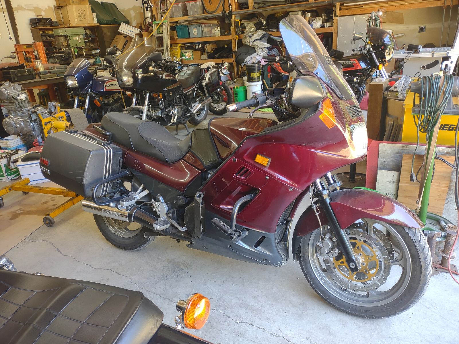

Thanks for all your input I have found USD front suspension that will fit, swingarm and wheels, back tyre just need to find front tyre to match. I have a few ideas about the chain drive its the weight I'm trying to reduce, back end and wheels they are just to heavy. The whole bike is heavy needs to go on a diet.
