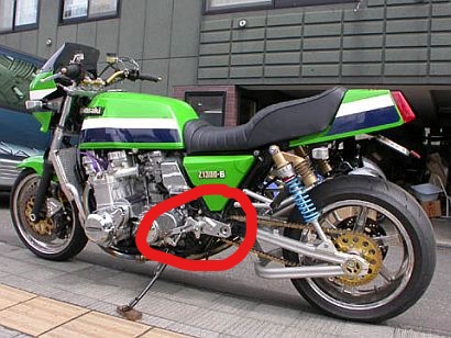

I love to take on a challenge and find solutions but I think (unless you have significant engineering skills and budget) this might be a little too far !! Firstly the "power output" is on the right hand side significantly limiting choice of donor parts. Below is one that has been done but this has custom engineered "external" transfer box that I guess contains a set of bevel gears driving the remote sprocket. It's nicely done but must add a chunk of weight to an already heavy bike and unless he has found some way to lubricate the transfer gears will be more of a "show piece" than a usable bike

I guess I did not look at the bike close enough to notice the drive shaft was on the right hand side!
Jack shaft output to the left side really complicates that situation. When you get into extra drives like that they typically rob some HP which kind of defeats the purpose of using a chain.

They do have a cool engine design but they were never meant to be a sport bike. That picture posted seems to indicate a performance bike (Lawson Replica?) It was always mean to be a sport touring bike but the sheer weigh held it back from mass appeal.
