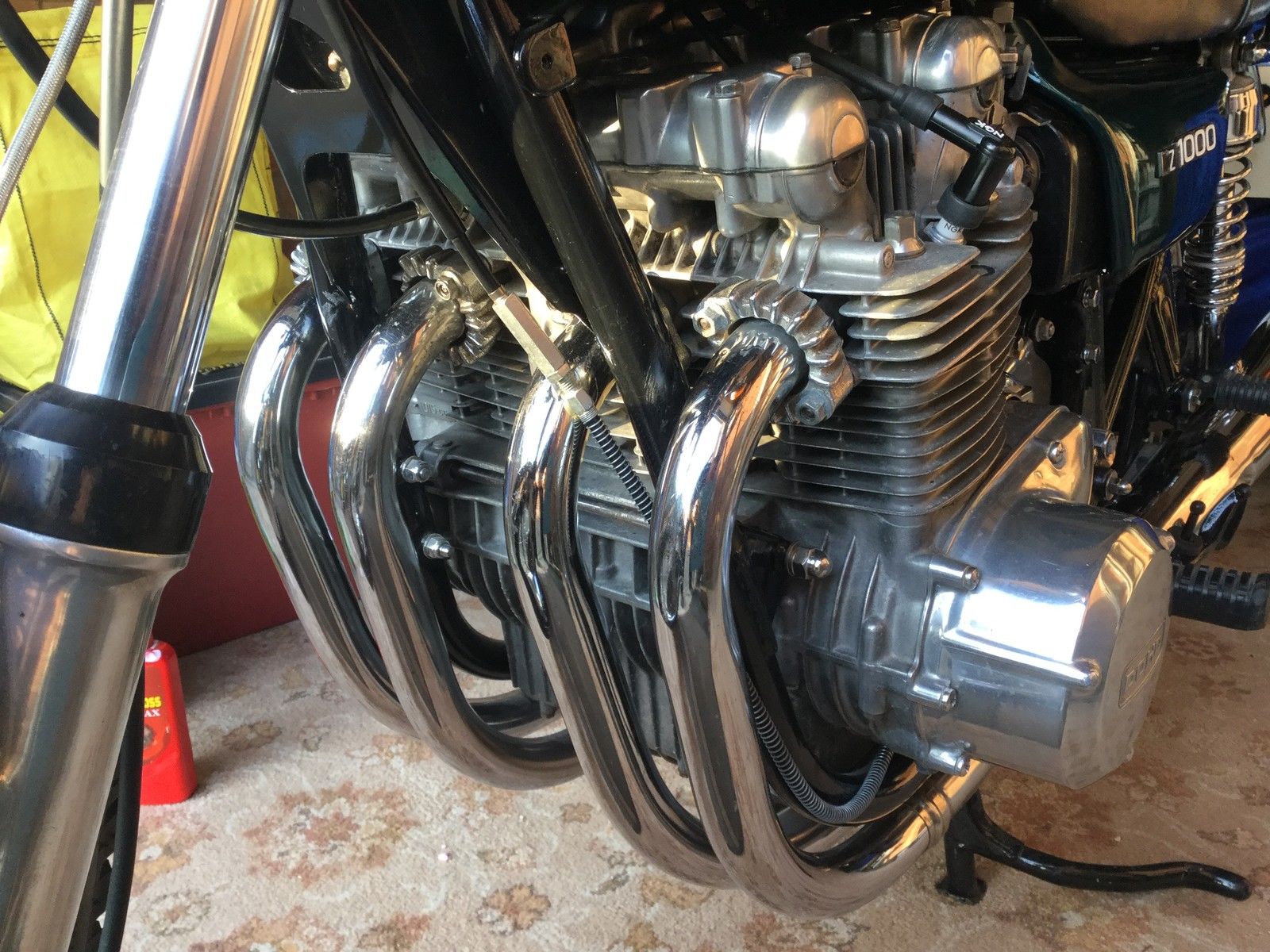

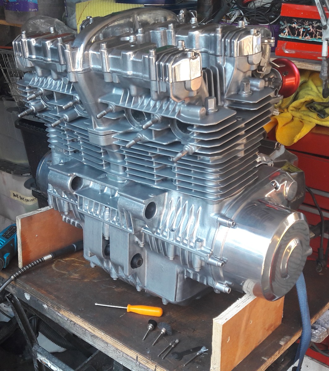

Started restoring a1977 kz1000 A1. Did some come with black motors this one is black but it was definitely painted would like to get it close to original  see some black and some not in pictures I assume they came  unpainted

A1 all had bare metal finish.
Mine.
