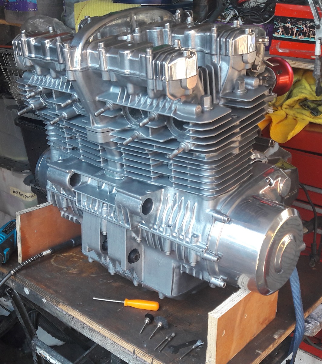

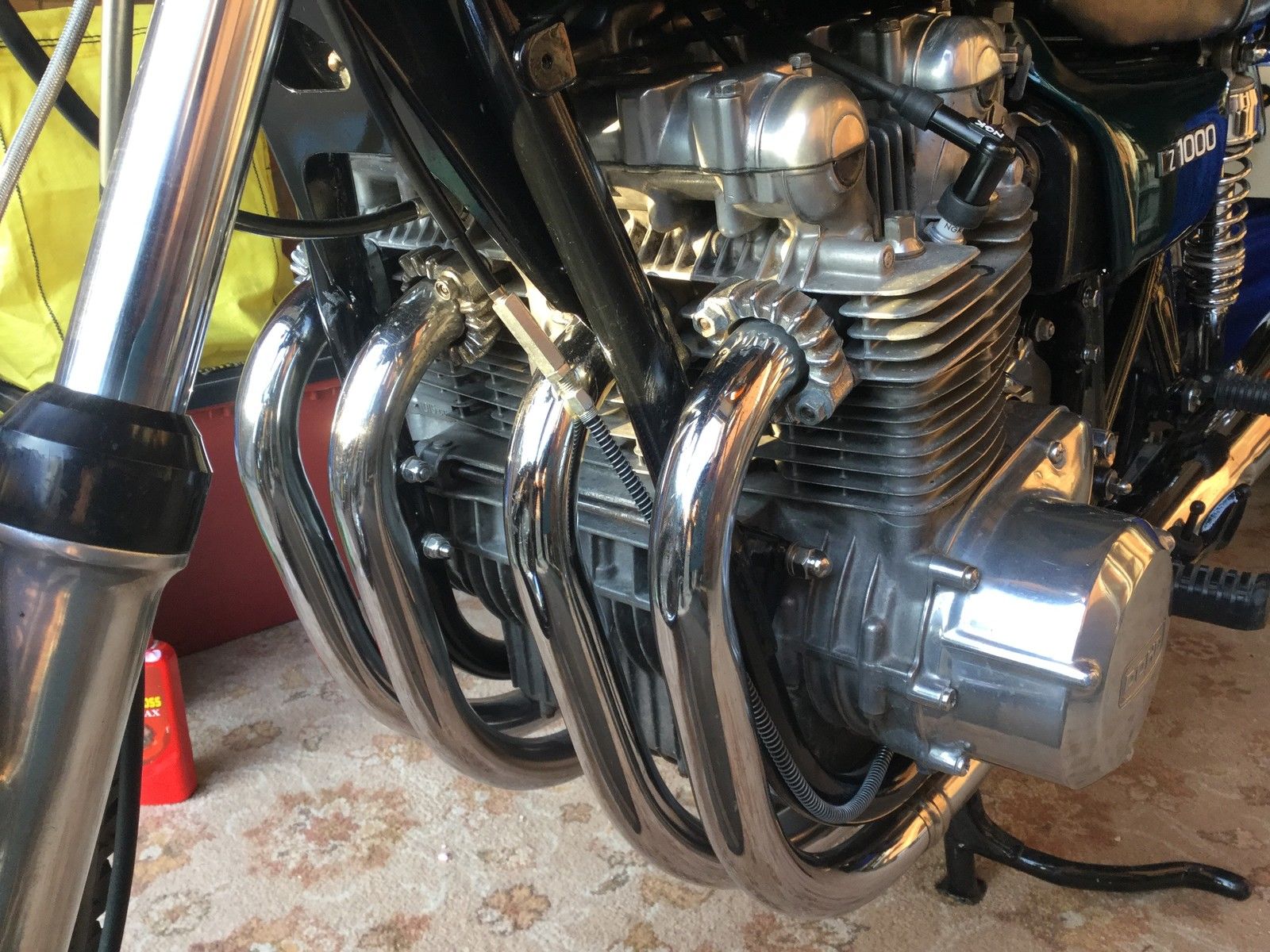

Started restoring a1977 kz1000 A1. Did some come with black motors this one is black but it was definitely painted would like to get it close to original  see some black and some not in pictures I assume they came  unpainted

A1 all had bare metal finish.
Mine.

Bare aluminum.  No paint on the A1's.

Does anyone know of anything that will bring back the shine in the aluminum  after bead blasting  I have read about some stuff that is sprayed on and rinsed off sounds to good to be true  or shoul i use other kind of media for blasting  using glass bead now

Silver leaf rub n buff is what you need. It's actually manufactured for the restoration of silver art works etc. It's a small tube of paste and at £10 a tube not cheap but one tube will do about 4 or 5 bike engines.
Very sparingly brush it on with a old tooth brush then buff it up with a microfiber. More you buff more it shines.

Warren, what bike used that “J” cam cover without the clean air system. I really like that.

Euro z1000 J2. (although its got b1 1100 top half). Blame global warming on us, we don't do clean air.

Looks great  I'll give it try
