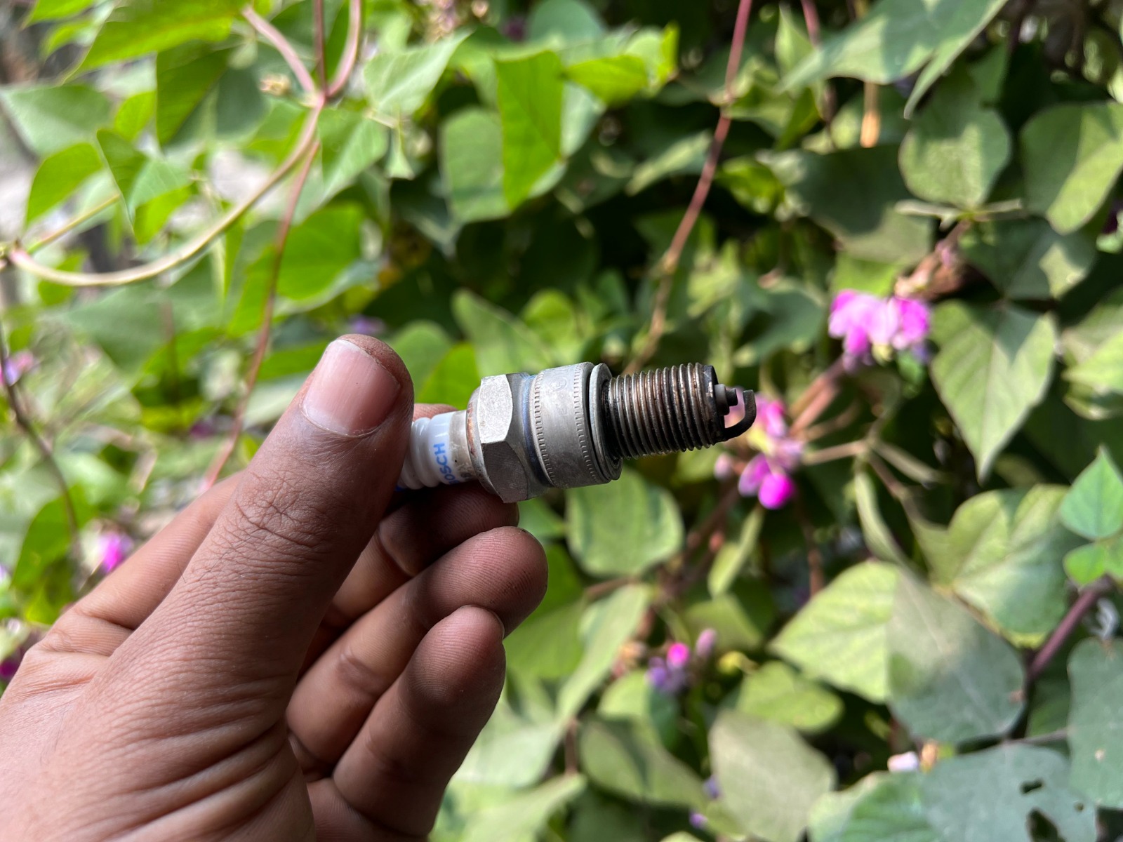

Hey all,
So i'm seeing some unusual oil fouling on the #4 plug on my GPz1100 . About 7500 miles ago I had to have the head's valve guides replaced from a siezed exhaust valve guide. While the engine was disassembled I honed the cylinder and replaced the piston rings. The engine has about 14K total mi currently. This engine has always burned some oil, but never a smoker. I'm suspecting a bad intake valve seal as when the valve is open, I can actually see a lot of oily crud on the backside of the valve face when looking down into the cylinder. My question is has anyone sucessfully changed out a valve seal not having to remove the cylinder head ?

It indicates oil leakage to the combustion chamber. The main reason is bad piston rings or excess engine oil. Please replace the piston rings and see whether the problem is fixed or not.

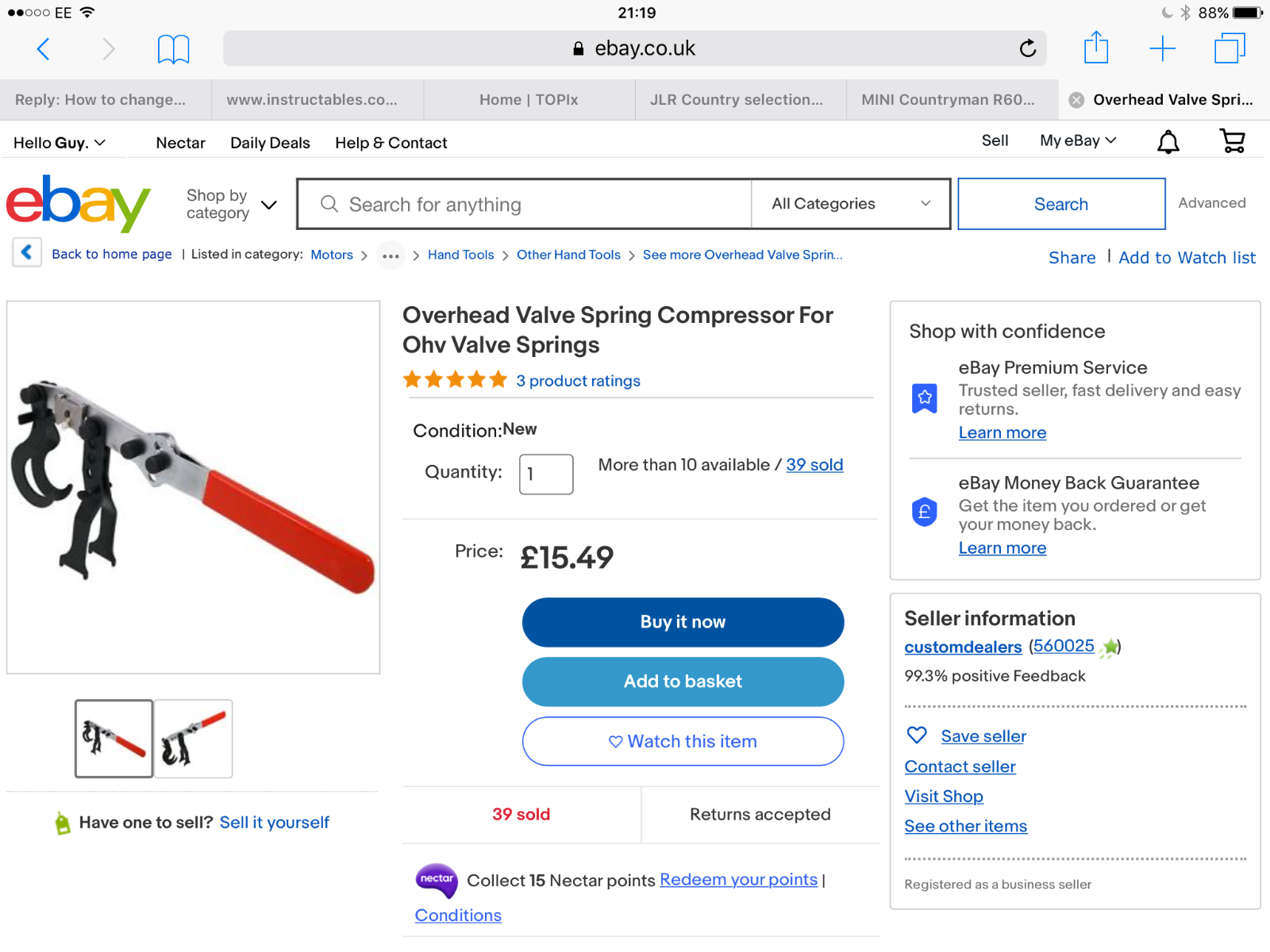

Somewhere back in a cobweb infested corner of my memory, I seem to recall a home made rig that used a plate bolted down to the cam cap bolt holes as a fulcrum and a lever with a tube that has a cut away, similar to a regular spring compressor, welded to the lever. The short end of the lever went under the fulcrum plate and the cut away allowed removal of the keepers.

26 May 2023 00:12

Could possibly use the other camshaft to hook on.
