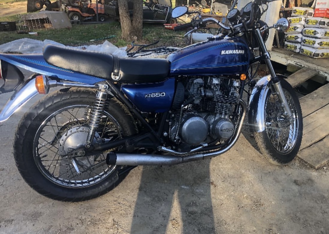

Bit of a random question but what colour is your 650? ( is it green by any chance?) do you have pics?

21 May 2023 12:21Bit of a random question but what colour is your 650? ( is it green by any chance?) do you have pics?
Its a 1978 and its blue. For some reason, this site wont let me post pics. It says "you do not have permissions to view this page."

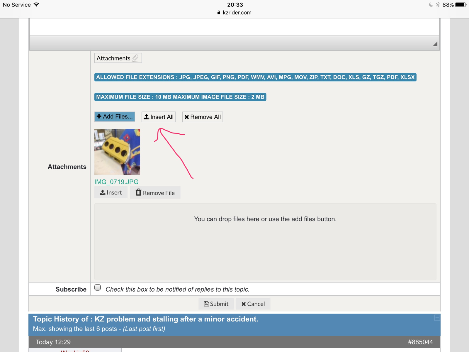

How are you trying to attach the pics ?

I got into attachments. Im going to try it now and see if it works. If is does i guess it will show below. this is a pic of it when i first got it. I added engine guards about 6month later. they were kinda hard to find.

Looks a pretty solid bike, when you have attached your picture click "insert all" for it to show full size (wait for the green text to appear) I have fixed this one
