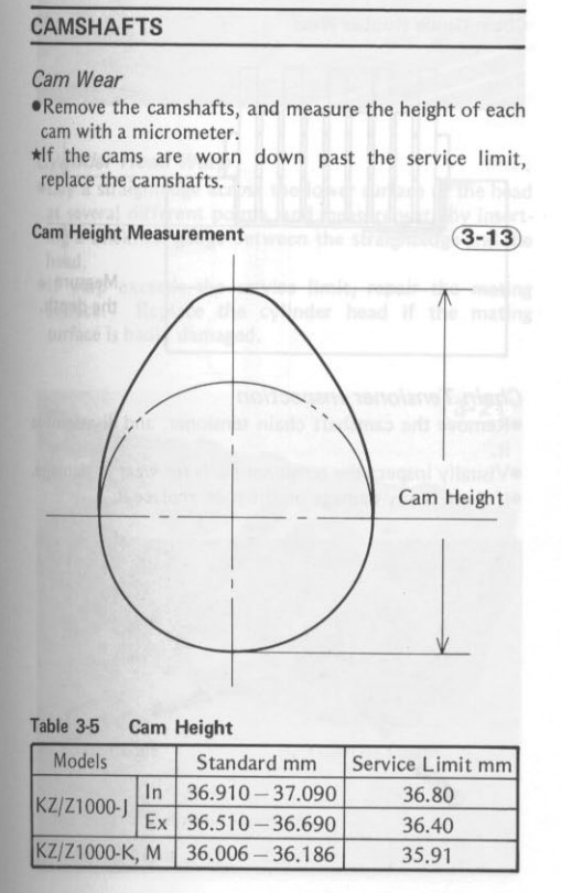

Here is a pdf copy of the factory service manual.
www.kzrider.com/modules/ServiceManuals/K...Service%20Manual.pdf
The following user(s) said Thank You: howardhb, timewaster

I found the owners manual, and the Kawasaki wear spec and the Clymer wear spec differed by .001. I need new cams. Got any ideas on that? Only ones I can find are on Ebay, or aftermarket performance pieces for several hundred dollars. Kind of gun shy about buying used off Ebay, as they may be worse than mine. I contacted a couple of sellers to ask if they would measure them, but got no reply.

I don't have a mic. that large, but I have calipers. The minimum for intake was 1.449" (36.804 mm.). I measured 1.415" ( 35.941 mm) to 1.425" (36.195mm.) on the intake.
I measured 1.430"(36.322mm.) to 1.428" (36.271 mm.) on the exhaust. The manual says 1.443" (36.652mm.)
The exhaust isn't as bad as the intake, but still below the stated minimum.
