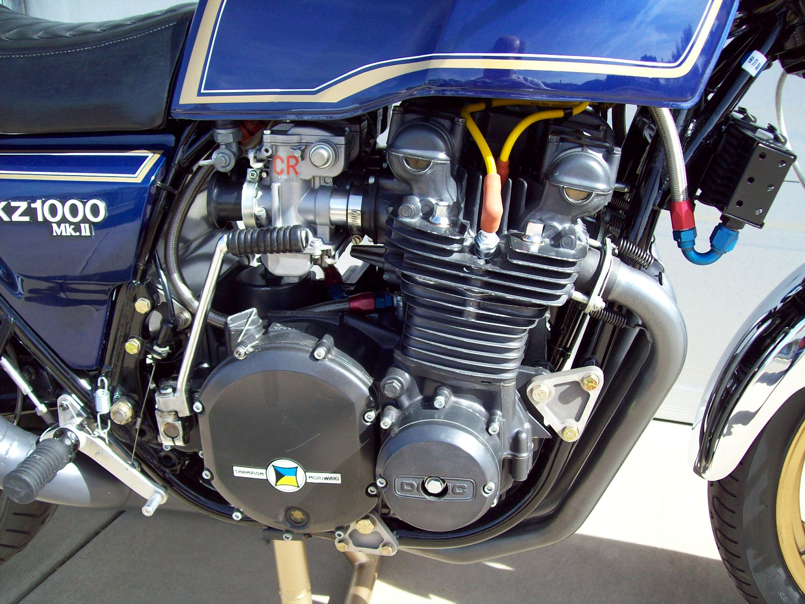

Never had much use for electric start systems myself. I prefer the old school kickstarter. On the Kz900/1000 motors the electric starter system adds about 15 pounds to the weight of the bike. Less weight on any bike is free horsepower!!! Ever since I built my Kz1000 MK.II back in 1979 its been kickstart only. The load bearing area of the kickstart shaft rides in a bushing not on the case itself. The other end of the shaft that has very little load on when you use the kickstarter does ride on the case itself. I have NEVER had any type of problems with any part of the kickstart system on my Kz1000. And I run humongous amounts of compression in my motors. 230~245 of cranking pressure is the norm for me. Even the kickstart lever is the very same one I have used on all my motors since back in 1979. It still shows no bend in the arm yet. My motors always start within one to two kicks and I always engage the kickstart gears before I give it a kick. And never let it fly back after the motor starts. Kawasaki did a great job when they designed the kickstart 900/1000 motor and the kickstart system is just one part of that great design!!!! Don't know much about other Kawasaki four stroke motors of how good their kickstart systems are. If its a 900/1000 motor I say kick away!!!!
