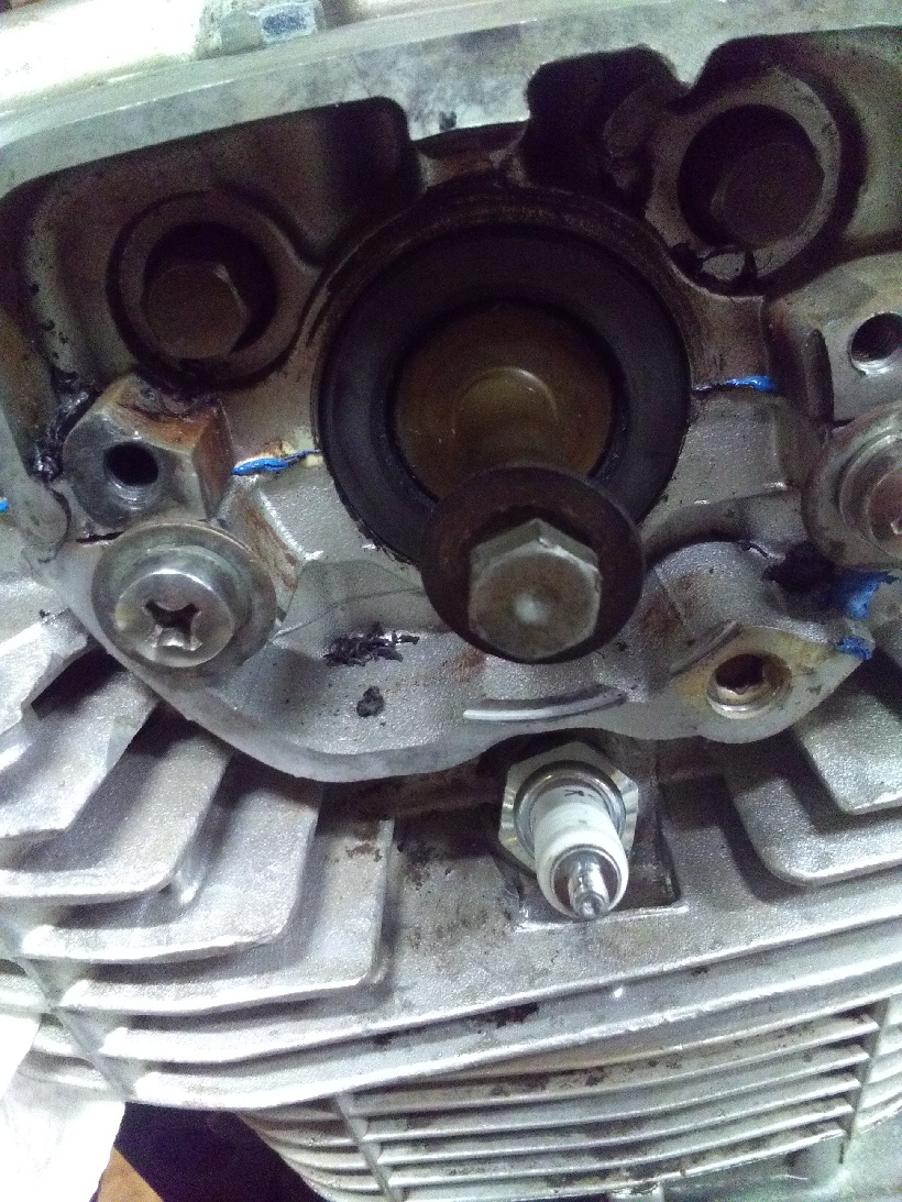

I tore it down again and got the block off. Being my first time last time I expected some surprises, and along the way found this: Shavings in the ignition department. There's only one thing that could be (right?), and that's camshaft oil seal. Strangely though I looked at the seal under microscope and it looks fine, but maybe it just happened that way. I don't remember what I used for grease on it, or if I greased it at all, so what should I be using? New one is on the way...
Also, the head gasket was in fine shape but the base gasket is pretty stuck in spots so it will need cleanup. Its a lot easier to keep junk from falling in with the pistons off because you can really stuff it full with a rag, but I had a devil of a time with those circlips last time and would love to leave them on. Its a lot harder to seal it completely with rags when the pistons are on, and I don't NEED to take the pistons off to replace the block. But should I anyway? Will small fragments of base gasket really cause a problem, if any were to fall in? Second time newbee wants to know.
