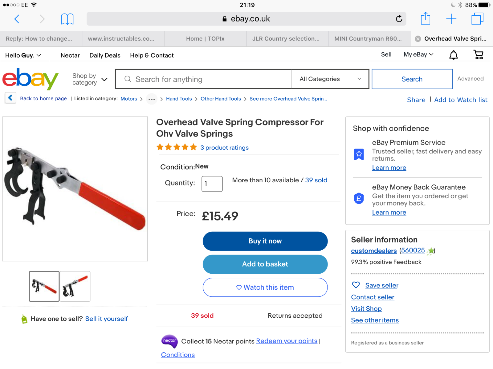

You will need to potentially rework an off the shelf tool such as the below You would need to make a tube to hook it too, the main difference is that with a car you can apply the handbrake to stop the engine rotating whereas with a bike you need to watch it doesn't kick the wheel and knock it off the stand when you hook up the air
