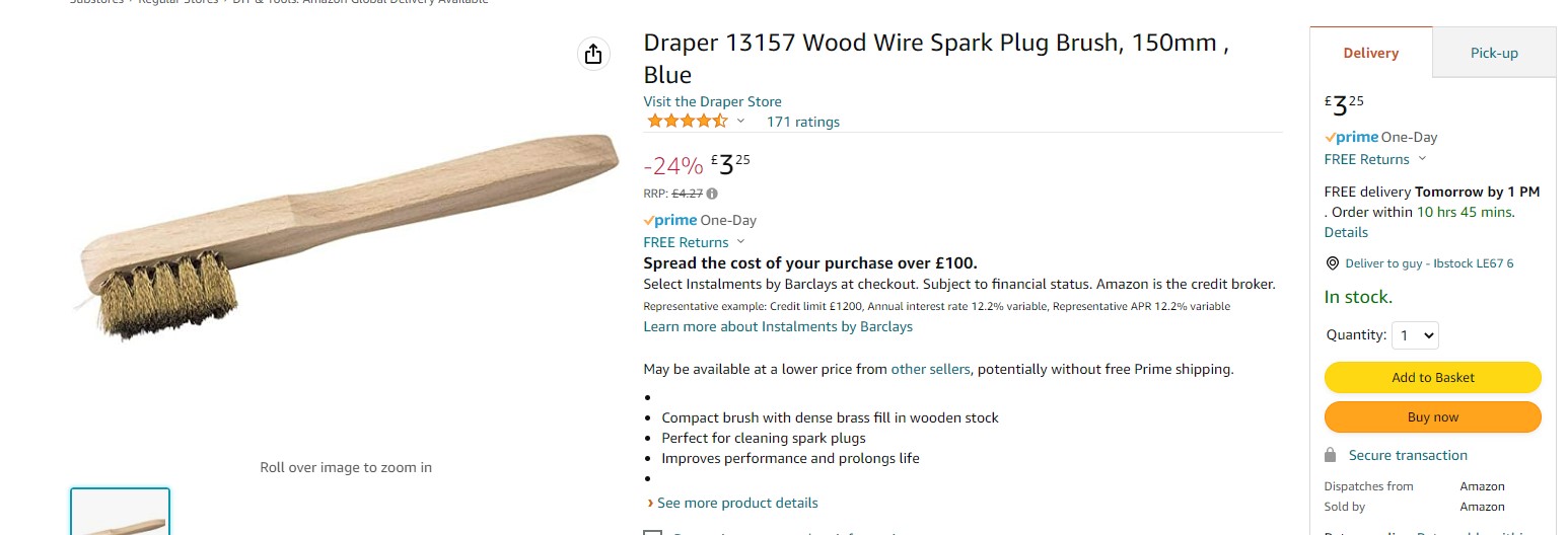

If you want to brush them up after burning (or in place of) there are specific brass brushes cheaply available specifically for this purpose
