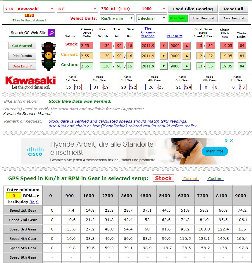

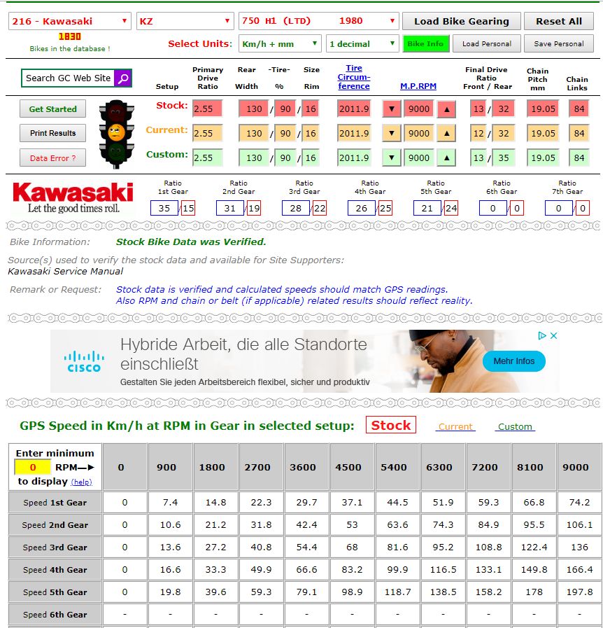

Sorry!! Partzilla says 84 links!! Google give me wrong answer!!
Kz750e 1980
- Posts: 8205
- Thanks: 3577
Re: Chain/sprockets
24 Jan 2023 16:24
84 links x 6/8" between links = 63"
Stock gear ratio = 33/13 = 2.54
13T (630) + 3T (for 530) = 16T front sprocket
2.54 x 16 = 40.6 (use a 40T rear sprocket)
63" chain / 5/8" distance between links = 100.8 links (use 102, since it's necessary to round up to an even number)
One possible change, use a rear sprocket with less teeth. Maybe go to 38T, if you want a lower cruising rpm on the freeway.
www.z1enterprises.com/530-jtf513-series-16t-fr-sprocket.html
www.z1enterprises.com/530-jtr488-series-38t-rr-sprocket.html
