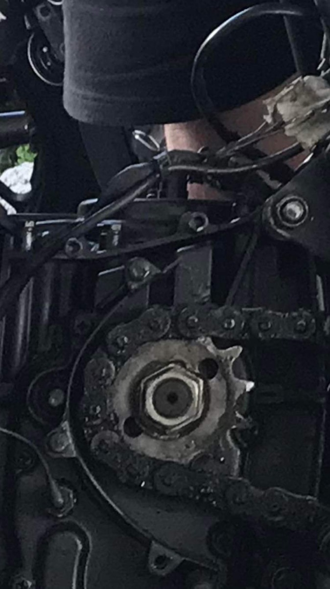

Hello everyone, My old 750 4cylinders has a 13-33 sprocket (original).. I want to down low my Rpm at 100km/h and more… does 14-33 or 13-30 seems to be a good compromise?! What are you suggest me to not lose my low Torque.. and does the 14 teeths can fit with the stock 630 chain without cutting the engine case !!!!!?? Thank you so much

Have you counted the teeth on both the front and rear sprockets? Or are you obtaining the 13/33 count from the manual? It is not unusual for previous owners to change sprocket ratios. You always want to confirm what is on the bike before changing ratios.
