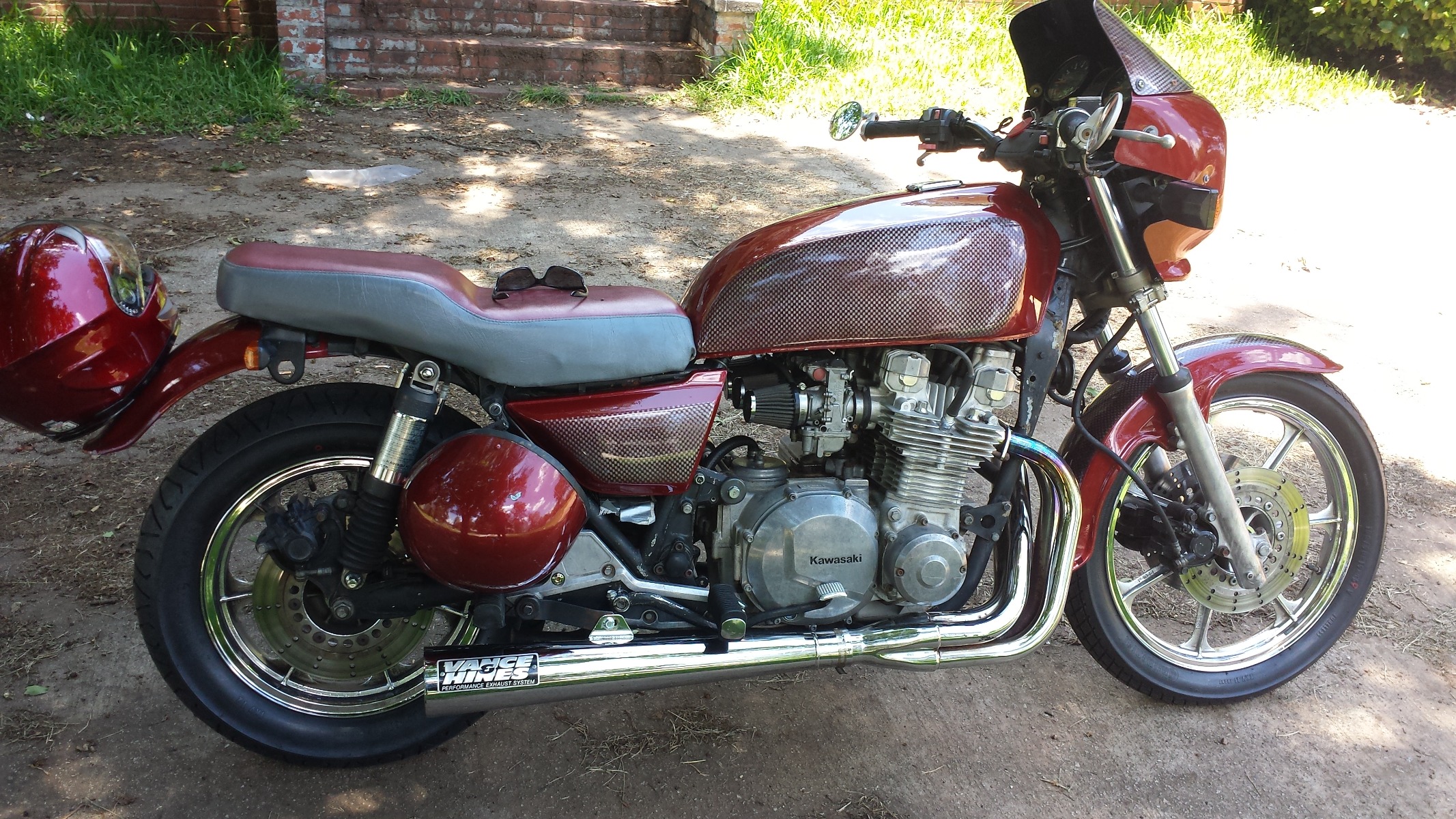

What is the situation with the one you have?
Keep an eye on ebay. Decent J-heads get listed once in awhile, and you can always message sellers regarding potential availability.
1982 KZ1100-A2/1170 sleeper 😀
