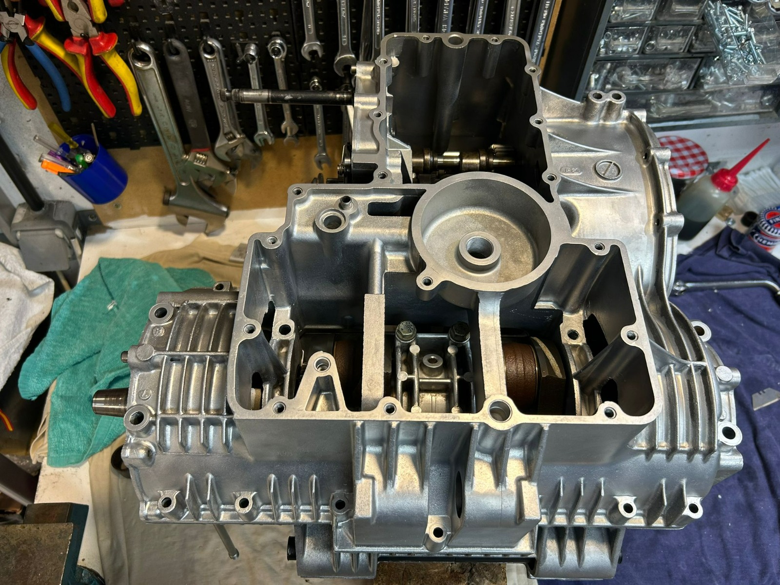

Allright... some advance this weekend. Spent a long time cleaning all bolts for reassembly. Will be changing the large 4 bolts at the sides and reusing the rest. Got the o´ring finally. Funny how the old one looks so different from the new one; I assume it gets flattened.
Well, just a trial fit before I close both halves next weekend. Looking good!

OK! So work has been crazy over the last months, and it was not until yesterday I could resume work on the Kz. I just got both halves together, and got the bottom bolts tightened to spec as per the manual.
Crankshaft moves freely, so no big deal here.
However, I can only manage to get 1st gear in, and neutral. If I try to get second gear, it will just not "grab". I guess I am not moving the output shaft as quickly as I should? (by hand).
Any tricks here? I´d like to make sure the gearbox is OK before advancing on engine assembly. Thank you!
C.

Neutral finder issue?
The following user(s) said Thank You: cartal

The three 2nd gear lock out bearings with only disengage centrifugally so the output shaft needs to be spun fairly quickly to get them all to throw out at the same time which can be tricky by hand.
It's easier to accomlish if the engine is on its side rather than on its front or back but it's unlikely there will be anything wrong with it as it's a very simple mechanism with just the three balls in their slots and nothing else.
