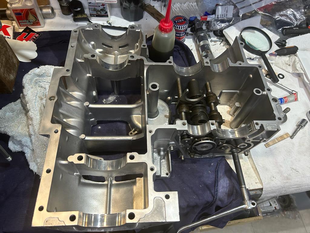

Hi everybody... long time, but have been busy since last.
Things have advanced quite a lot. Status is:
- Engine went to vapor blasting and is back. Absolutely awesome
- Frame went to powder coating and is back. Absolutely awesome
- Tank and side panels are already painted. Absolutely awesome
- Cylinders were overbored to +0,50 to accept the new pistons
- Assembly has begun. Crankshaft in place, new cam chain in place (original was a bit stretched)... all in a superclean engine. Happy!
Will post some more pics, and will start a thread in the projects section, as this is no longer a "piston hole" thread.

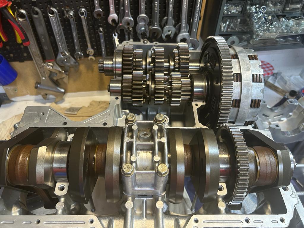

However... I have one doubt that is blocking me for a couple of weeks, as I cannot find detailed information anywhere. I´ve looked at the workshop manual, searched this forum... to no avail.
I have both halves of the engine ready to assemble. One holds the gearbox and clutch (and crankshaft etc.), and the other one holds the gearchanging mechanism.
But, I really don´t understand:
1.- I feel gears should move freely (they don´t). See video
2.- How do the "forks" sit in the gears? What position should they have as I lower them in position?
3.- I´ve followed the manual, and the gear selector is sitting in the neutral position, but do the forks need to be "inside" the shift drum "channels"?
I´m reading the workshop manual (page 6-45), but it seems to say "just drop it, it will work"... and I´m not sure it will.
Any ideas?
Thanks in advance!
C.

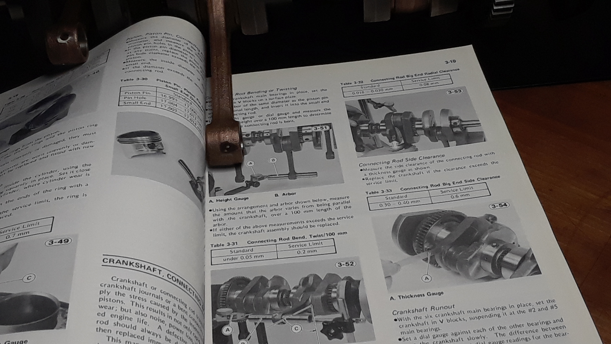

Curious whether the crankshaft thrust bearing and rod clearances have been checked per FSM spec tolerances?
1982 KZ1100-A2/1170cc sleeper 😀
The following user(s) said Thank You: cartal

Just a reminder. You need an oil gallery O-Ring and the trans bearing locking rings installed before case halves are mated.
The following user(s) said Thank You: SWest, cartal, Wookie58
Any ideas?
Thanks in advance!
C.

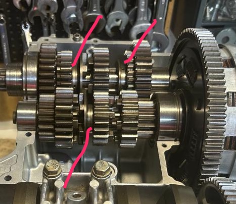

The pegs on the forks do need to be engaged with the shift drum when you assemble, also see below for the locations the forks need to engage with
- Rolf1976_KZ900
- Posts: 498
- Thanks: 261
Re: Piston Hole Kz1000LTD 1982

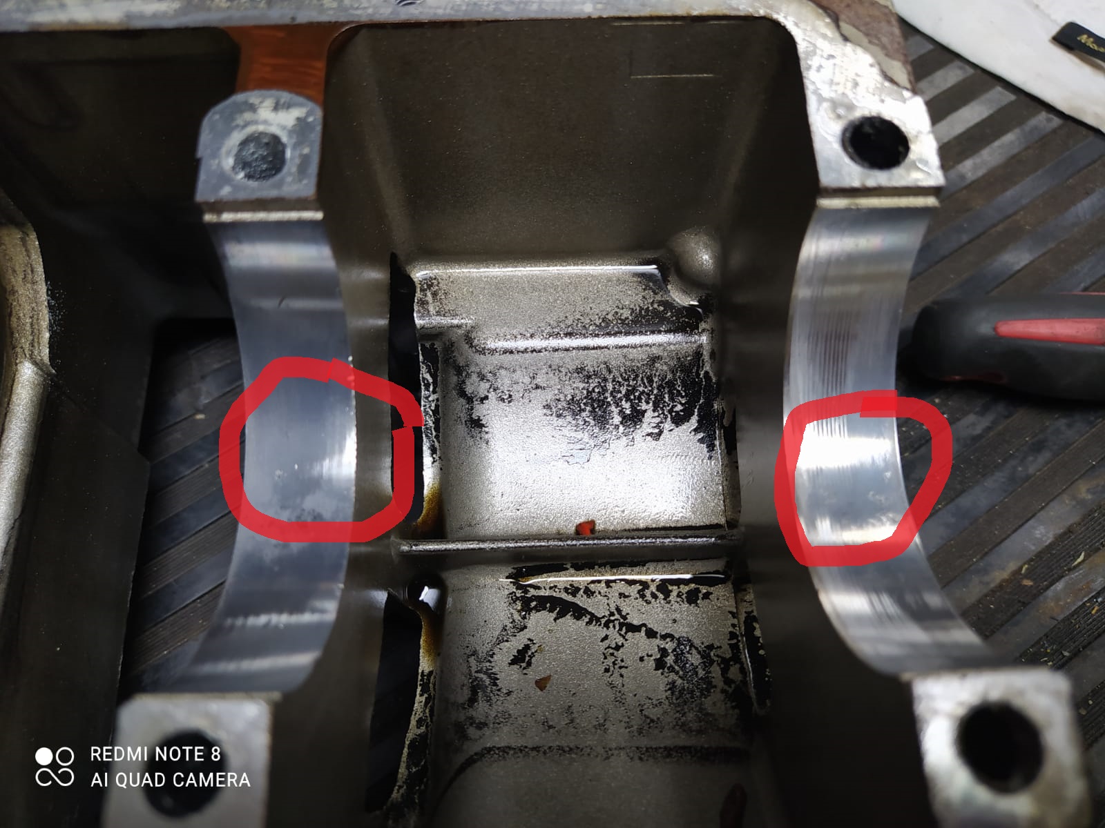

03 Sep 2023 02:35 - 03 Sep 2023 02:43
If you not already done it i recomend to inspect the transmission for wear .Check the shiftdrum and its bearing and the shiftfork axle for runout. Also check the shiftforks for wearThe drum can look fine when just looking at it with naked eyes ,but when taking hi res pictures the wear marks show up .Also check the geardogs if they are rounded
Last edit: 03 Sep 2023 02:43 by Rolf1976_KZ900. Reason: pictures

04 Sep 2023 05:56
Daveo,
I tried to check per the manual as much as possible, but the reality is I don´t have dials. I did all I can with checking the bearings and tolerances with gauge blades. Looks really good to me, so I assume everthing should be OK.
