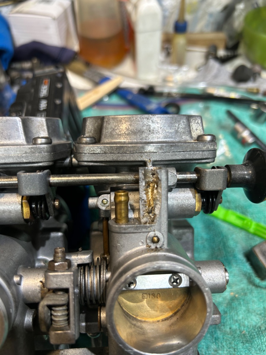

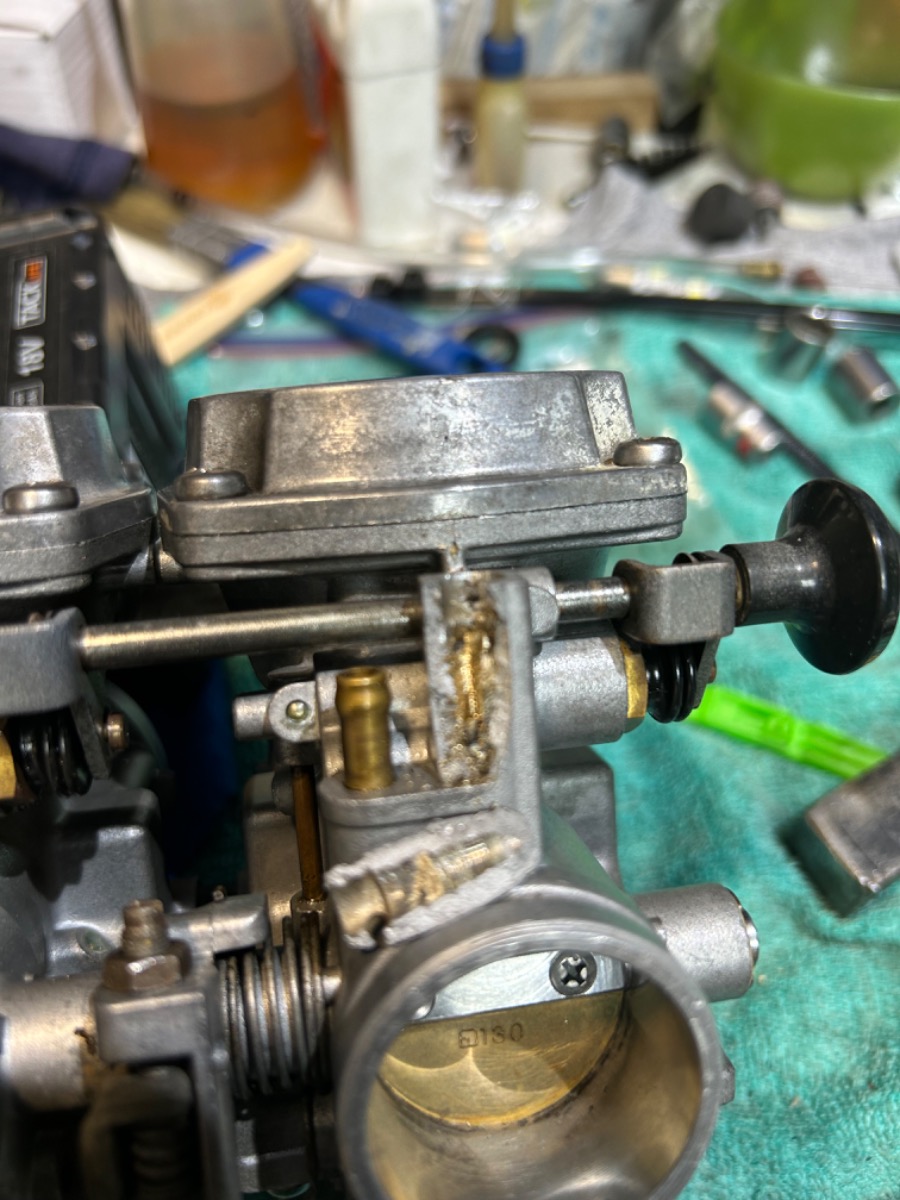

Not so good news today. Lots of penetrating oil, and tried to move it from the top. Finally drilled a hole and went in with a bolt extractor.
i can’t believe it; but I am wondering if the damn po guy got some loctite here or what. In any case; a large part of the needle housing gave way and even now, the needle won’t move.
The only way I see moving forward is to:
1.- replace that carb body (getting them all apart)
2.- find a new set of carbs
Here is a picture of the butchered carbs:

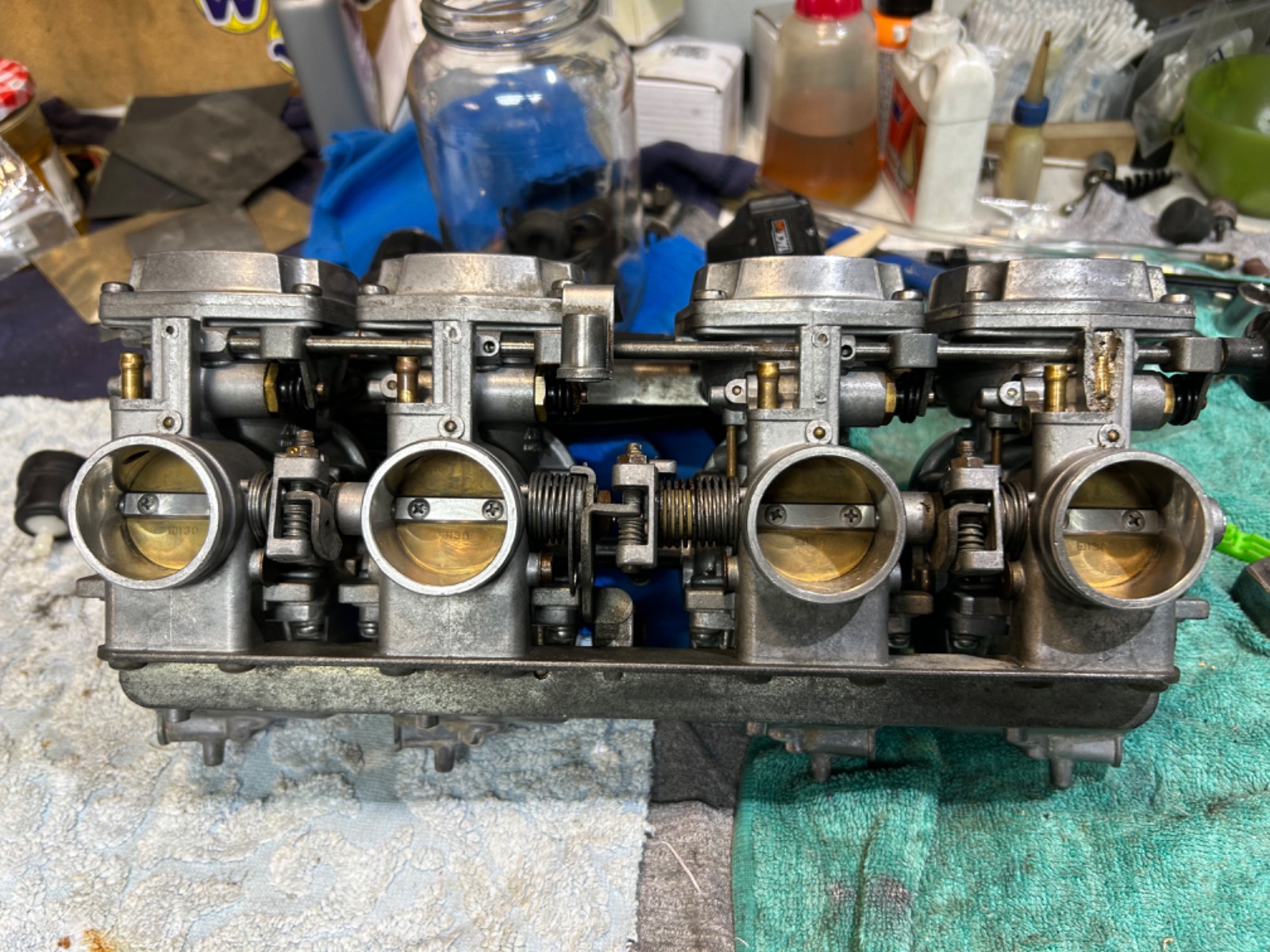

I have found a set of z1000j carbs in ebay Germany, that don’t cost an arm and a leg; but seem to be completely different from the ones I have. Would these fit? Would any other bike model fit? Take a look at the pics

I'm still looking at a future BOTM
see what you mean with the German carbs, they appear to have a remote choke ?? Not sure if the later J3's went to remote ??
