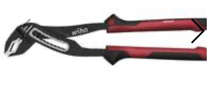

Re: Valve adjustment Z650 B2 1978
23 Dec 2022 13:54
Project:
23 Dec 2022 14:51
Those can for sure cause more damage than a magnet, unless used VERY carefully.
24 Dec 2022 23:55
How can you damage?
25 Dec 2022 04:54
If you scratch the bucket or mark it in any way.
Remember the bucket is pushed down into the head recess by the cam lobe and needs to be able to rotate within the recess also. If the bucket cant rotate due to a scratch or burr the wear on both it and the head recess will be will be one directional, front to back, the more it rocks the quicker the wear.
I've not heard of a fix to recess wear othe than custom made oversize buckets.
25 Dec 2022 10:21
I understand.
I have been abel to lift them with one grip on top of the bucket and I think these location/point is not touching anything…?
Will use a magnet next time
