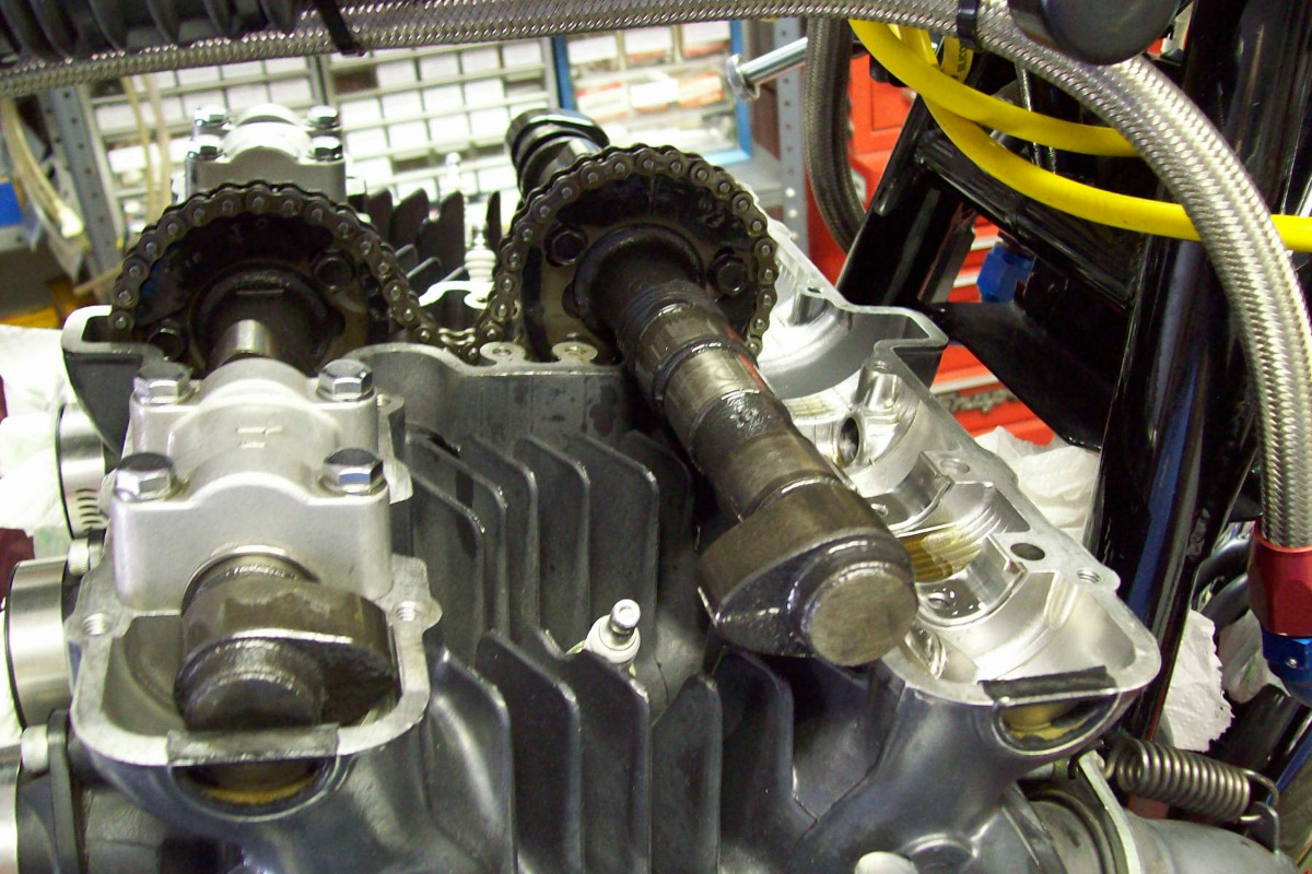

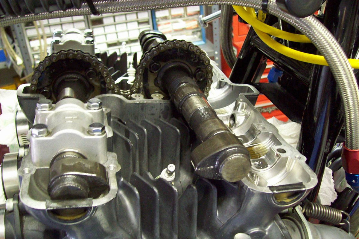

If I have to change the shim size on the shim under bucket system. I pull one cam at a time. First I set the cams at 1/4 TDC like when you install them. Remove the top tensioner. Then I remove the cam caps. Instead of removing the cam, I roll the cam out of place over the buckets but keeping the camchain taut on the cam sprocket so the camchain does not come off the teeth on the crank. I keep the camchain play between the two cam sprockets as seen in photo below. Change your valve shim. Then roll the cam back in place while keeping the camchain taut on the cam sprocket and on the crank. Install cam caps, and top tensioner, reset camchain tensioner. Then rotate crank 720 degrees to check cam timing. I always recheck the clearance on the valves I changed the shims on. Thats it!!!!
Its a little harder to keep the camchain on the cam sprockets if your bike has the HY-VO style camchain. I have used this method since back in the '70's when I installed the shim under bucket set-up in my Kz1000 motors.
