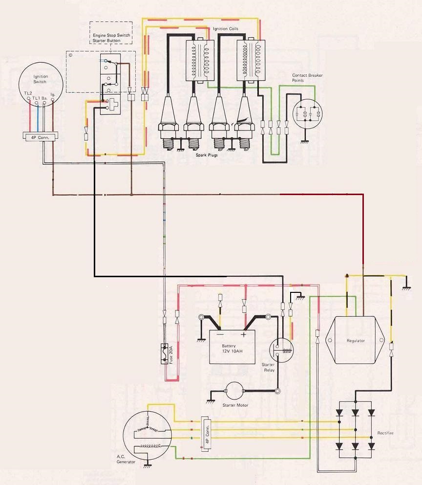

The diagram shows 1 coil feeding 2 cylinders NOT cylinders 1 & 2 or 3 & 4. Diagrams are drawn for simplicity not positional accuracy.
As I, Rob (zed1015), and dynatek have told you 1 coil supplies cylinders 1 & 4, the other does 2 & 3.

This is what im not understanding:
The diagram Warren attached shows one coil feeding cylinders 1& 2 and one feeding 3 & 4. According to Dynatek, thats not how it works. The Left Coil feeds 1 & 4 and the Right Coil feeds 2 & 3.
One coil feeds cylinders 1 - 4 and the other 2 - 3.
