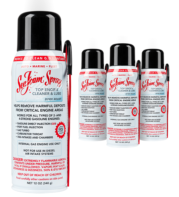

Are you asking about the valve in the head out of the motor, or assembled in the running motor? Your question is very vague.
On a running motor I have seen car guys use combustion chamber cleaner like this :
Smokes like hell, never used it on my engine as it looked real messy and if not used to direction could really hurt (damage) your motor.
You really don't need to do this if you ride you bike hard enough so it does not load up (too much idling)
On a head that is out of the motor I just soak in undiluted Simple Green, a few days of soaking and the carbon will scrape of easily.

I believe that the Seafoam aerosol spray is meant to be injected into a throttle body for a certain amount of time while the engine is running. I did use it on a 4 cylinder Ford Ranger motor, (tons of smoke during the process), and found it very effective on overall performance, (before and after). I don't know if that can be applied to a inline 4 cylinder motorcycle engine as it has 4 separate carbs. It may be worth a try if you're looking for a tune-up in a can.
