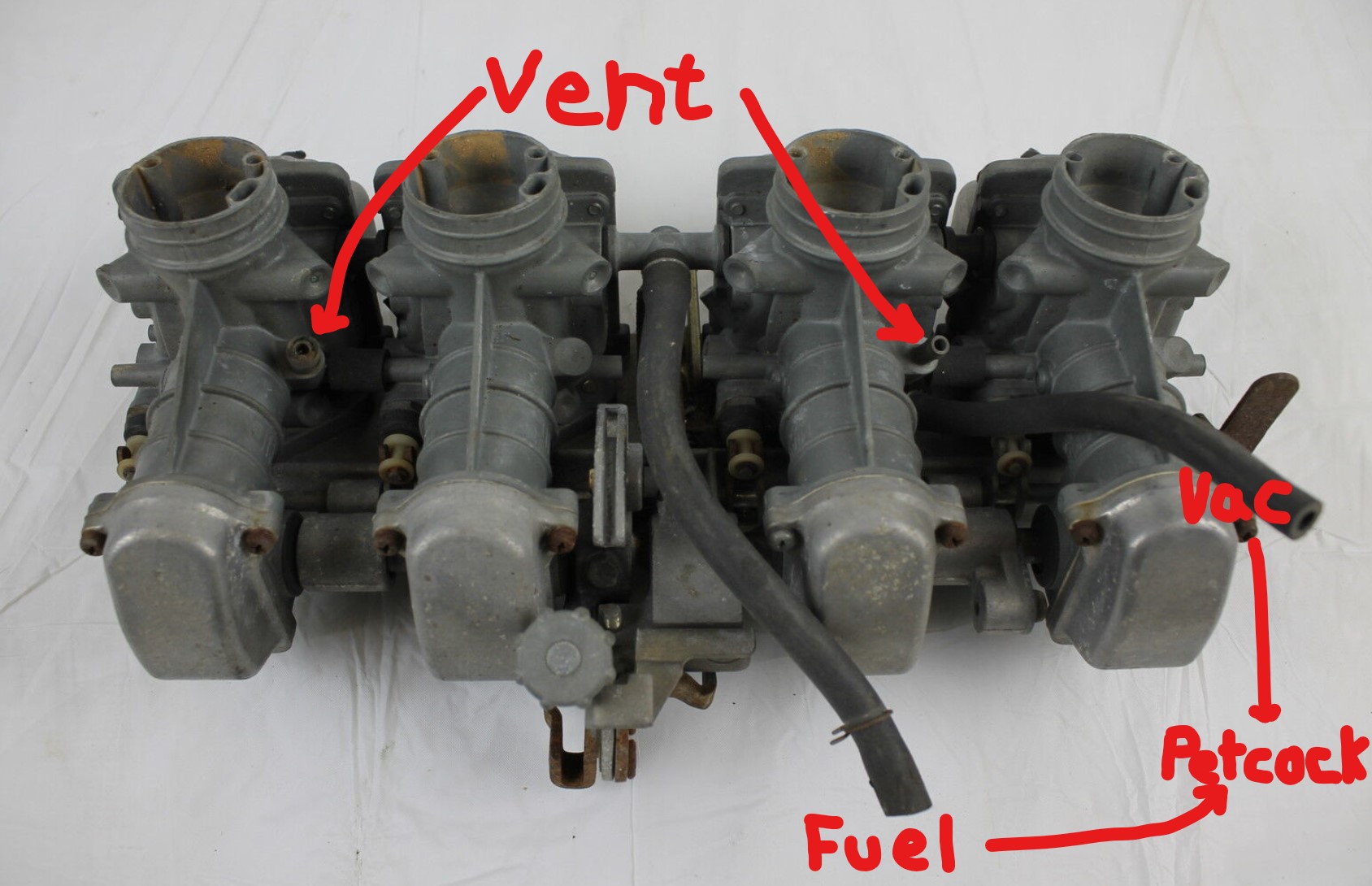

06 Nov 2022 05:25not true. as nessism posted, there is only ONE fuel line from the carbs to the petcock. see below

Yes, sorry, I mis-spoke. the fuel T is between 2 and 3, not 3 and 4 as Nessism shows below. This is my exact setup. the fuel line is properly affixed to my carbs. I havent taken the carbs off yet but its clear there is dirty or something in the jets of carbs 1 and 2

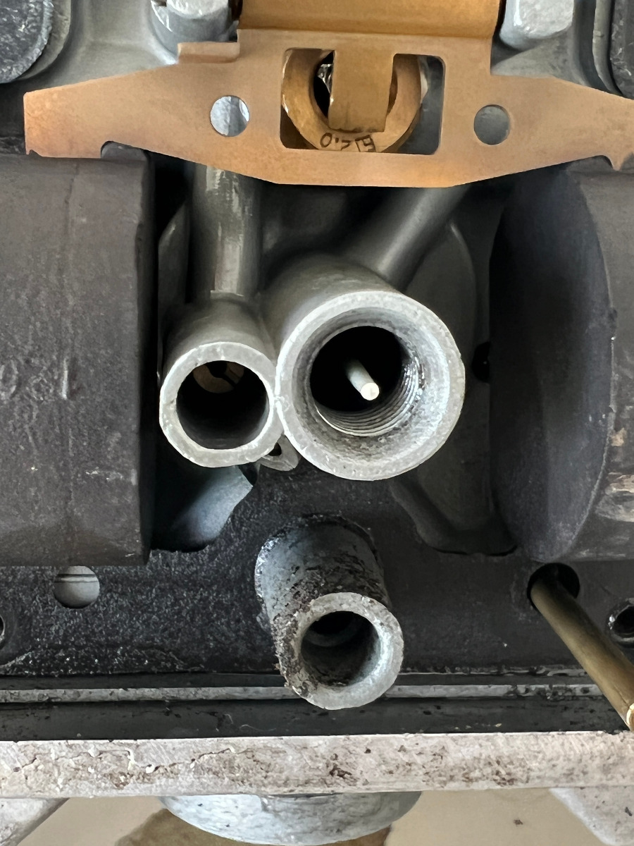

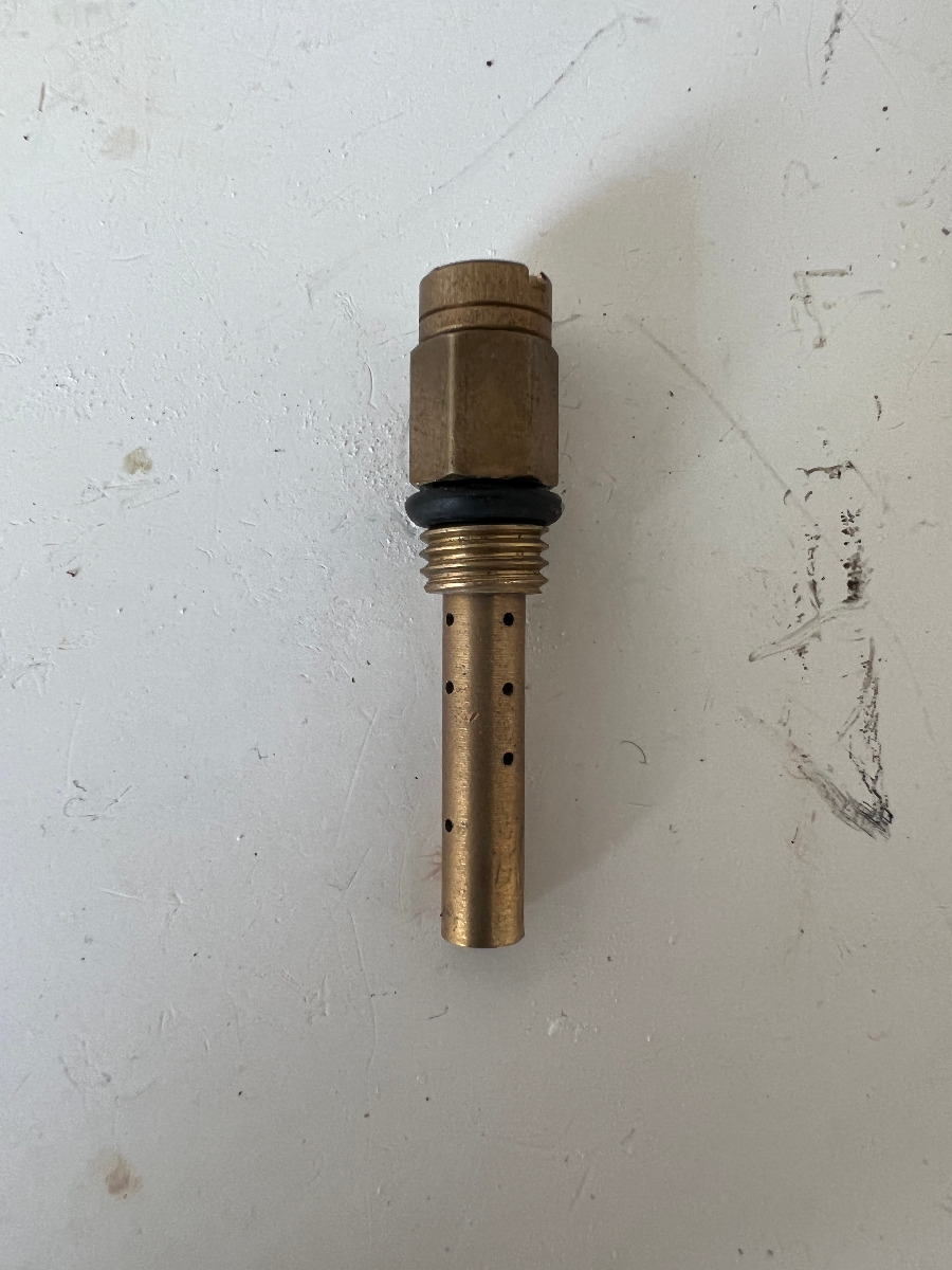

I took the float bowls off the two problem carbs (I will go through the entire carb body but wanted to look at the jets first.) Rubbers look good. Pretty clean inside the float bowls, but I noticed this jet below, on both of those carbs, had dirt in the bottom little holes. I couldnt see straight through them until i used compressed air. I also took a look at the little tiny jet on the left, right next to the bigger jet, but they were clean.. Would the jet below, being clogged somewhat, have caused fuel starvation, backfiring, cold pipes or would it have been the little jet on the left of it? And what is the big jet called?
For background, the bike idles fine, but when i give it throttle it backfires and sounds terrible.
The little jet on the left was clean, took it out and looked:

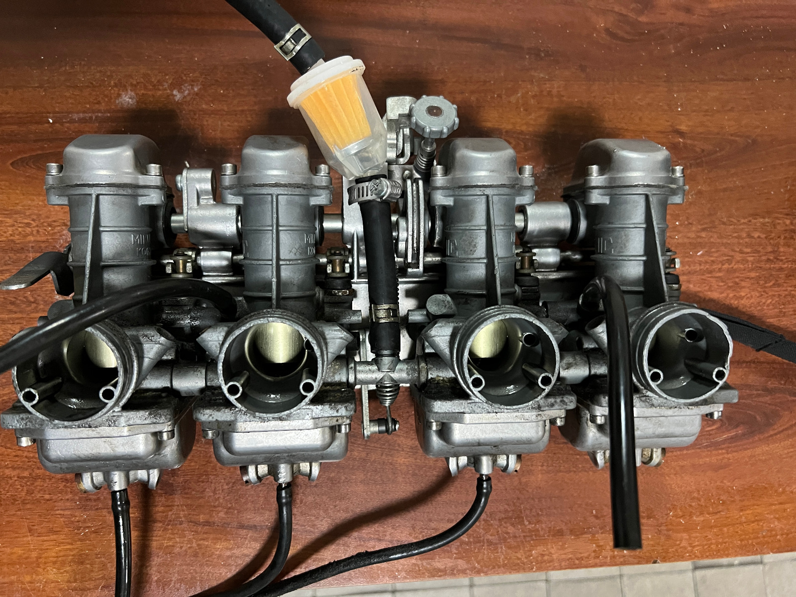

the carbs when I took them off:
