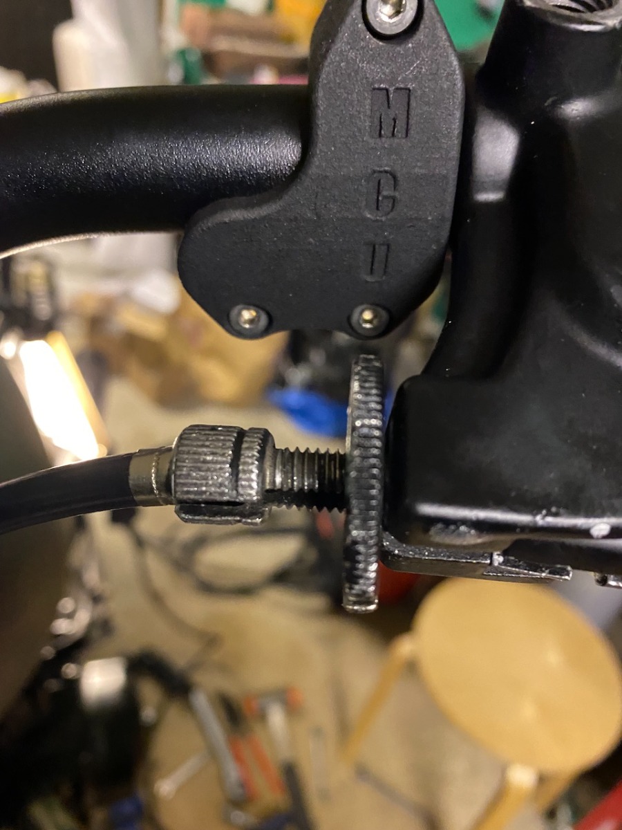

Hello, seems I need some help/advice as I either is totally stupid or doing something wrong.
First, english is not my mother language so there may be some wrong names on some parts. What ever I do I cant get the clutch working on my project bike a rebuilt KZ400ltd (Pictures in the project thread).
As the original clutch cable was broken I bought a new one on ebay, OEM according to the seller. Though, the new one is a bit shorter but the "nipple ends" (Cabel outside the cable cover) seems to be the same. I attached some pictures to support my problems...
When installing the cable I did like this:'
1. Make sure the release arm is in right position and attache the wire.
2. Mount the cover
3. Adjust the screw that press the rod until I get some pressure on the rod.
4. Mount the wire on the clutch handle.
5. Adjust the screws on the cable and the handle.
Result: With max adjustment on the cable and up at the handle the clutch don´t "kick in" when pressing the handle. When adjust for some more pressure with the screw for the rod at max adjusted, I can feel that the clutch give only a small amount of effect when pressing the handle.
-Could the cable end (outside the cover) be to long?
-Did I something wrong with the install or adjustment?
-Can there be any faults with the clutch itself? (Have checked the rod, and it looks fine I think)
Would be happy for some advice on this problem...
