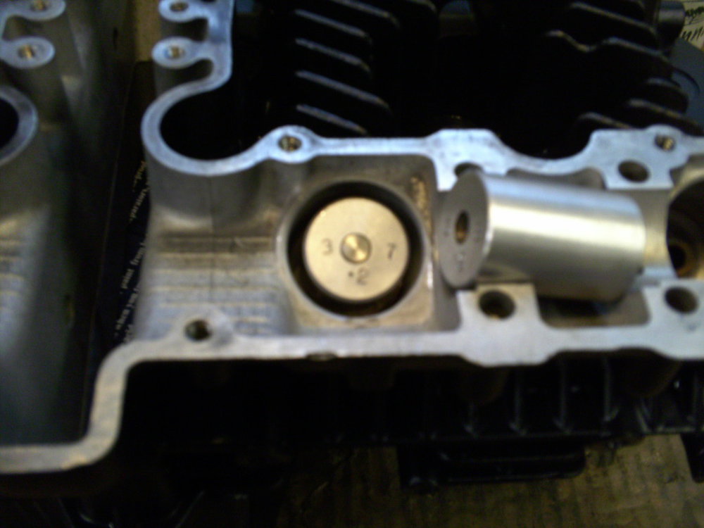

If the valve is stock then you can take off 0.30 mm .
Any more and you can trim the collets and retainers if they are shim on top by a max of 1mm.
A vernier depth gauge can be used but that is tricky and can give inconsitent results even for the non diy-er.
A height gauge as in the pic of the correct minimum length is the only way to get reliable readings.

You need to take the installed height measurement from the valve tip to the bare head with the steel spring seat removed.yes sir that's the information I was seeking.
