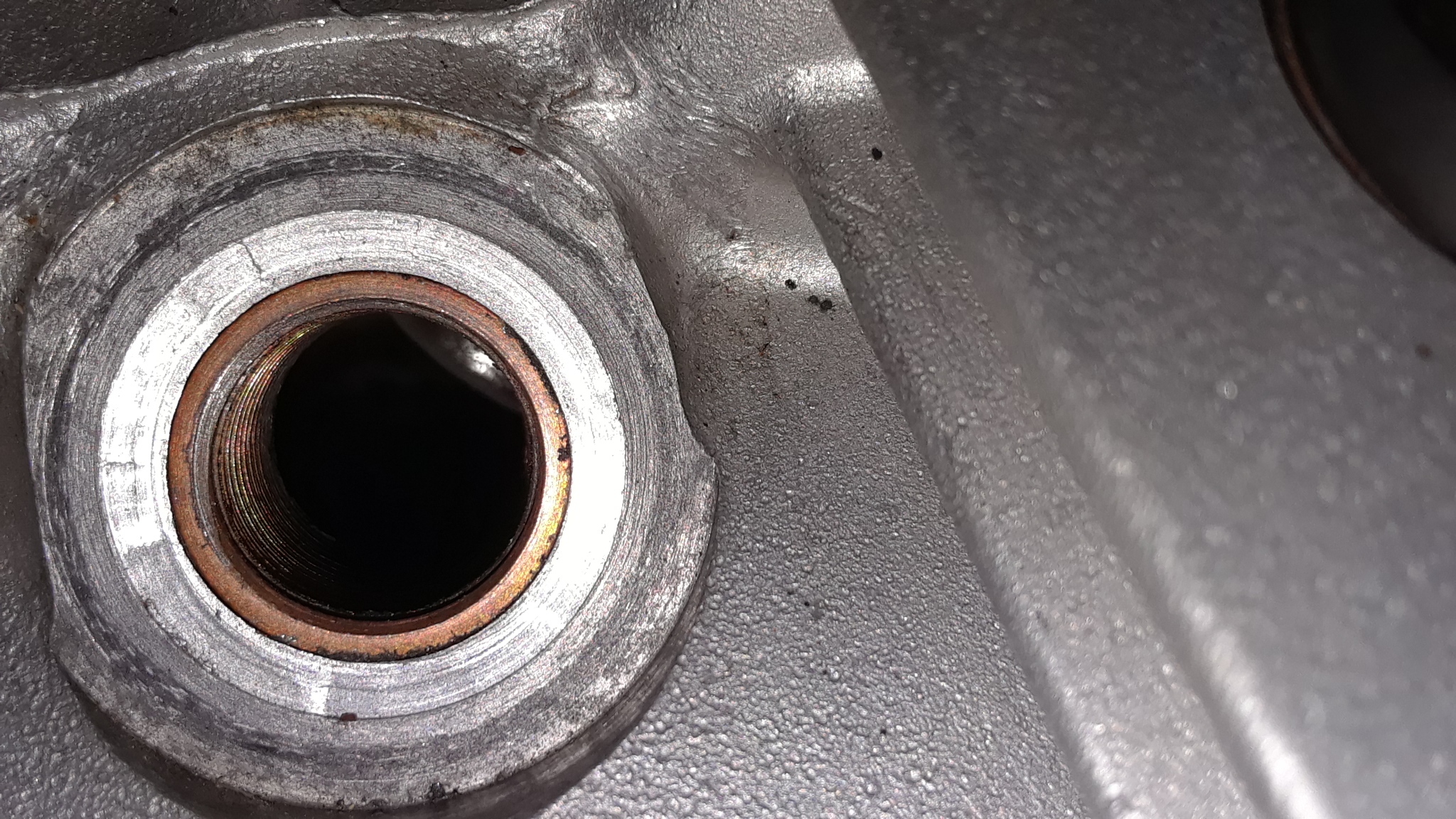

Last year i make rebuild the spark plug hole. But the new filter don't do totally inside and i have perhaps a 1 mm edge under the spark plug.
So the spark plug is more short than other one inside the engine...

Not sure what exact repair changed on the head , But proper fix is to make the hole to correct specs, so it matches other 3 cylinders
Anything else is marginal and is a severe compromise

Personally I would remove whatever has been done previously and use a " time sert" to bring it back to correct spec (this also gives a good surface for the seal

This is the time insert actually on the head. You can see the edge on the top of it. The engineer was not able to fit it inside totally...
I think i will play with the gap today and see if the noise is the same ot not.
For the moment i want to know if that is the problem...

16 Sep 2022 10:15 - 16 Sep 2022 10:15Any exposed threads below the sparkplug , or any metal protuding into the combustion chamber will cause a hot spot which can cause pre ignition / detonationThis is the time insert actually on the head. You can see the edge on the top of it. The engineer was not able to fit it inside totally...

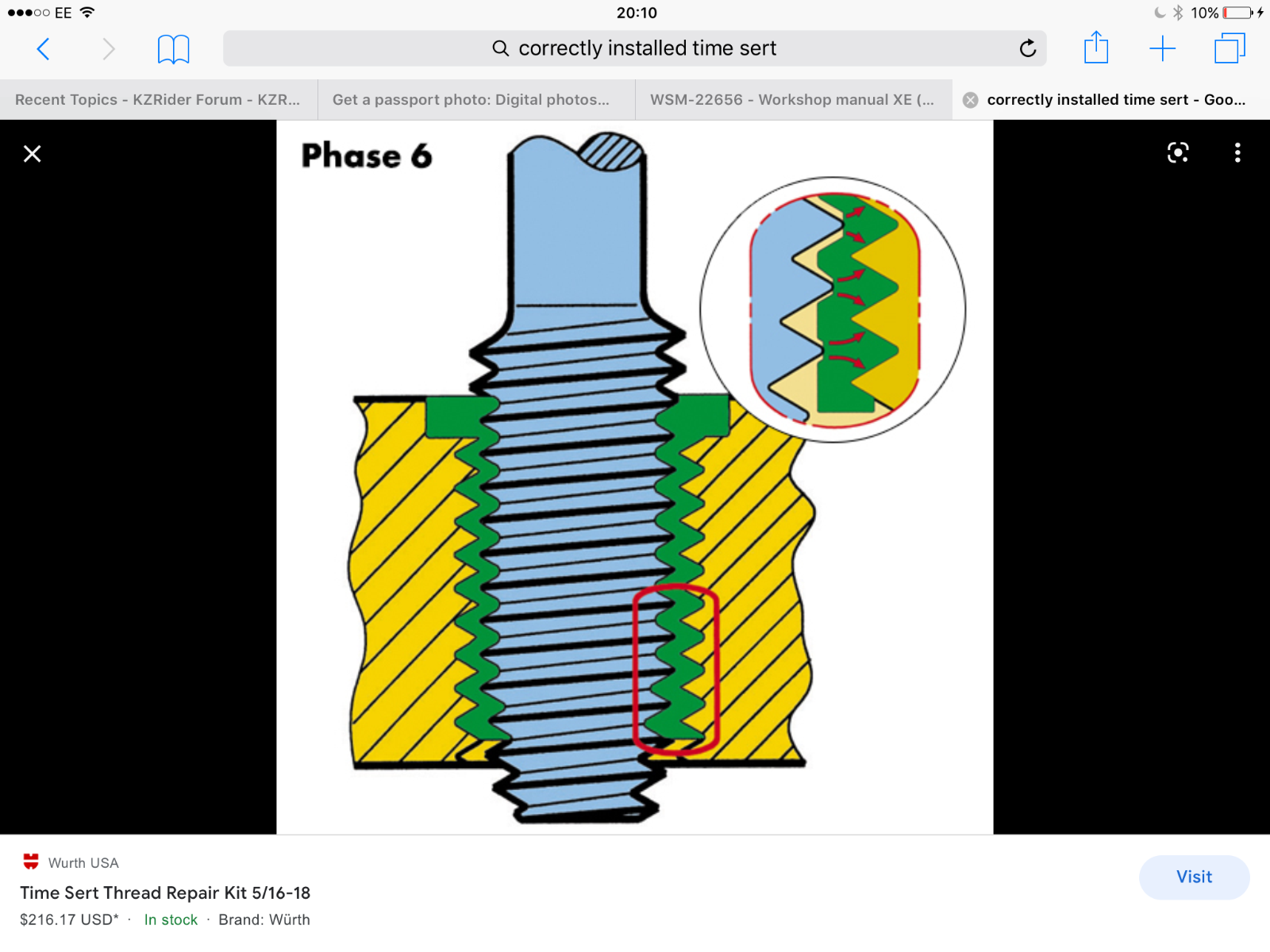

The "time sent" should be flush with the base material (see the green part in the diagram) if it's protruding it sounds like it hasn't been done correctly. Was it done with the head on the bike (where did the debris from drilling and cutting go ?) and as Dirk said, are you sure it's not poking inside. This sort of work should always be done with the head removed as there is always "debris" and as it's alloy you can't recover it with a magnet
