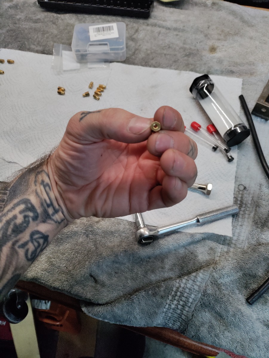

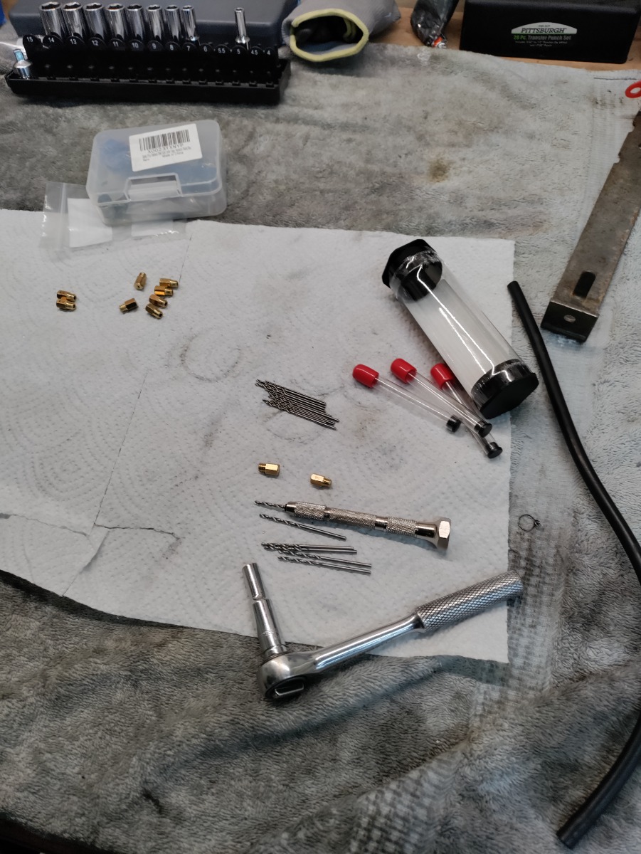

I drilled out some extra main jets I had with the biggest micro bit I have. Stupid fat jet test coming Sunday. I'll keep u guys posted.

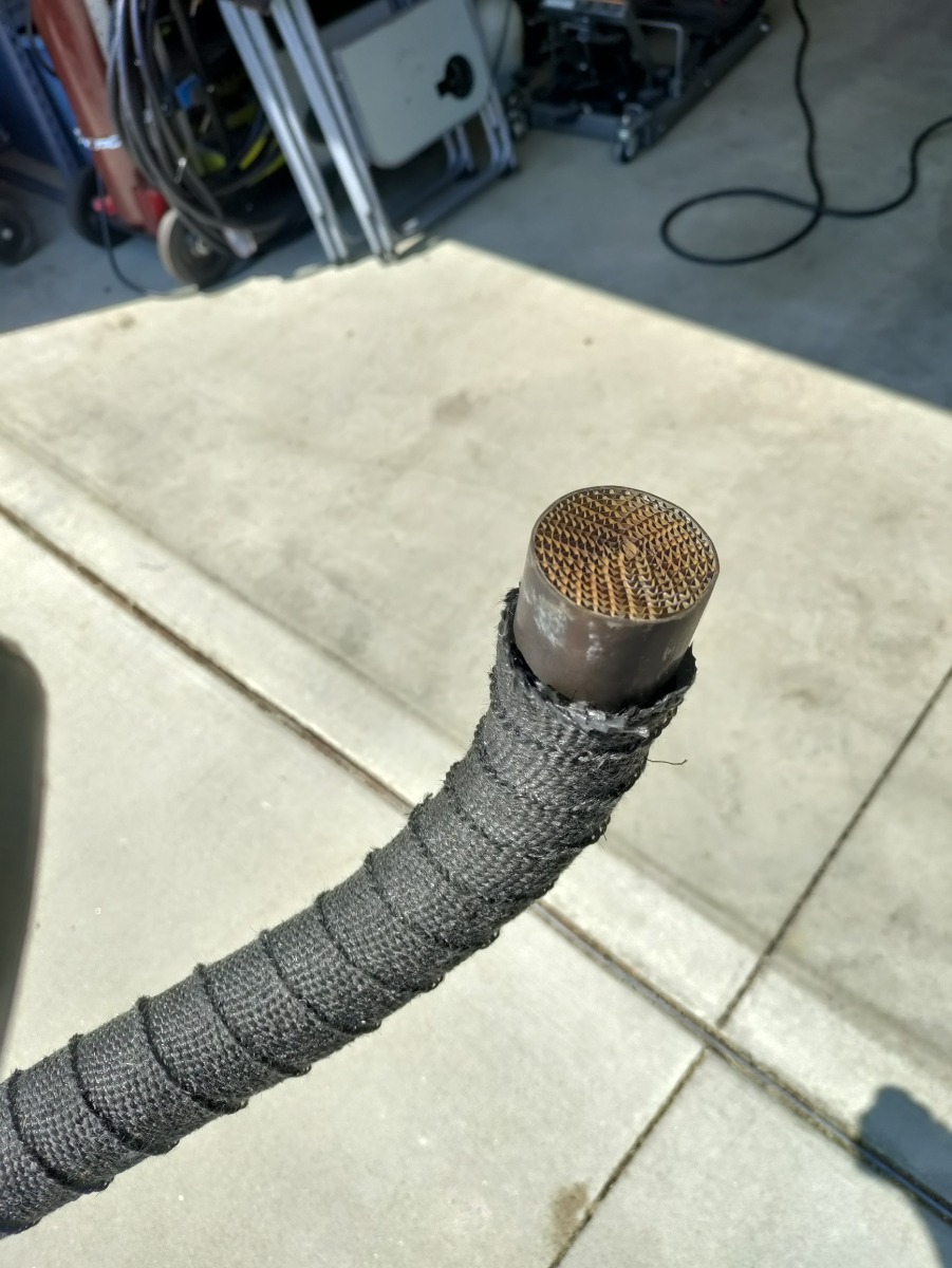

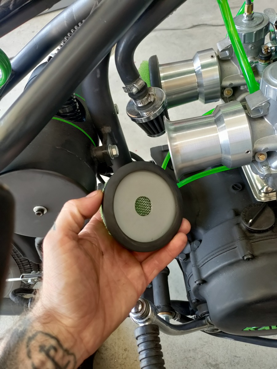

I ran a bunch of tests today. I put baffles in my exhaust. I drilled out a bunch of jets different sizes going up from 200. I made some throat restrictors. I even made some for the V-stacks to restrict air, trying to keep the suction going through the Venturi. One adjustment at a time, then adding another and another starting from squar one every test, trying to just get some kind of a response and I did. I got it to not die when I hit the throttle but that came with a couple other problems. Bogging at 3/4 to full throttle, To much fuel. Or popping and cutting out at 3/4 to full throttle.
