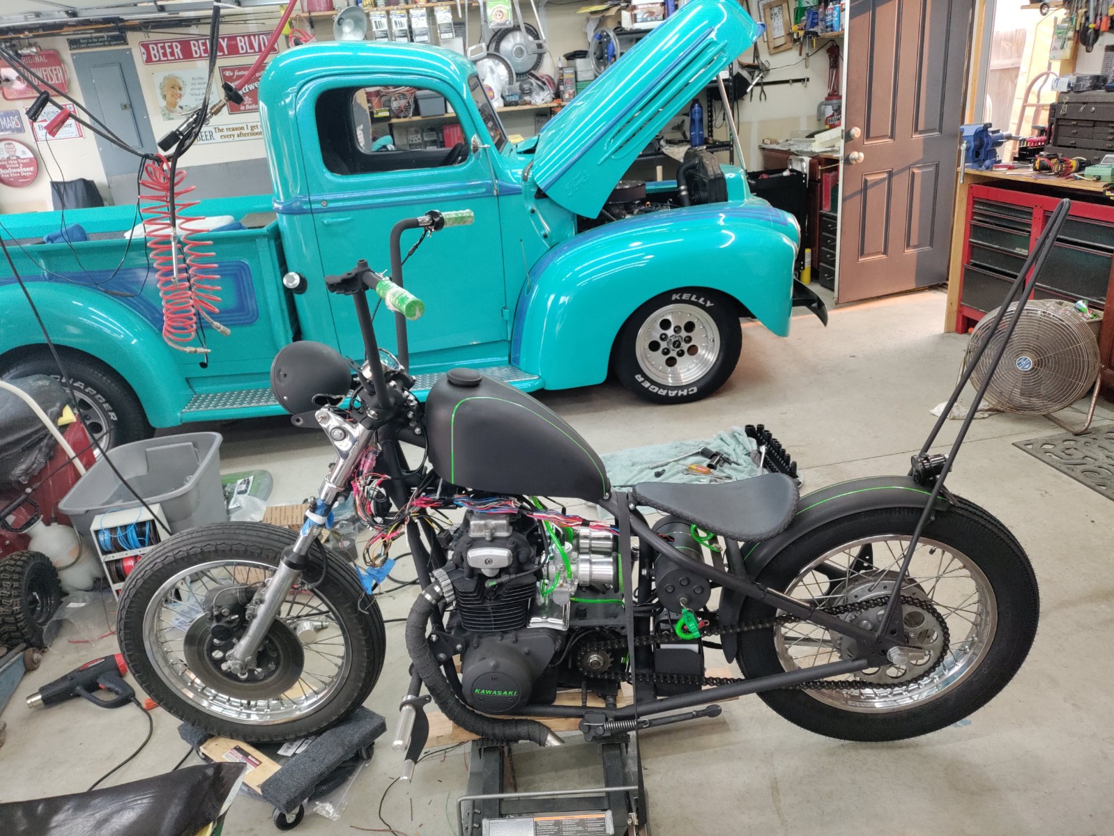

I have a 1977 kz400A deluxe, I've been working on for 2 years. Lots of custom work done, full rebuild, speedmoto twin Mikuni vm30's with V-stacks, new everything. Anyway, my problem is I can slowly pull the throttle an it will go from idle to WOT no problems, perfect even. But if I pull the throttle quick it instantly dies. Both carbs are sinked and set. Float hight in spec. Valve clearances are in spec. Timing at idle is on point and at full advance. I've tried re-jeting, restrickting air flow, and rechecking and checking everything. I can NOT figure it out. This isn't the first, second, or even tenth bike that I've rebuilt. The only thing I can think of is maybe my advancer CAINT keep up. But there's something I'm missing...... Any help would greatly appreciated. Thank u.

Jetting with the velocity stacks is my first thought
Need for accelerator pump is next along with carb sizing ( What comes stock on your motor )
OH And NICE TRUCK

That short exhaust isnt helping
Are their baffles inside those pipes ???
Im sure you are aware that tuning is a dark art sometimes due to radical changes from stock.
Im not suggesting you return all to stock but differences in air flow from a stock airbox to stacks , to pods
and then differnt restrictions of pipes in backpressure can make a spot on tune hard to get right

First off, thank you very much everyone for all the suggestions. I have been at a complete loss and unable to move forward completely out of ideas and now I have some things to try out. I did not think about my exhaust, I've straight piped a couple bikes before but never this short so I will keep back pressure in mind maybe come up with some kind of a baffle.
