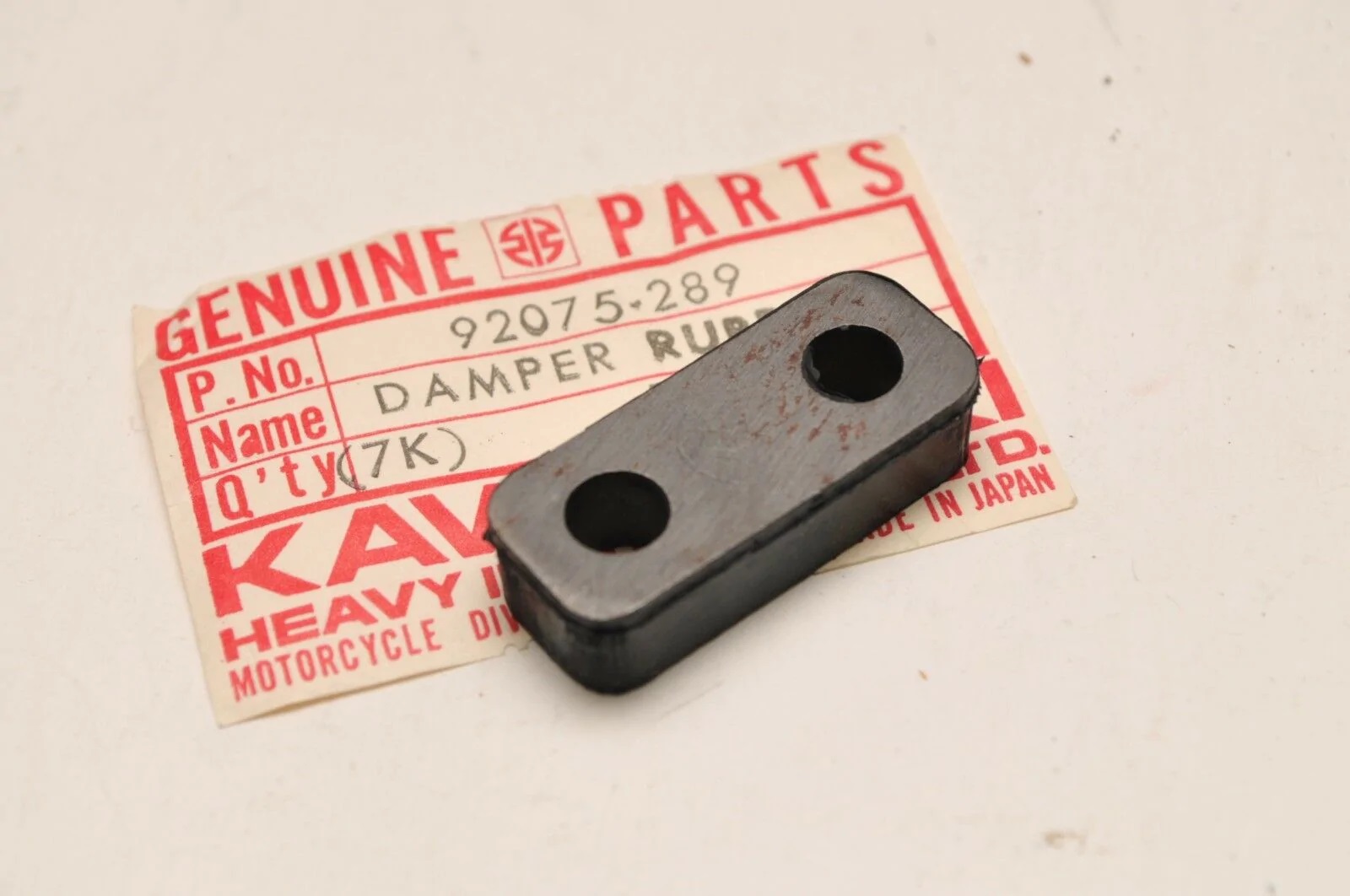

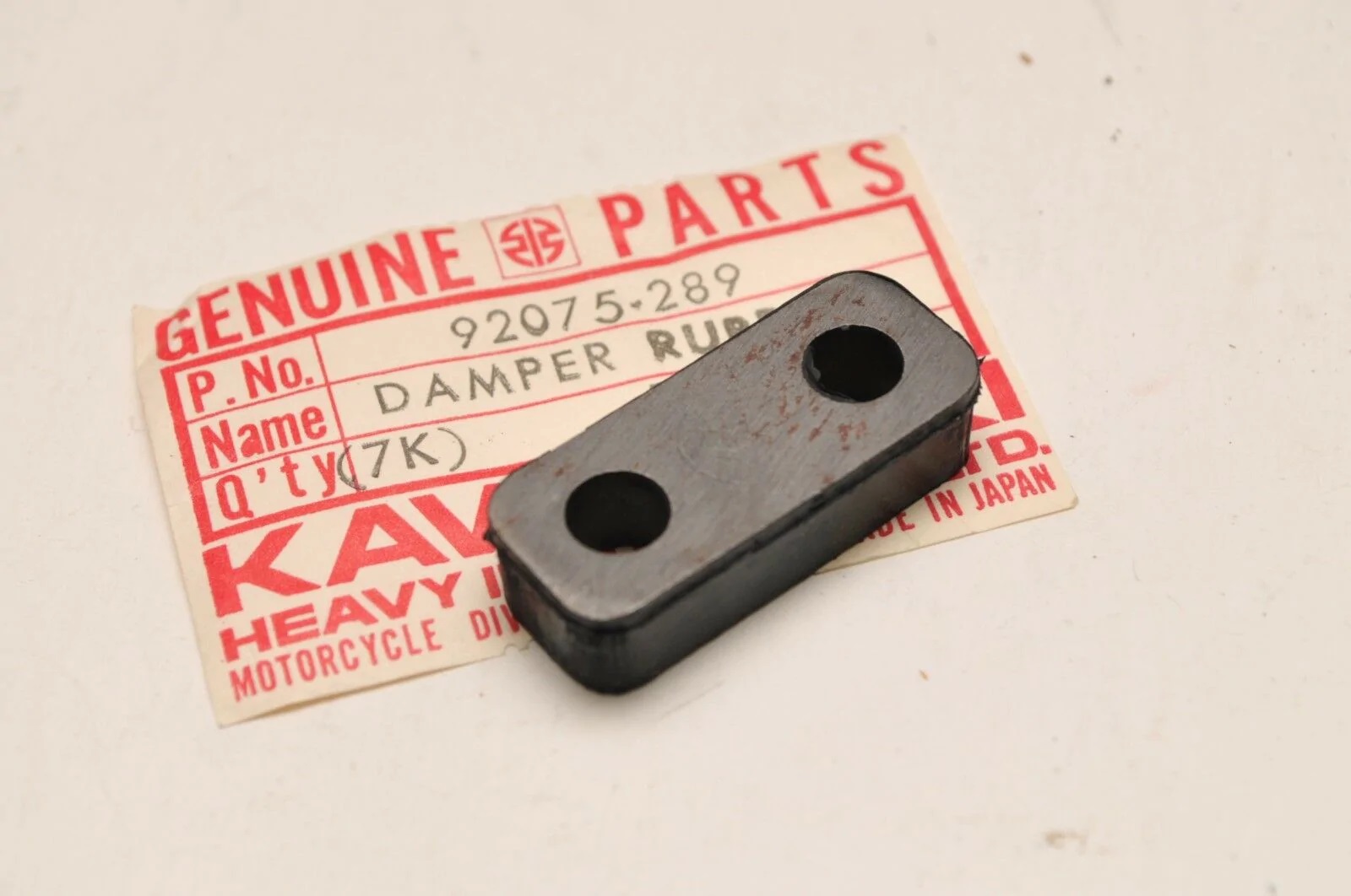

Re: click on the engine
16 Jul 2022 19:22
What do you think about my cam chain tensionner 12048-001.
I know this one is worn.
In more i have one Damper rubber that is broken 92075-289
between the 2 metal plates i didn't replace it ...
