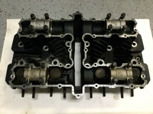

Ok, so I finally just bit the bullet and bought one..searching and searching for a good deal just never happened. So now I have another piece of the performance
puzzle. I realized that my 81 head just ain't worth putting any money into, as it will never really perform. It's fine for burning up miles and doing stock restoration not much more.
I have the 34mm FS Mic, Dyna2000 Ign, Kerker4into1...but not sure on the cam and pistons. I want about 130hp, not sure the parts combo that will make that. I'm sending the head straight to Cavanaugh for a full rebuild, port and polish. Since its an 81, it burns oil from the bad bore job from the factory, so maybe do a 1170 or 1200 something big bore.
Thoughts welcomed.

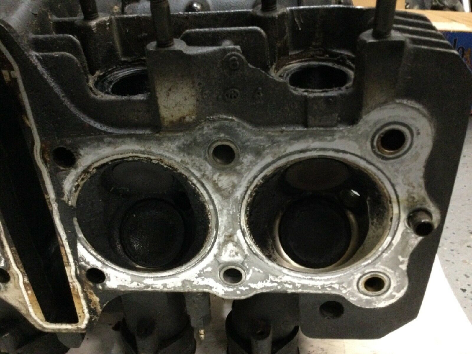

I didn´t see the bath tube chamber in your pic. Did you get the ZX10A (GPZ1100UT) cams with the head?

“I didn´t see the bath tube chamber in your pic. Did you get the ZX10A (GPZ1100UT) cams with the head?”
No I did not get them….I still need to figure out that part, and how far I want to go with it.
