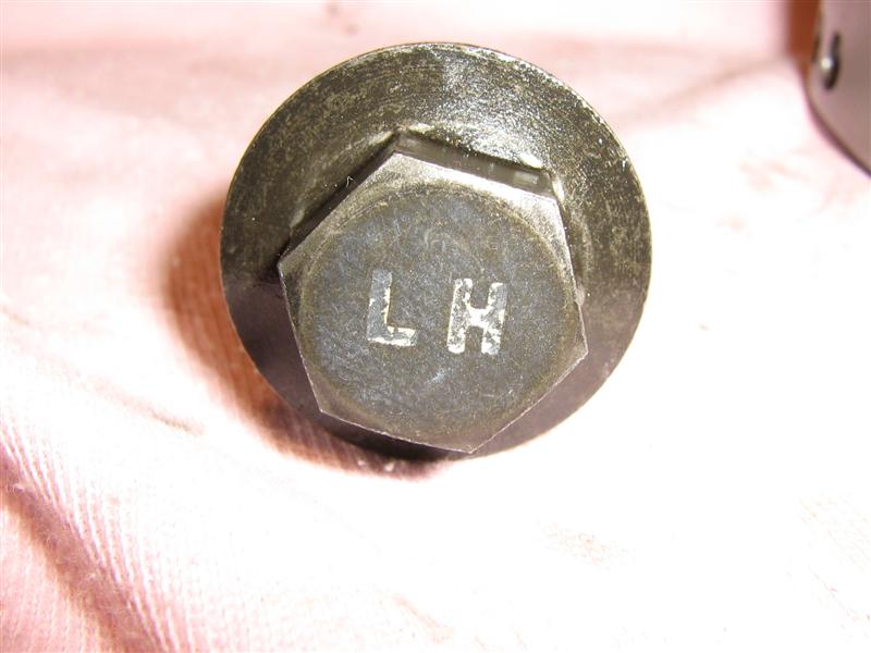

The starter clutch is on the left side behind the alternator rotor. Be carefull the, the screw holding the rotor has a left hand or counter clock wise threat. You have to turn screw clock wise to loosen it!!!
