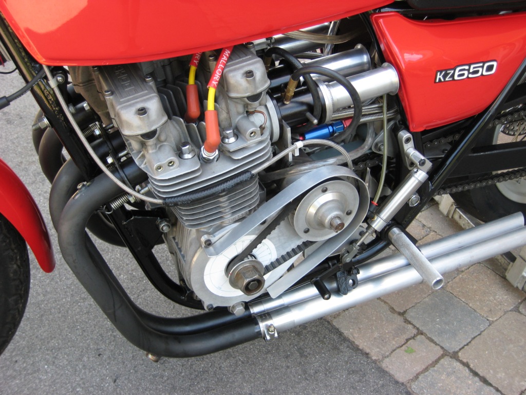

07 Apr 2022 04:47 - 07 Apr 2022 05:22If your talking about my drag bike I do not have a normal 650 head on it.So I have both a Kerker 4-1 for a 650 and a 1000. I understand the primaries are larger, but beyond the initial fab work required and the torque moving up in the RPMs what are the drawbacks to fitting this to my 810 kitted 650?
before any one starts howling too much, this has already been fork swapped and monoshocked and everything else, just trying to get some insight. There was a guy on here that had done it to his drag bike 650 and this is slowly becoming one.
thanks,
Brandon
I did put some 1000 pipes on it only because I drastically up scaled everything else. If this bike is any way street driven you will not need it even with a 810 kit. Like others on here have suggested your going to loose performance especially at lower RPMs. Drag bike work at wide open throttle all the time so they really do not need any back pressure, you need that on a street bike. Most drag bike engines idle at 2K, take off at 3-5K depending on which clutch you use, sometimes as high as 7K.
The head tubes on a 1000 hang down longer so the pipes need to be sectioned in the middle then rejoined - you can see that on the picture.
The 1000 head pipe tubes are 1.50" the flange where it contacts the head is 1.62" the collector placement on a 1000 is also different and that is very important. On the 650 the head pipe tubes are 1.38" and the flange where they touch the head is 1.56"
