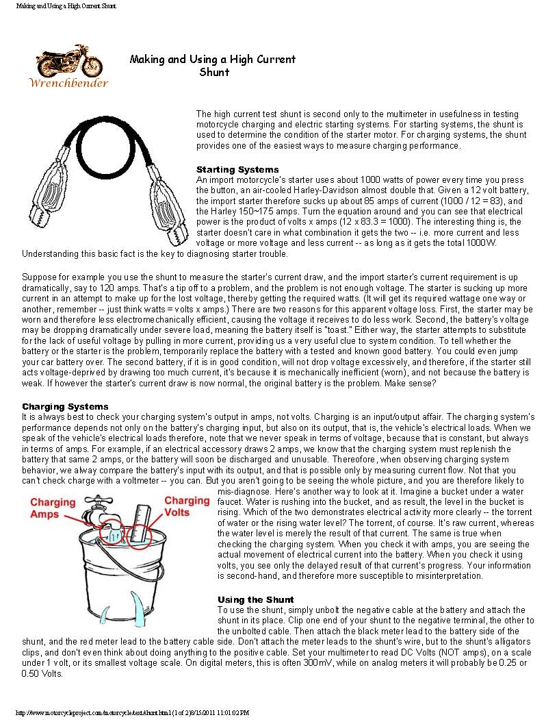

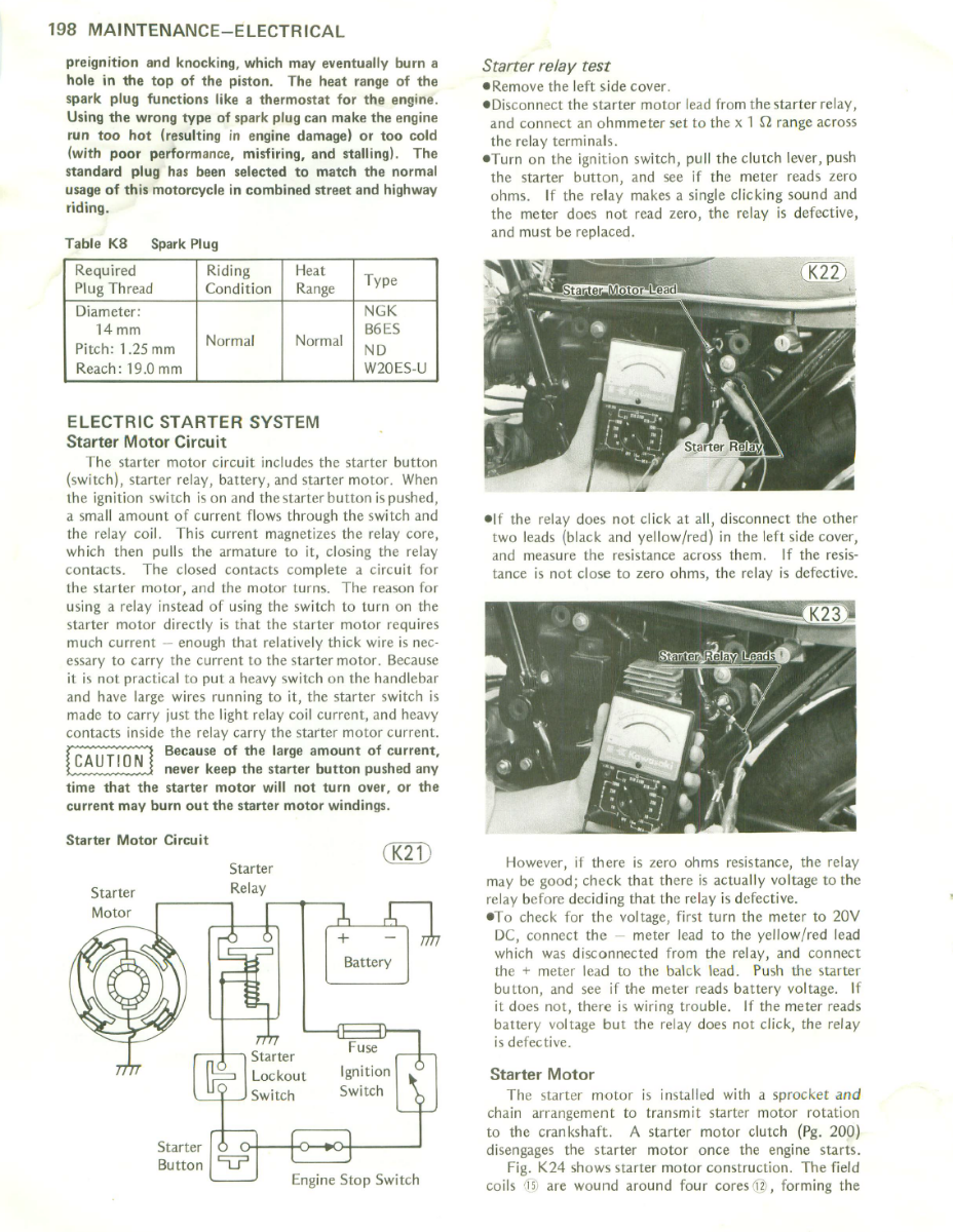

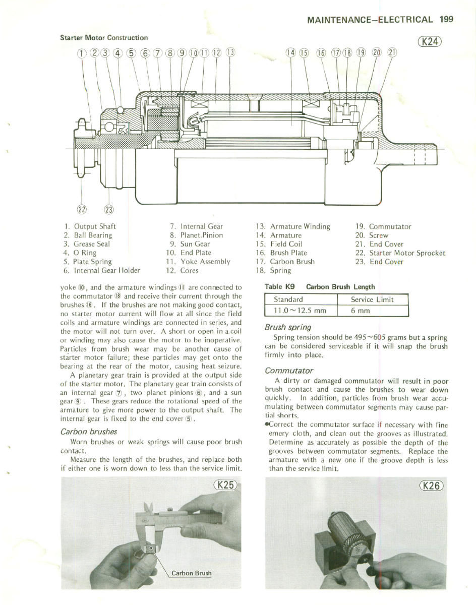

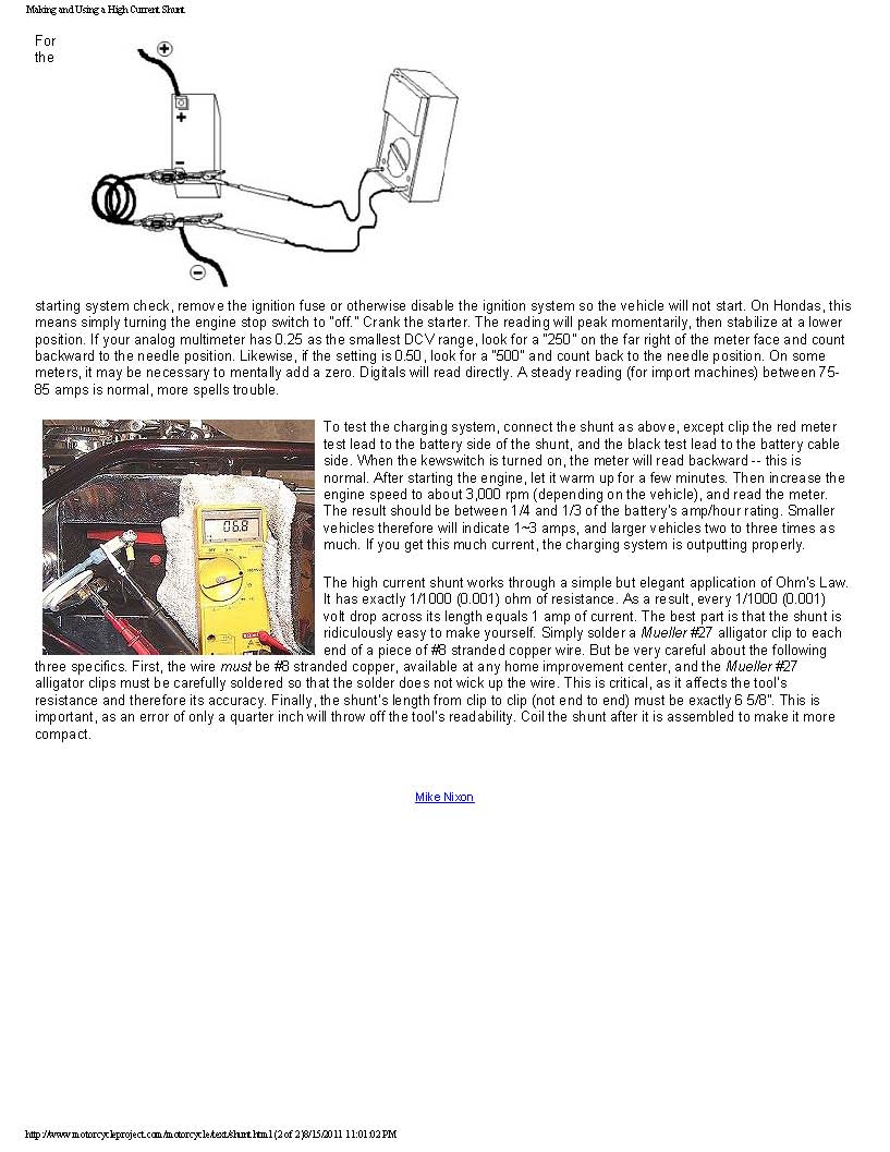

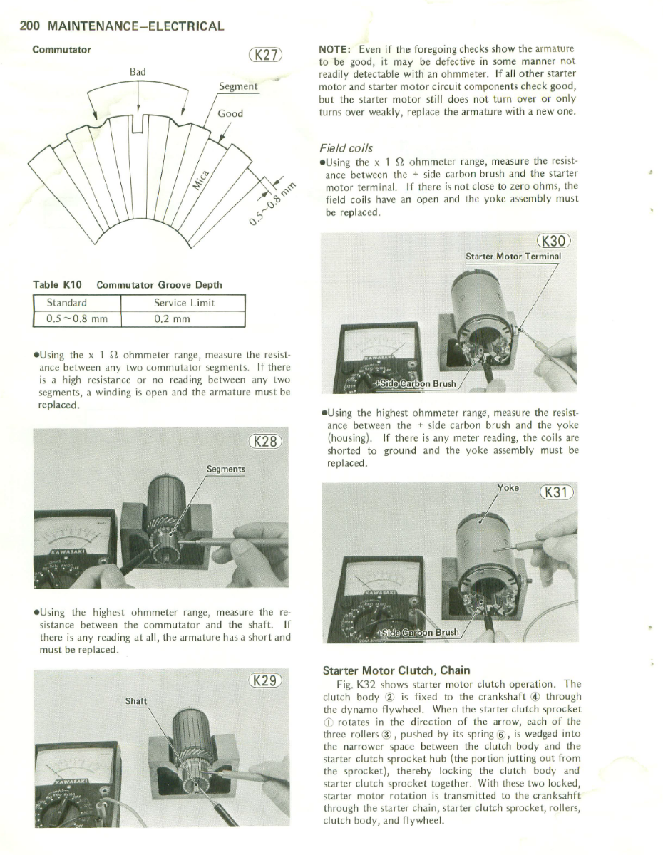

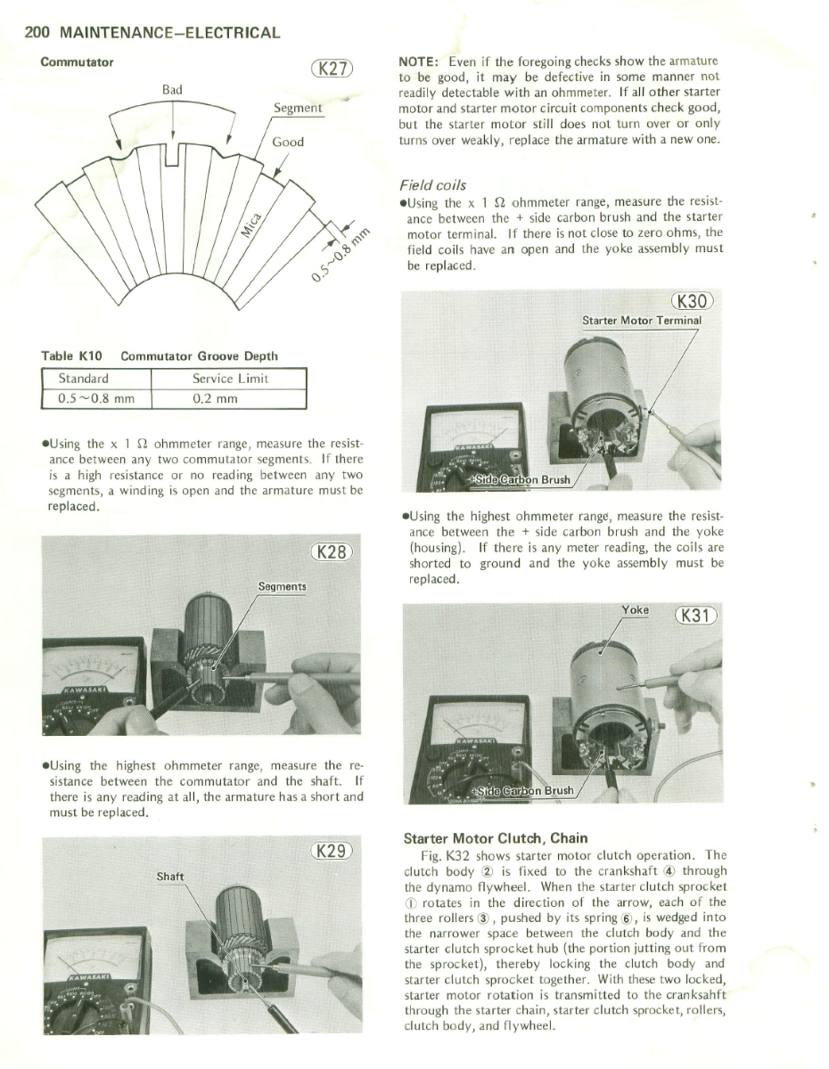

I agree you should do the tests in the manual in an attempt to find what is causing the issue. I would suggest making a high current shunt to assist in finding the issue. The attached are pages from welcome to the motorcycle project and I would give a line to the pages but it is currently being revised and  not active.  I copied them down in the past and here they are
