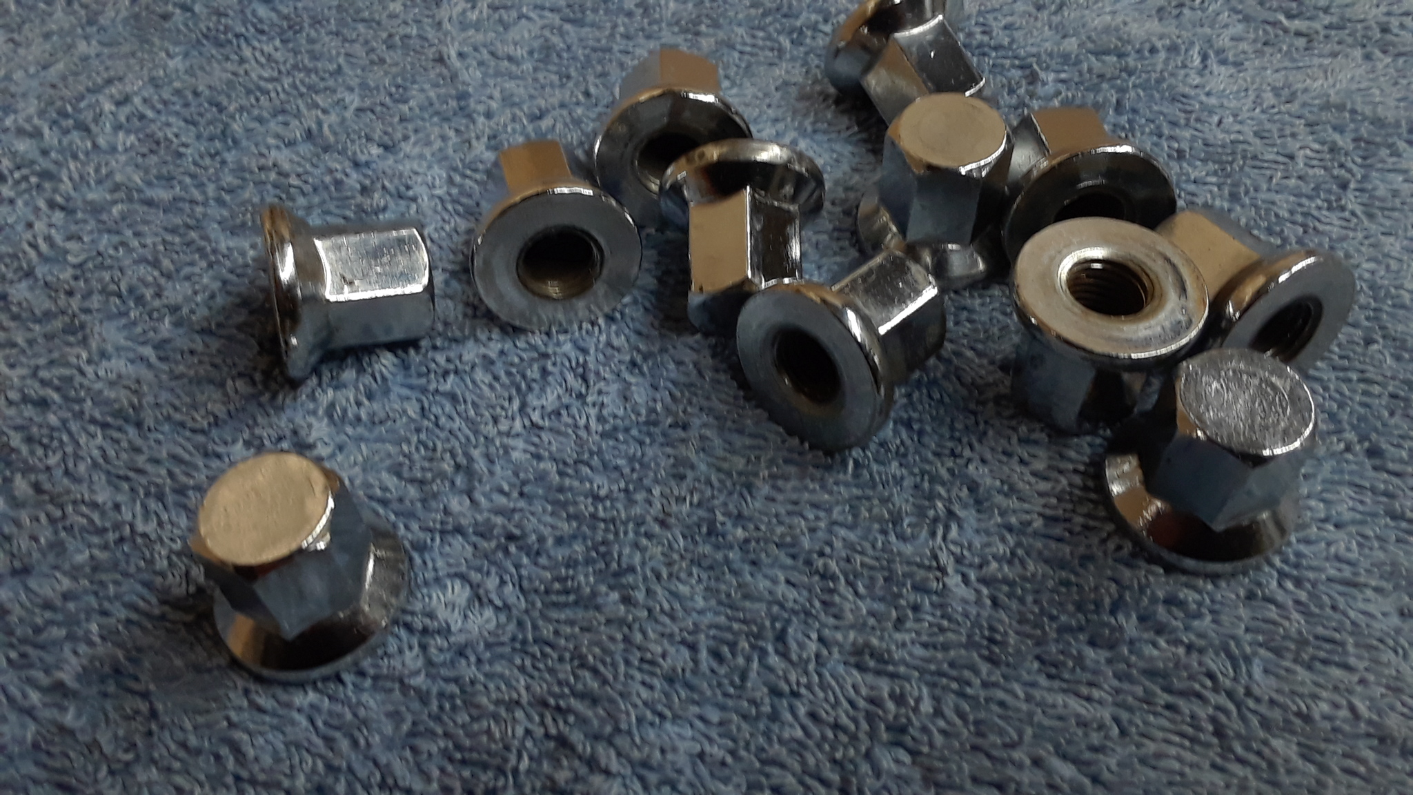

I've reached the top end of my rebuild of a '78 KZ1000 LTD, and the head nuts—which are chromed—are pitted and ugly, which I didn't really notice before the rest of the engine was all clean and pretty. Replacement sets from Z1 Enterprises and other sources are pretty dear, whereas ATV lug nuts of the same size and thread are relatively cheap. I'm worried that, since the lugnuts are machined to seat inside the holes on wheels, they won't have a big enough mating surface against the washers on the head. Should I bite the bullet and pay a hundred bucks (!) for 12 nuts, go ahead and use a set of lugnuts, or perhaps does anyone know a source for 10mx1.25 high-domed nuts for a reasonable price?

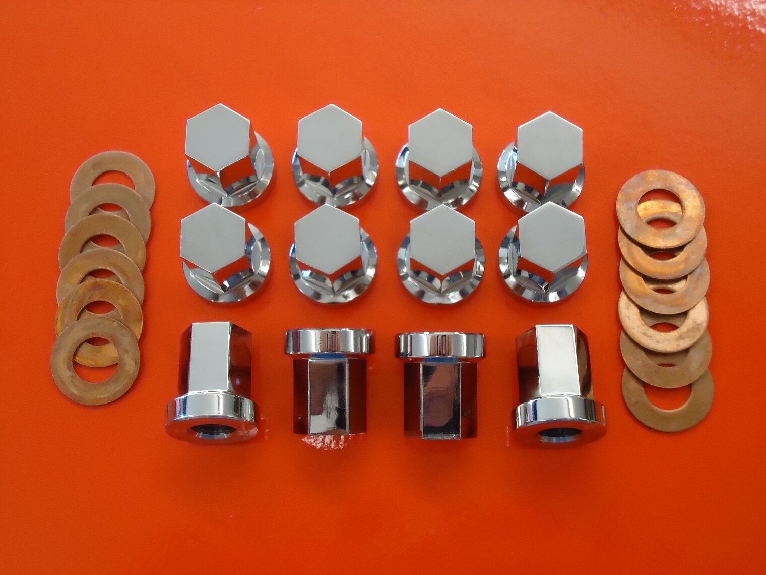

Some stainless steel head nuts.
classicbikefasteners.co.uk/collections/a...washer-set-92015-076

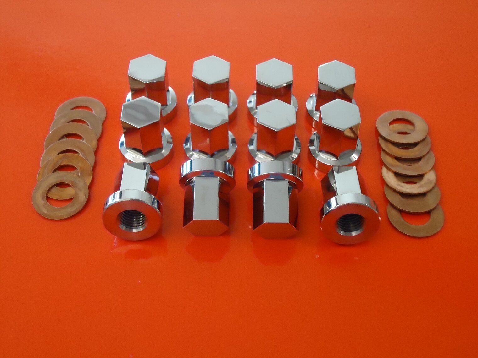

If i was you, i would bite the bullet. They are also available in early Z1 head nut style.
This set is 20 British Pounds cheaper.
www.legendmotorcycles.com/

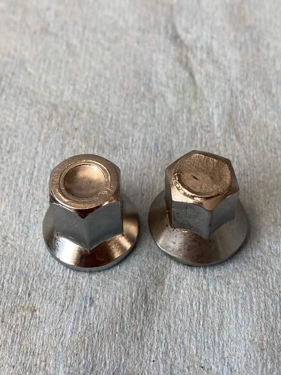

At some point I bought a set, but somehow I've acquired a couple of sets of originals that I returned to past condition. The photo below shows one new one (OEM) on the left and one old one (OEM) on the right. There are a couple of visible differences. Look at the top of them. The shearing process is different. Now look at the body. The overall length is the same but the shoulder section on the new one doesn't rise as far up as the old one.
