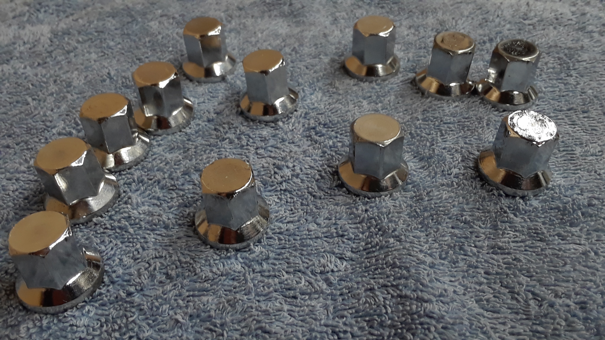

I'm using some stock ones I bought from eBay. With what I had I came up with a decent set. I;ll get the good ones when I can but for now they work great.

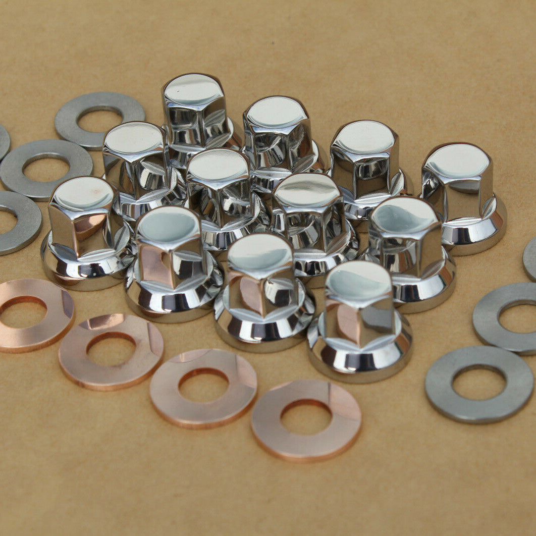

Some stainless steel head nuts.
classicbikefasteners.co.uk/collections/a...washer-set-92015-076
w w w.ebay.co.uk/itm/392235329121

Those are like friggin' jewelry! I'll search for something similar stateside, as I suspect 85 quid plus international shipping would add up to a whole bunch of USD.
Seems like everybody's confirming my suspicions about lug nuts being a bad idea—the price tag almost got me to convince myself otherwise.
So...anybody got some "pocket change" to spare?

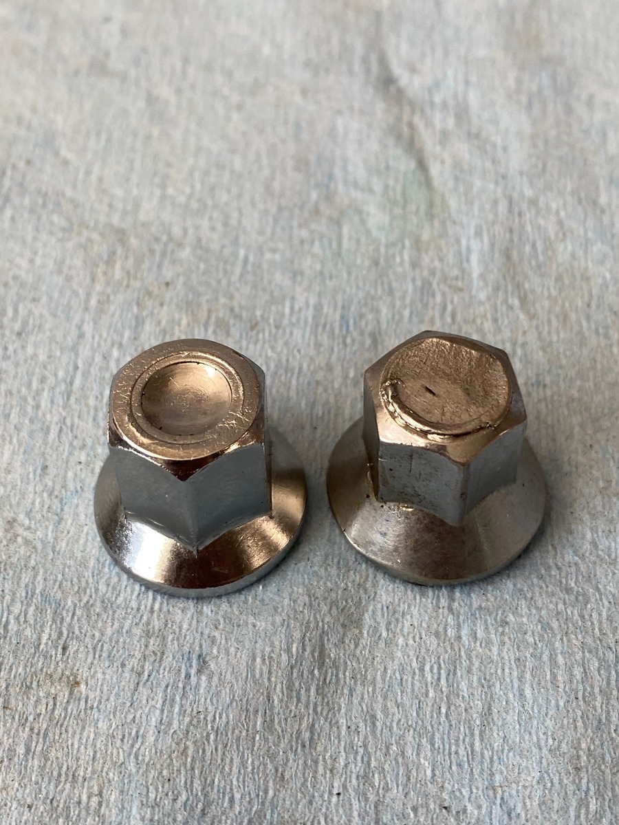

The head stud nuts are usually made from stainless steel...high nickel content. They can almost always be cleaned up with a wire brush enough to look presentable. Look around on ebay for a set that look to be in decent shape if your own are too badly corroded. If you're anal about having originals...there is a difference in new ones compared to old ones. Check the way they are severed on the top nowadays compared to originals.

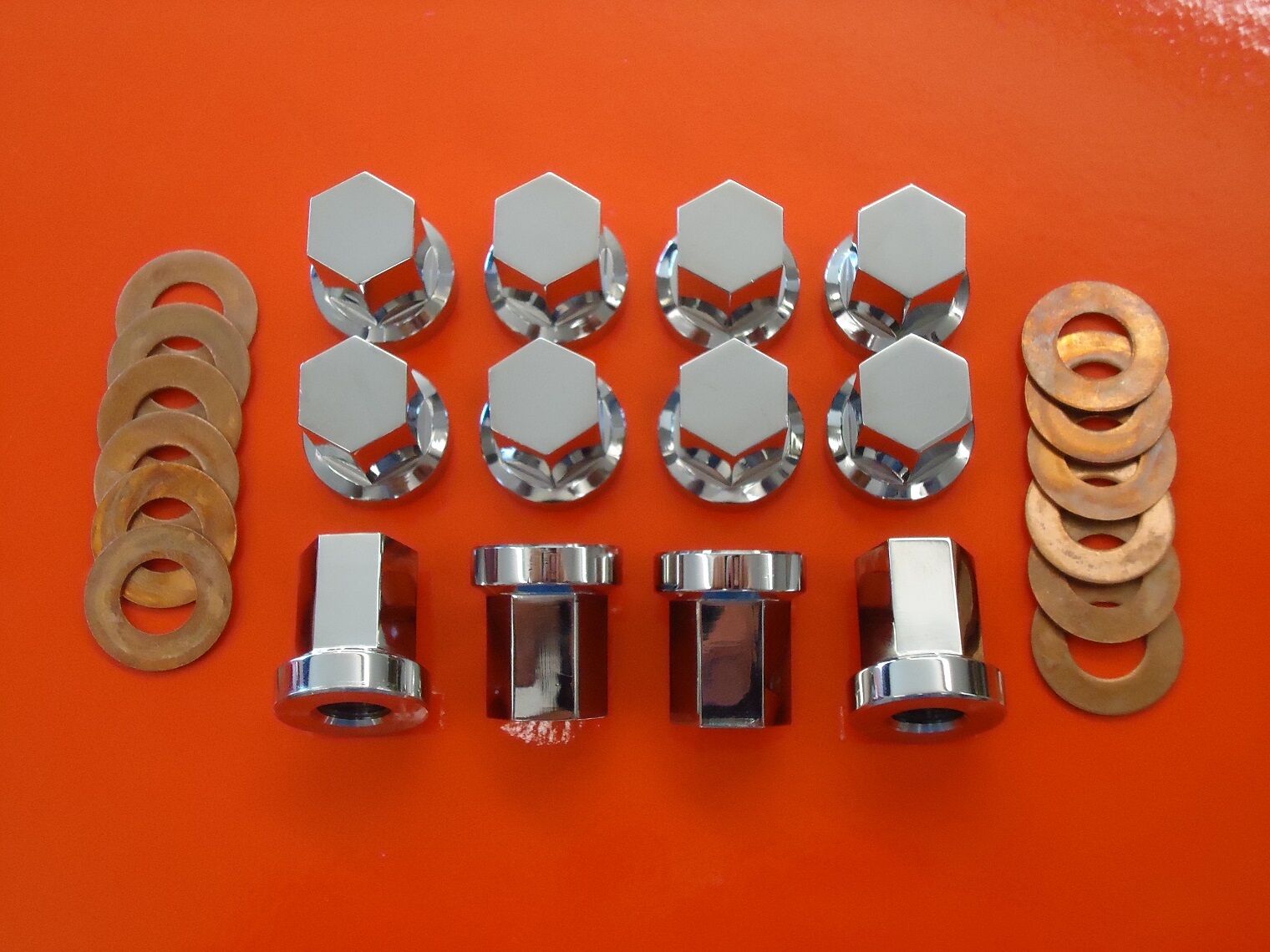

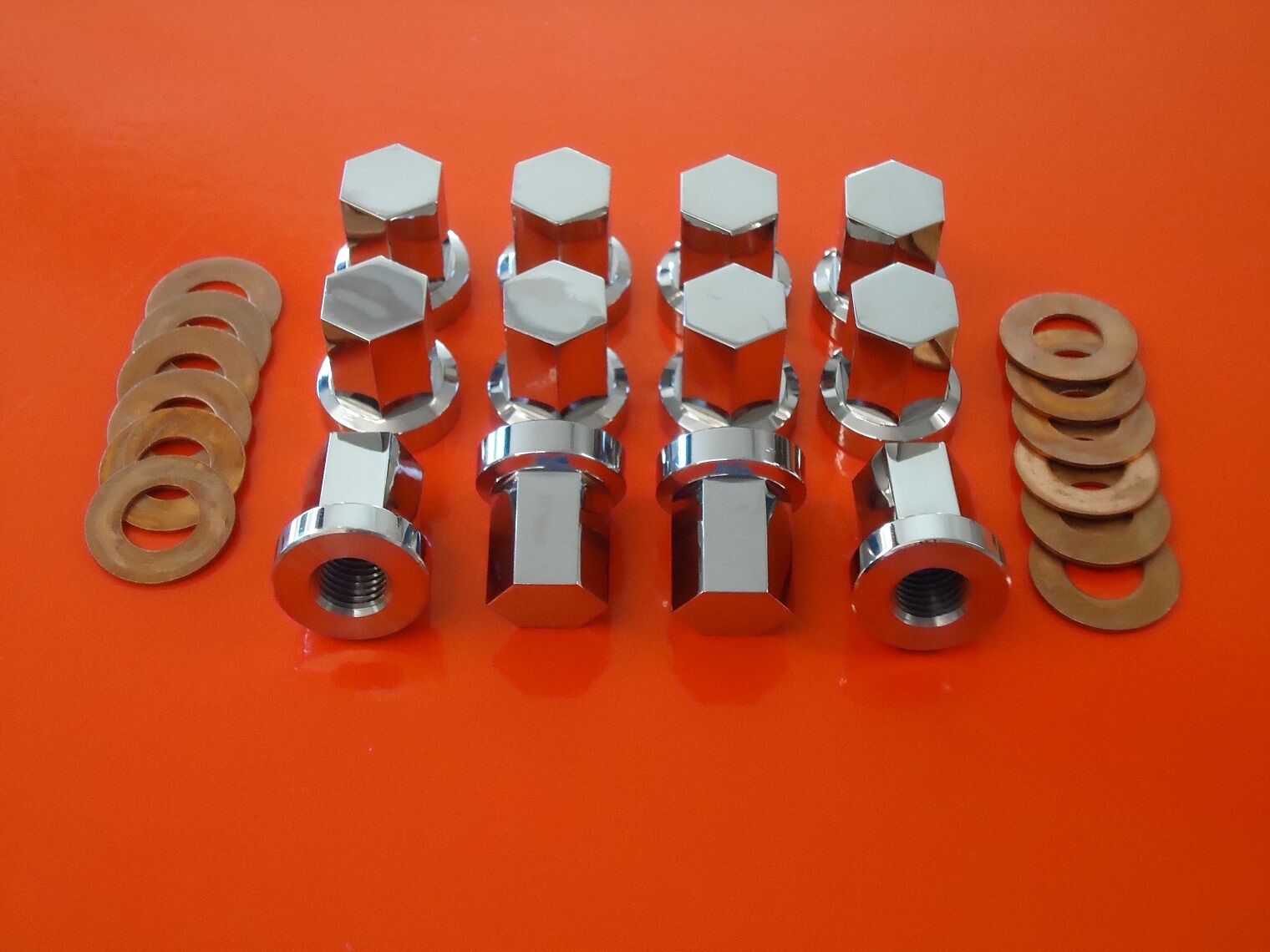

If i was you, i would bite the bullet. They are also available in early Z1 head nut style.
This set is 20 British Pounds cheaper.
www.legendmotorcycles.com/
w w w.ebay.co.uk/itm/114286618817?hash=item1a9c0368c1:g:m-wAAOSwLt5e8hEi

At some point I bought a set, but somehow I've acquired a couple of sets of originals that I returned to past condition. The photo below shows one new one (OEM) on the left and one old one (OEM) on the right. There are a couple of visible differences. Look at the top of them. The shearing process is different. Now look at the body. The overall length is the same but the shoulder section on the new one doesn't rise as far up as the old one.
