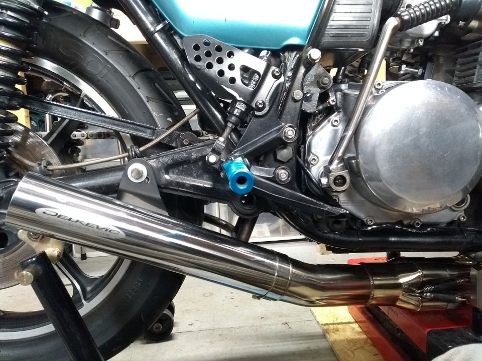

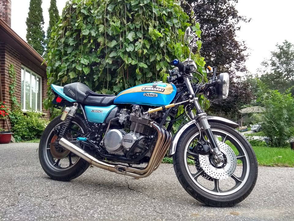

Have a Delkevic exhaust on my 650.
I don't find it too loud, and others have never mentioned it's too loud.
Baffle is in.
I've never had a stock exhaust on my 650, so maybe I'm imune to the noise.
I did come from an open Yosh pipe to a Kerker with baffle, then the Delkevic.
I don't have a center stand, had to remove it to fit the braced swingarm.
Spools were fitted to the swingarm, so use a rear stand.

Beautiful bike rstnick... looks like you made a lot of changes throughout the pictures. That you kept the Delkevic all that time (even over the Kerker, which seems to be a favorite) is a pretty good endorsement.
