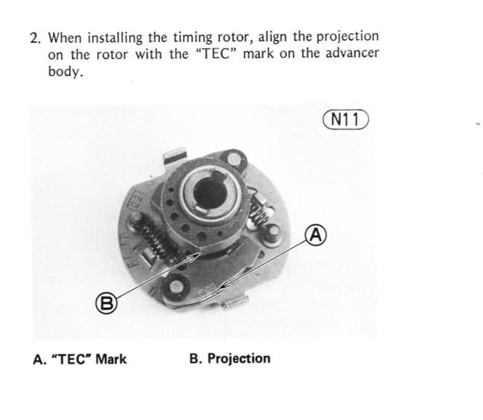

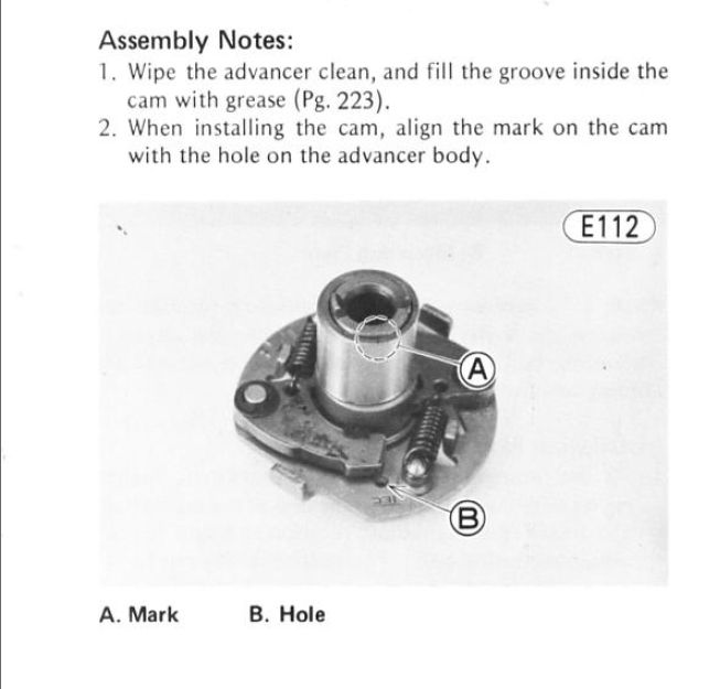

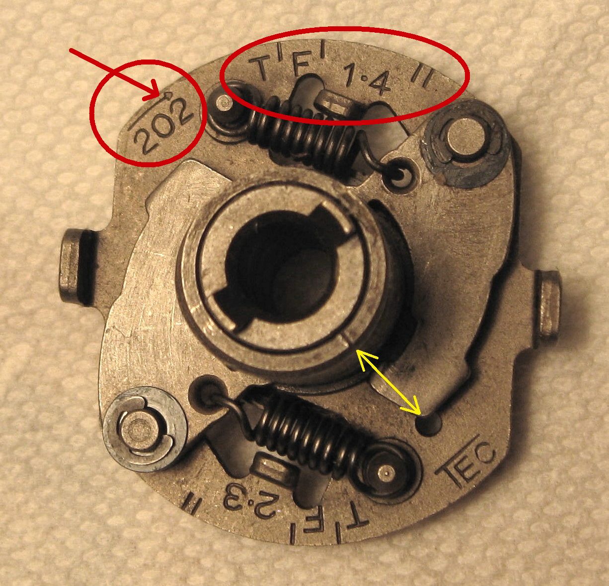

Are you sure your ignition advancer to point cam is align correct?
The cam lobe can be easy installed 180 degree off ignition timing after a rebuild.

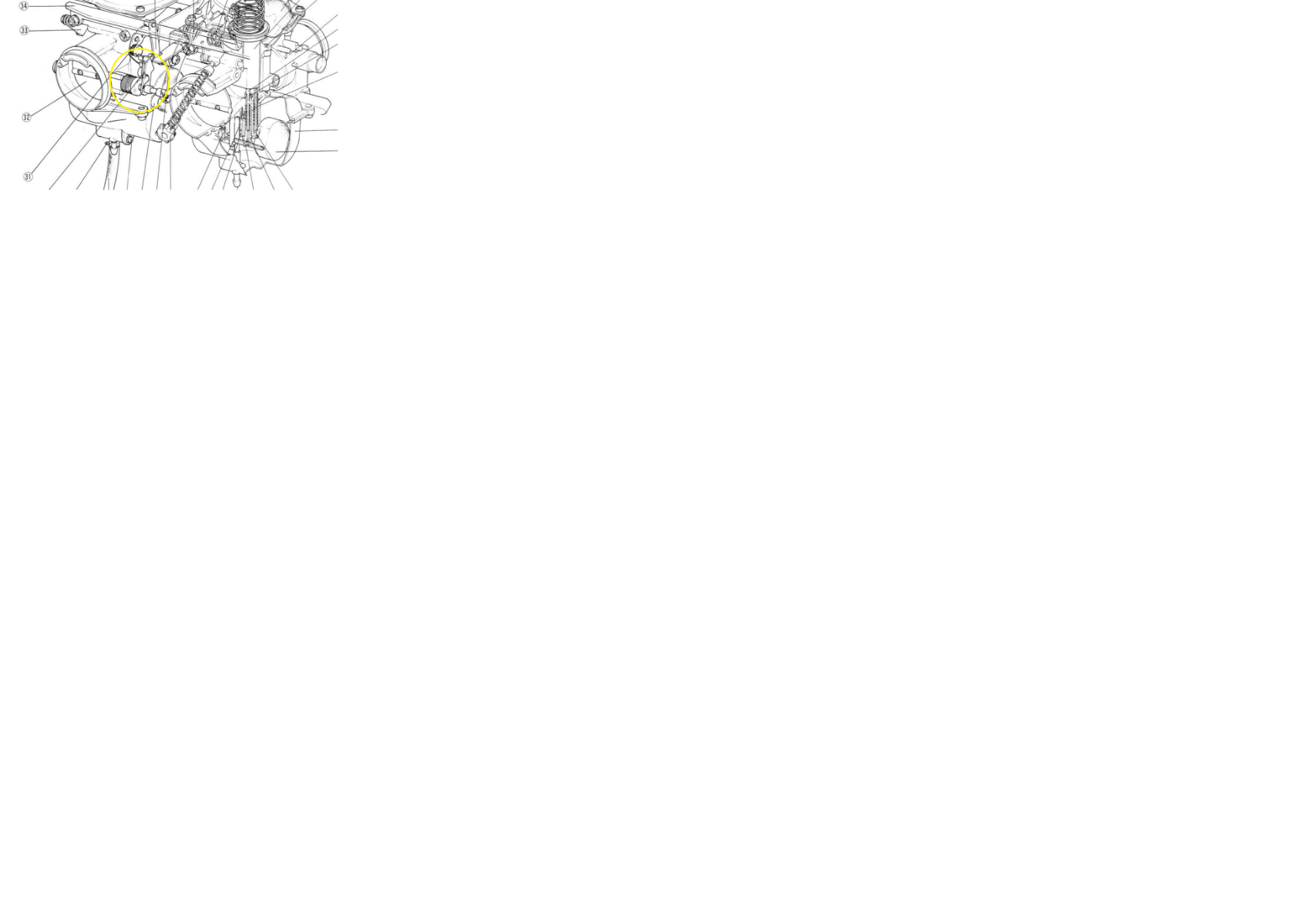

25 Feb 2022 10:01When I said spring I was referring to the yellow circled mechanism, you can see a wound-up spring there. In my case this is pretty loose and the right side choke plate is not held tightly. I can hear it flapping when I hit the start button. I can put my finger on the back of this spring and bike fires up easier.
BTW I still have the 1 cylinder running only issue. I can actually adjust the sync screw and change which cylinder runs. I removed the carbs and am doing more cleaning. I think the issue is still the idle circuit in the carbs.
