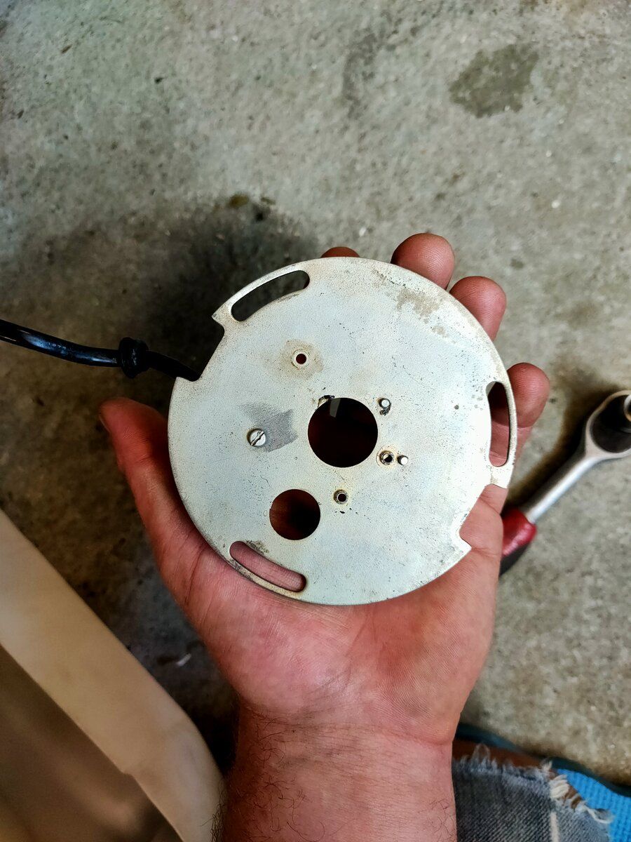

I was hoping you guys could give me some advice. I am really technical and know how to properly think, but don't have much experience with this. My next step would be to start changing ignition parts, (it now has a home made ignition with only one pick-up, and mechanical spark advance).

Ignition timing checked? Does your mechanical spark advancer moves free and is not stuck? Any pics of your home made ignition with only one pick-up would be interesting.

That has been just a few days. Before I took it apart, it had run on 3 and even once on 2 cilinders. Just a few minutes ago I started the bike to, and ran on 3 again...
PIcs of the ignition are attached!

I don’t know much about electricity, and I am completely befuddled by that ignition system. Looks to me like it fires both coils every 180 crank degrees.

Same here, think it does. It's a weird set-up. That's why I would prefer swapping it for a good ignition like a dyna or MSD..

Thinking about that ignition as well, It would be a waste of time and money to have te bike tuned up with a possible faulty ignition.

03 Oct 2021 09:54That has been just a few days. Before I took it apart, it had run on 3 and even once on 2 cilinders. Just a few minutes ago I started the bike to, and ran on 3 again...
Looks to me the bike would be firing on all cylinders fighting itself on all strokes. I don't see how it could run at all if it's hooked up to just the coils.

I expected it to fire every stroke, but hoe can it be fighting itself, when there is no gas in it the other stroke? Or are those remains? Maybe oil burning?
Just wondering, because I understand the way you think, but not how it's possible..
